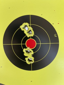

Trying to trouble shoot a new rifle build and hoping the good folks here can give me some useful feedback.
Build:
TS Custom barreled action: 28 Nosler
Lone Peak Fuzion Action
Benchmark barrel: 29" MTU
MDT ACC Chassis - Long Action
Fat Bastard brake
Ammo: 190gr Berbger LR Hybrid Target (Custom reloads Dallas)
for background, TS Custom built the barrel action and I purchased the MDT Chassis directly from MDT and dropped in the barreled action.
The issue I'm having is the POI will randomly shift 1"-2" at 100 yards from shot to shot. The pictures below is representative of what's happening, you see the first 2 rounds next to each other (bottom 2), followed by the next two rounds up about 1.5".

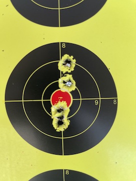

Same thing happens on nearly every target, like the one below: first 1 down, then 1 up, 1 down, 1 up. The POI shift seems to be in a 2 MOA range, and it has been consistently happening over the first 100 rounds fired.
I checked the action screws and they were tight at 60 lbs, the muzzle brake was not loose and the scope mount & rings were also tight. But if everything is tight how can the POI shift so much between shots?
I also spoke with Travis at TS Customs and Chad at Custom Reloads Dallas and they both said the chassis may need bedding. I thought bedding a chassis may prevent POI shifting over time, but would it help with what's happening here where the POI is shifting 2 MOA from shot to shot?
Look forward to everyone's feedback in terms of what the problem may be and any troubleshooting ideas you have are greatly appreciated.
Thanks
Art

With rifle on a bipod and both action screws torqued to spec, loosen the front one (leave the rear tight). If the action moves or “lifts up” in the chassis, there is tension on the receiver and it should be bedded.
Fwiw I’ve seen this happen with a number of MDT chassis - ACC, HNT, LSS, and XRS.

I've saw several mdt chassis that needed rear tang bedded. There was a fulcrum created by inlet, right in front of rear screw. Generally when you checked for action stress, and front screw was loosened, barrel would move up 3/16+". Generally better to test with barrel pointing up, maybe 80°. A long, heavy barrel might mask any movement if it's on the horizontal plane during test.
Thats a lot of movement if caused by bedding, I'm betting optic or mount. Might pull brake off and test without it.
I see that vertical pattern with an unstable front rest or inconsistent recoil management in particular with magnum calibers.
The bullet is still in the bore when the rifle recoils. Some rifles like to free recoil straight back. Some like to be held down.
Try shooting from a solid front rest and pay particular attention to what the rifle is doing under recoil. Try different holds.

Could also be improper rear bag management. Larger recoiling rifles will certainly exploit any inconsistencies in our application of the fundamentals.
I'm going to respectfully disagree.
A rifle that's "between nodes" is not going to have that large of discrepancy in POI shifts at 100 yards.
I just went to the basement to see if I saved my targets from the past couple of weeks, unfortunately I didn't, but I'm going to keep looking. I had a 6XC doing doubles. I just changed jugs of powder, from the same lot (so I didn't think anything of it), and it started doubling (.75" to 1" apart). I was certain that my NF scope or something was askew and went down the rabbit hole of swapping scopes, checking base screws, and re-testing. I ended up dropping almost 1 grain of powder off the charge and it's back to a .25" group @ 100.

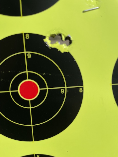

AA909, was wondering if you figured out any more information on the POI?
I am having a similar issue with really bad groups for a 300prc in a MDT Chassis with a Proof prefit.
I reached out to Proof and after sending the barrel back to them, they verified that the issue is not the barrel.
Which leads me to believe that the chassis might be the cause. I reached out to MDT but they responded by saying their chassis does not need to be bedded.

Alright, finally had a chance to go back out to the range this morning . Let me first say thank you for everyone's feedback, it's much appreciated and I incorporated your feedback in my session today (e.g. focusing on rear bag control, loading the bipod, grip pressure etc).
Recap of troubleshooting:
- Removed and reinstalled chassis ensuring proper torque sequence and specs.
- Reinstalled scope and confirmed torque specs on the mount / rings.
- Removed muzzle brake (reinstalled at range after shooting a few groups w/o brake).
- Ammo, Berger 184gr, 190gr & 195gr Hybrid match ammo
Results below are after a couple of cold bore shots, followed by 5 rounds without the brake to ensure I'm not getting any fliers.
Here is the first 3-shot group with everything reinstalled including muzzle brake (190gr Berger):
As you can see the POI is waaaaaaaaaaaaaay off from the original zero but the group is tight (0.5 MOA @ 100 yards).
This is the first 3 shot group after zeroing the scope again (0.5 MOA at 100 Yards): 195gr Berger
As you can see in the first picture the POI was off vs where it was originally zero'd. In my experience the POI shouldn't have moved by 2.5" up and 2.5" right from simply reinstalling the chassis and reinstalling the scope mount (I never removed the scope from the mount, I only removed the mount from the action and reinstalled). I can only assume There must have been some tension in the chassis from the original install, but appreciate hearing your thoughts.
After zeroing the scope I went out to 600 yards today and was hitting 1 Moa targets pretty consistently. I definitely had a few shanked shots, however I would attribute those to human error, especially since the groups at 100 yards were tight.
