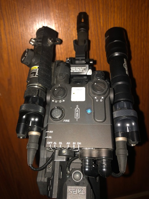

Here, this might help you out. I run Luna ELIR-3 slaved to Dbal A3's. It will way outperform a MAWL in every category and situation. I can afford a MAWL, but would not waste my money on it because it is way overpriced and way under delivers in some very important categories. IMHO. Others mileage may vary.
I also have the Modlite 850 IR head and can easily run it also. It is a very nice and strong illuminator but throws out a pretty substantial visible glow (to a human naked eye) and is a much wider (area type) beam than a Luna ELIR-3.
I like having instant access to WL on my rifles, so a dual IR/IR laser/light is out for me... which is why I MAWL.

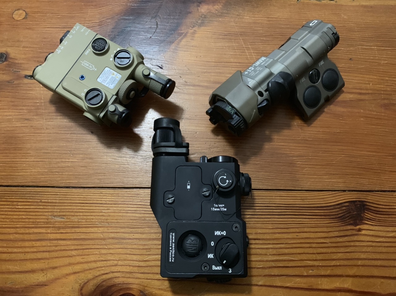

The D2 and Perst (have both) are the only other options. Prefer the Perst3 or Perst2 over the D2.

I too value the ability to have instant white light and additionally a Vis Green Point simultaneously and instantly with that white light if I want it.
So the Dbal A3 with its unique Overide Function is one of the few MFLAM/LAM to offer that ability. The MAWL cannot do this. You have to reach up and rotate the Propeller.
With my setup below I can instantly with one push of a button do the following.
1. IR Illumination from 0 to 90 mW power via Luna ELIR slaved to a 0.7 mW IR Pointer which provides excellent contrast between the IR Point and the IR Illuminate such that you do not get into some of the "washout" situations you can get into when the MAWL Illuminator overpowers and washs out the IR Point.
OR
2. White Light via Modlight OKW (69,000 Candela) head and Vis Green Point.
The ability to seamlessly (with one push of a button) go from strong IR operation to strong white light without having to change any settings on your gear makes for a good setup.
The Steiner D2 is close to the mawl in performance, though huge.
I use a Steiner OTAl and a Surefire Vampire on a Unity tactical TAPS switch and find the outcome to be very acceptable.
If they could shrink down the D2 to an acceptable size, I'd be all over it. That thing just looks like a brick sitting on top of the rail.

@WhereNow&How when you push the “fire” button on the DBAL A3, does it activate with tape switches plugged in?
In other words, if I had a similar setup where I planned to use the Modlite IR 850 head and A3 Laser for high output on a tape switch such as Unity TAPS Sync, could I press the fire button on the A3 unit to activate just the IR laser & IR Illum for a lower output option?
(I guess that’s what one of the buttons on the Sync would be for anyway, unless I use that for the vis override port...hopefully I’m understanding the switchology correctly there)
Thanks all for the dialog here, definitely some things I’ll take into consideration
Yes, no matter if you have both A3 remote sockets filled with tape switch's when you hit the onboard top fire button it activates exactly as it should in the mode you have selected on the A3 rotatory selection switch.
You are correct. If you have the A3 rotary switch set to low hitting the fire button on top will activate that setting.
Hook your Taps Sync up to the A3 port and Modlite IR 850 and when you hit that button you will have strong illuminator and whatever power IR point you had selected. Then if you want White Light and Vis Green Point at same time just put a White Light Weapon Light on your rig and hook up Taps Sync second switch to the White Light and also into your Overide Port on the A3.

The Dbal A3 is arguably the finest toughest most featured MFLAM produced to date. Especially the full power versions.
I dunno. I like the A3 and everything, but I’d put it behind both the MAWL and the Perst3.
A3 is definitely the smallest and lightest, though. To me, that’s a big plus. Aside from the anemic illuminator (not a big deal for me, as I’m mostly thermal now), my biggest gripe is the rail height. It feels like it towers above the rail, which I’m not a fan of.
@TheHorta
That is a civi Version A3 with a denutted illuminator in that photo.
A full power Dbal A3 will walk over the MAWL-C in IR spectrum and will hang pretty much what for what in the IR spectrum with the Perst 3 except the A3 has a wider beam spread on the illuminator when you need that. The Perst 3 is a pretty nice unit however. Id take it over a MAWL.
