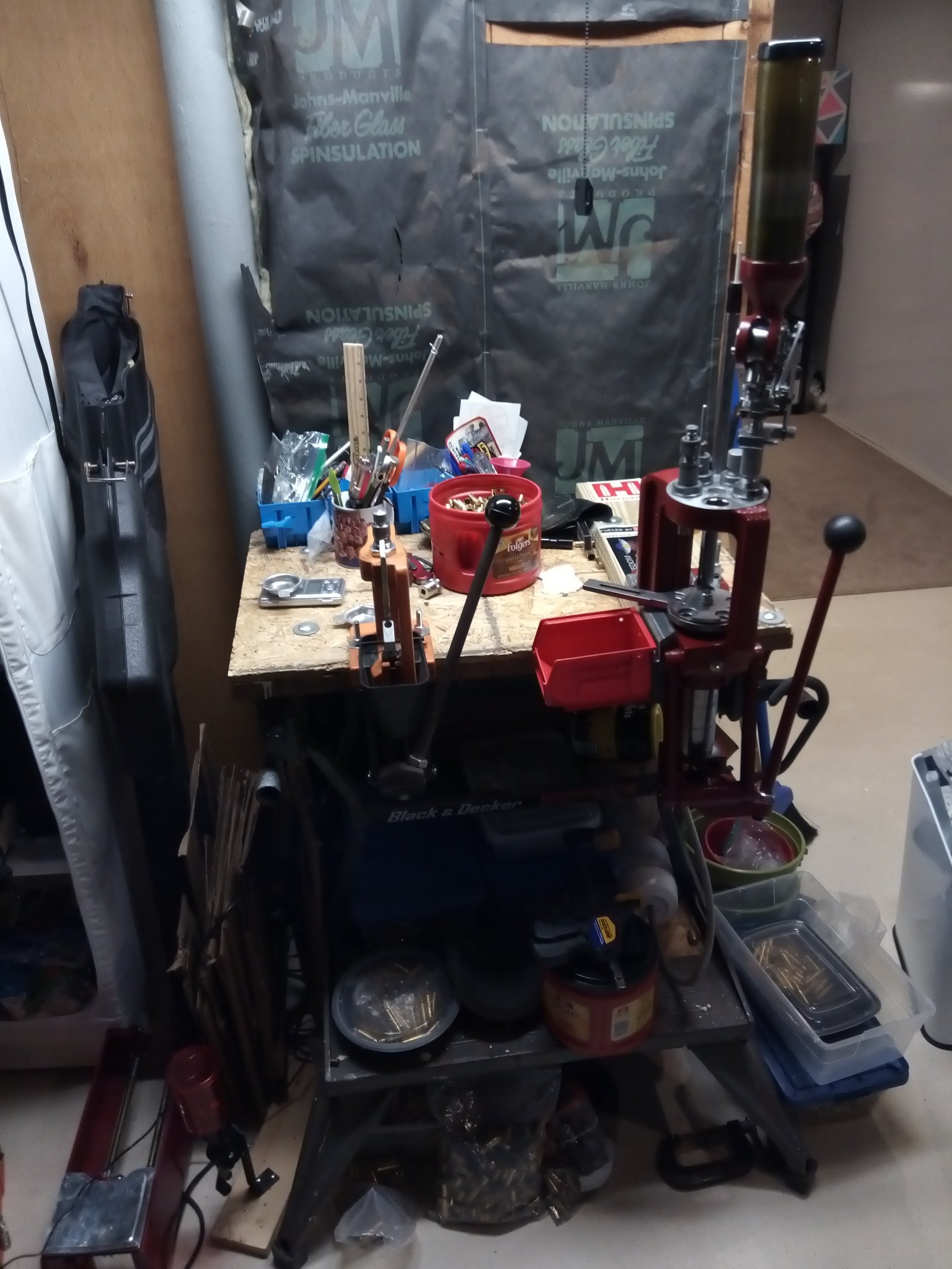

It's messy and crowded now because I was loading 9mm on the progressive and .308 on the single last week. I usually take the single press off if im not loading rifle ammo for a while.
Just take the presses off (and the random shit piled underneath) and it folds flat.

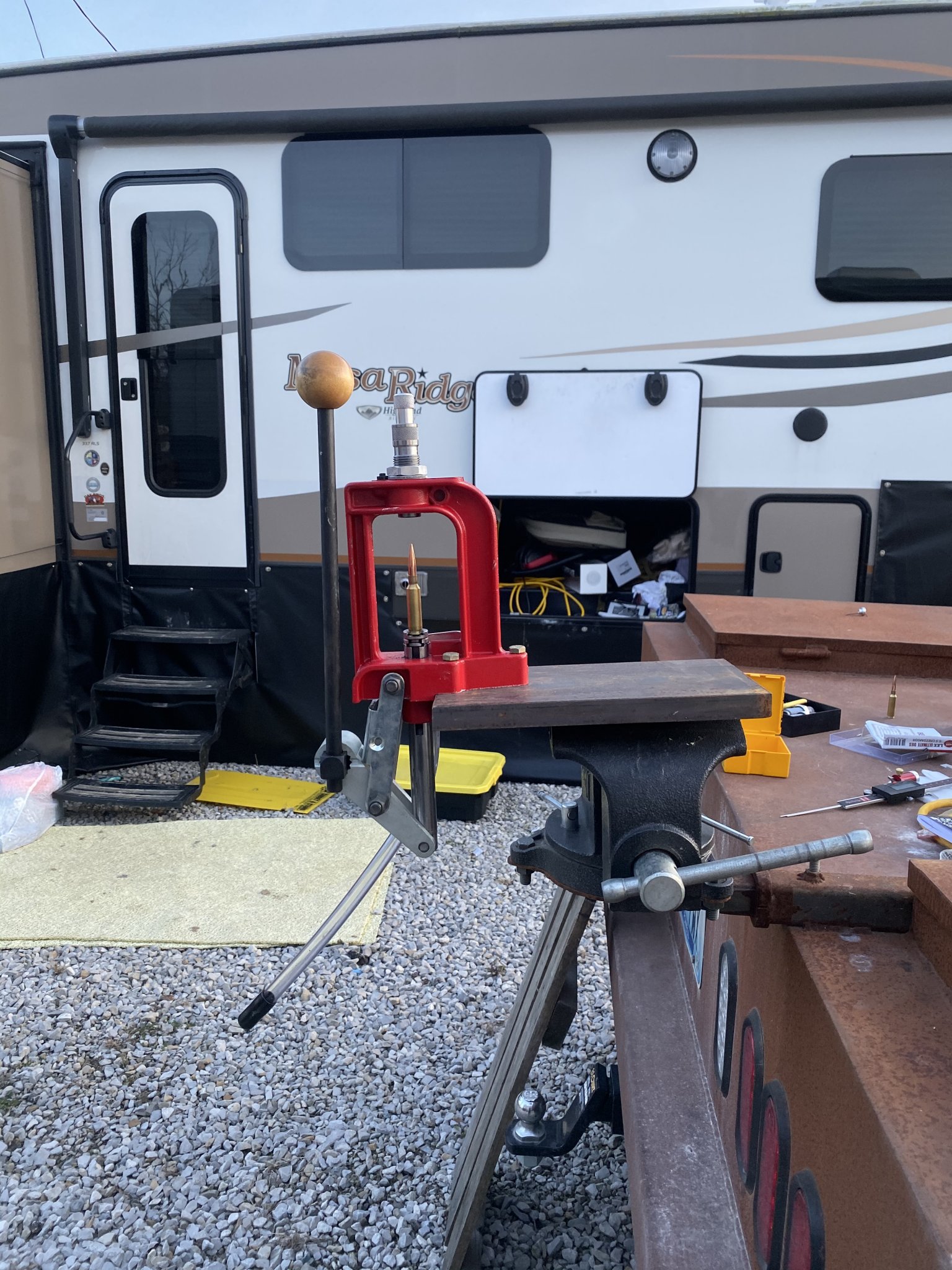

This what i did for when I’m traveling for work. I do all my trimming and powder measuring in my camper
