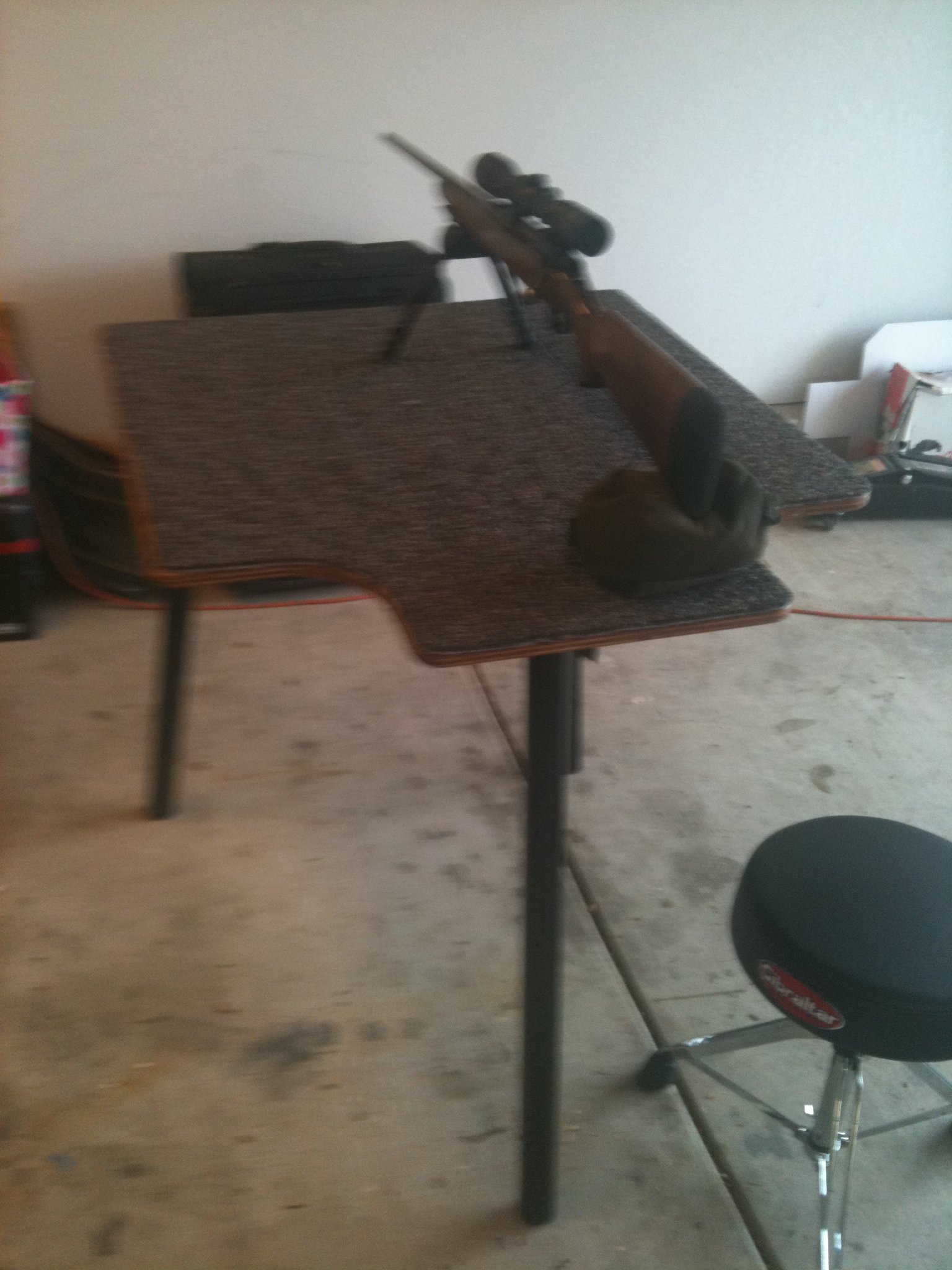

I love mine and take it every time I go shooting, even when I shoot at a range that has them already. I designed it for Left or right handed shooters and my son welded it up. Three legs so it doesn’t wobble. It has a carpeted top on 5/8” exterior plywood with a drummers seat. I just mounted a piece of wood across it (adjustable) so I can put a better load on the bipod. I shopped around and didn’t find one that best meets my needs unless I spent a ton of money.
We also shoot prone but my old body likes shooting from the bench better.

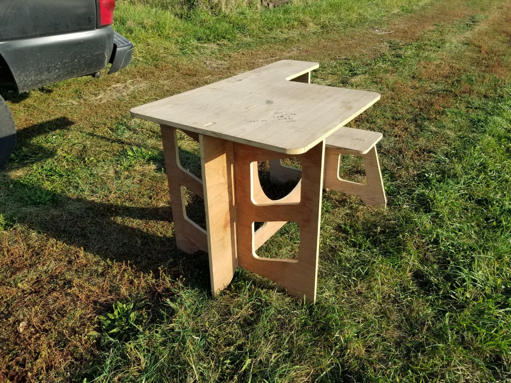

Any plans for the one you made, sir? The links are $600-$1,000 which is above my budget so if the Herter's commercial models do not fit the bill I may end up doing what you did and making one.
We make them out of a single sheet of 3/4" plywood.
5 piece design. Lay out the pieces off of the blueprint, use circular saw and jig saw
to cut out shapes.
Took about 3 hours or so. Works good. Easy to store and travel with.
Cost varies depending on what plywood used.. I chose oak veneer, was about $60 from
Menards.
