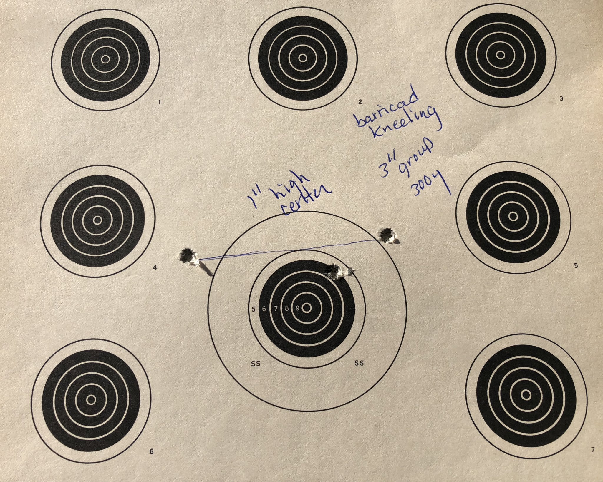

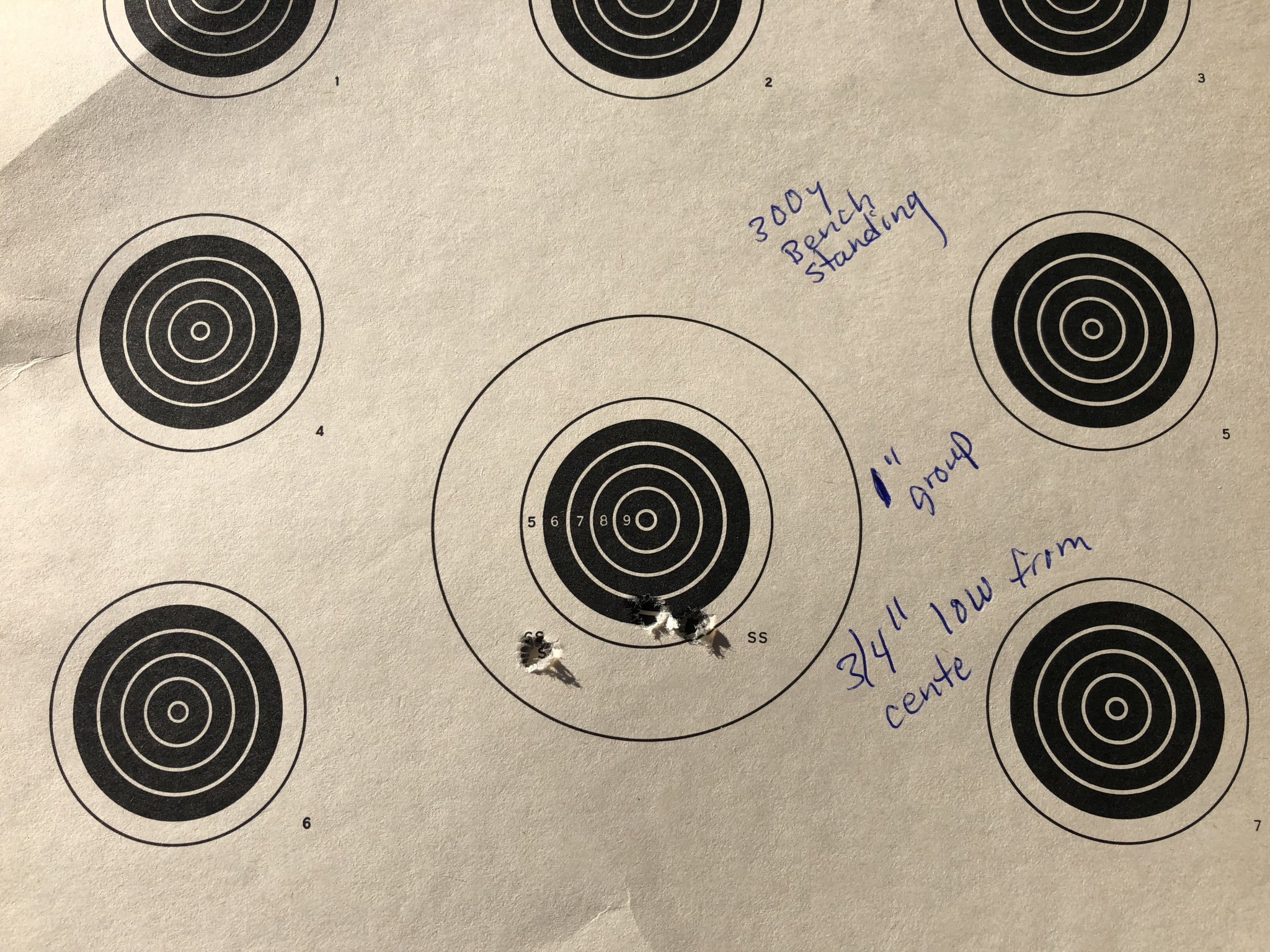

    I went to the range today to play with this theory a little bit. I shot my groups at 300 yards. Just figured the group sizes would be larger and easier to see. not sure if that makes a difference. Shot a group from prone and it ended up being 1 inch low of my point of aim. Shot a group from a bench at the same 300 yards and the group was the same 1 inch low of my point of aim. Then I shot a group kneeling from a PRS barricade and the group was 1 inch high of my point of aim. Thoughts?

    I "think" my fundamentals are strong, though I haven't taken one of your classes yet Frank. I line up straight behind the rifle, load the bipod, natural point of aim, etc. As far as the bench goes, I hate that benches are designed the way they are. I always stand behind the rifle at a bench so I can line up directly behind it. I lean my chest into the bench to help mitigate upper body movement.
    As for the barricade, that kind of doesn't fit in this test because it's kneeling, rifle balanced on a gamechanger. I still square up behind the rifle as much as possible, but my "wobble" is far greater because it's positional.
    Don't know if the group sizes help you guys or even matter in this, but I got a crazy lucky 1/4" group at 300y from prone. Typical 100 yard zero with my match rifle is 3/8" The group from the bench at 300y was 1 inch. The group from the barricade at 300y was 3 inches.

    youre 1" low prone/bench, and 1" high positional...thats ~2" at only 300

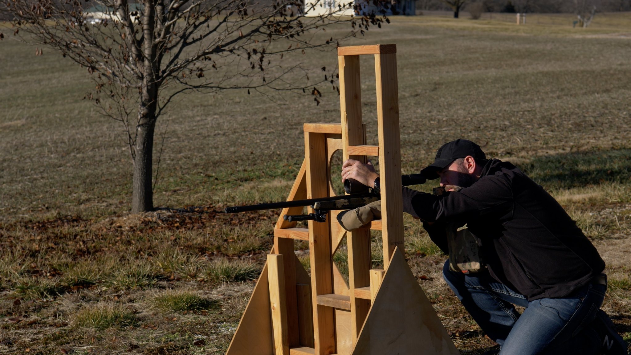

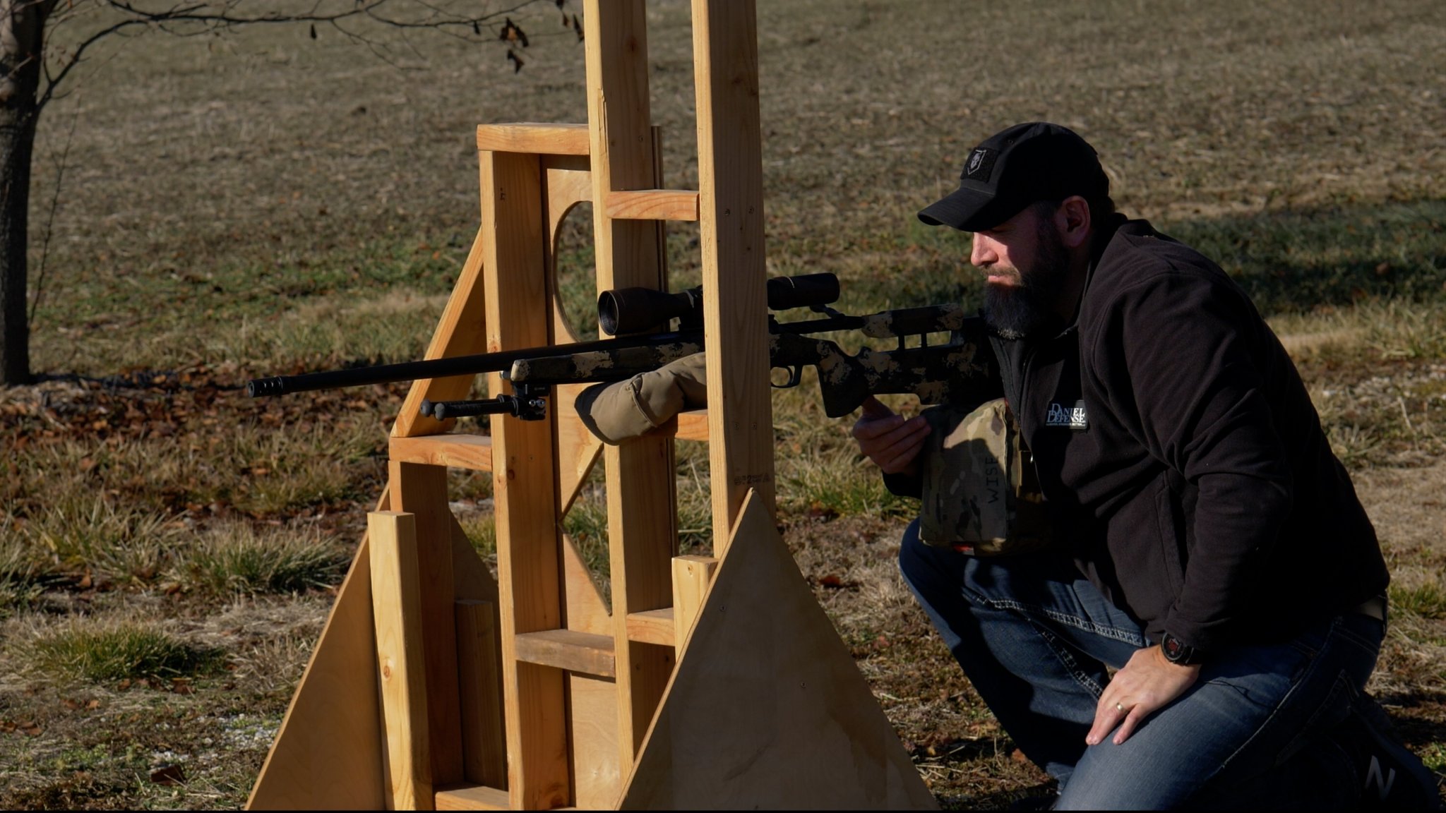

    Trying to square up behind the rifle. Wiebad pump pillow for rear support for gun and my upper body.

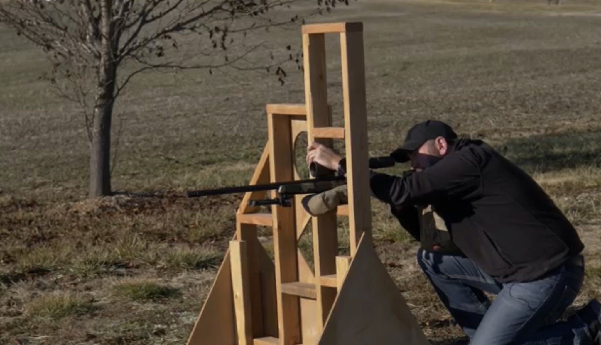

    In this discussion - we are trying to figure out why your 3 barricade shots were high, correct? Frank and Mo are telling you it's a recoil management issue which took half a page to warm up to. So the question now is - how to get most stable from a kneeling supported shot? After ditching the pump pillow, I wouldn't blame the bags in this instance- looks like the AG python bag up front?
    Picture one you mentioned getting square behind the rifle, whilst the picture shows you bladed off the side of the rifle. I think this could be part of your issue depending upon how the rifle recoils. This sort of yoga; bladed position can very well introduce some shooter english into the recoil impulse as it will exaggerate the butt stock dropping on recoil. I personally like to shoot a lot of kneeling supported with both knees down. Let your core and hips maintain your midsection square behind the rifle without leaning too far into it- then apply FOM as you did previously on the prone/ bench series.
    Reactions: Cjwise5
    You are correct, my initial question was to test and see what the opinions were on those high shots. I was mostly playing devil's advocate to draw out the conversation and get more detail. I agree it's a recoil management issue. The front bag is the pint sized gamechanger. It's filled with sand and is as heavy as the original larger gamechanger. I also agree that I ended up slightly bladed on the barricade shot. (Bad ankles, I needed to get comfortable) To me that would tend to push the rounds to the left and not necessarily higher. Yes? No?
    I'm also really curious about the rail systems like Ingenuity Gun Works. I wonder how that would change things in this scenario.
    Reactions: ROT
    Compared to your prone and bench you were much more than “slightly bladed.”
    While your body might be slightly bladed, you are off to the side of the rifle and not behind it. Perhaps shoot the barricade again and square up on it(may or may not be able to use the pump pillow). See if that brings your poi back to same.
    Also, unless you did quite a bit more testing and only put these three groups up, this is far from empirical.
    Thus far the only thing you’ve show is if you don’t get behind the rifle square, or manage recoil somehow, the muzzle is going to rise, thus rising the POI.

    Look at the angle of attack on his body in the Standing on the bench, vs the Kneeling, that is the answer, body position

    Frank, yes I agree about the photos. That's why I posted them, so you guys could critique. If I'm willing to do that then I'm willing to accept criticism. I wouldn't make all these videos for the Precision Rifle Network and put myself out there every single week if I wasn't. There are a couple dudes on this thread who seem to think I'm arguing with them when I'm not.
    I never disagreed with any of you on body position and recoil management. That was my personal assessment from the beginning. I just like to ask more questions to draw out all the possible answers.
    Frank, when you say my kneeling position was too tall, can you give me more detail please?
