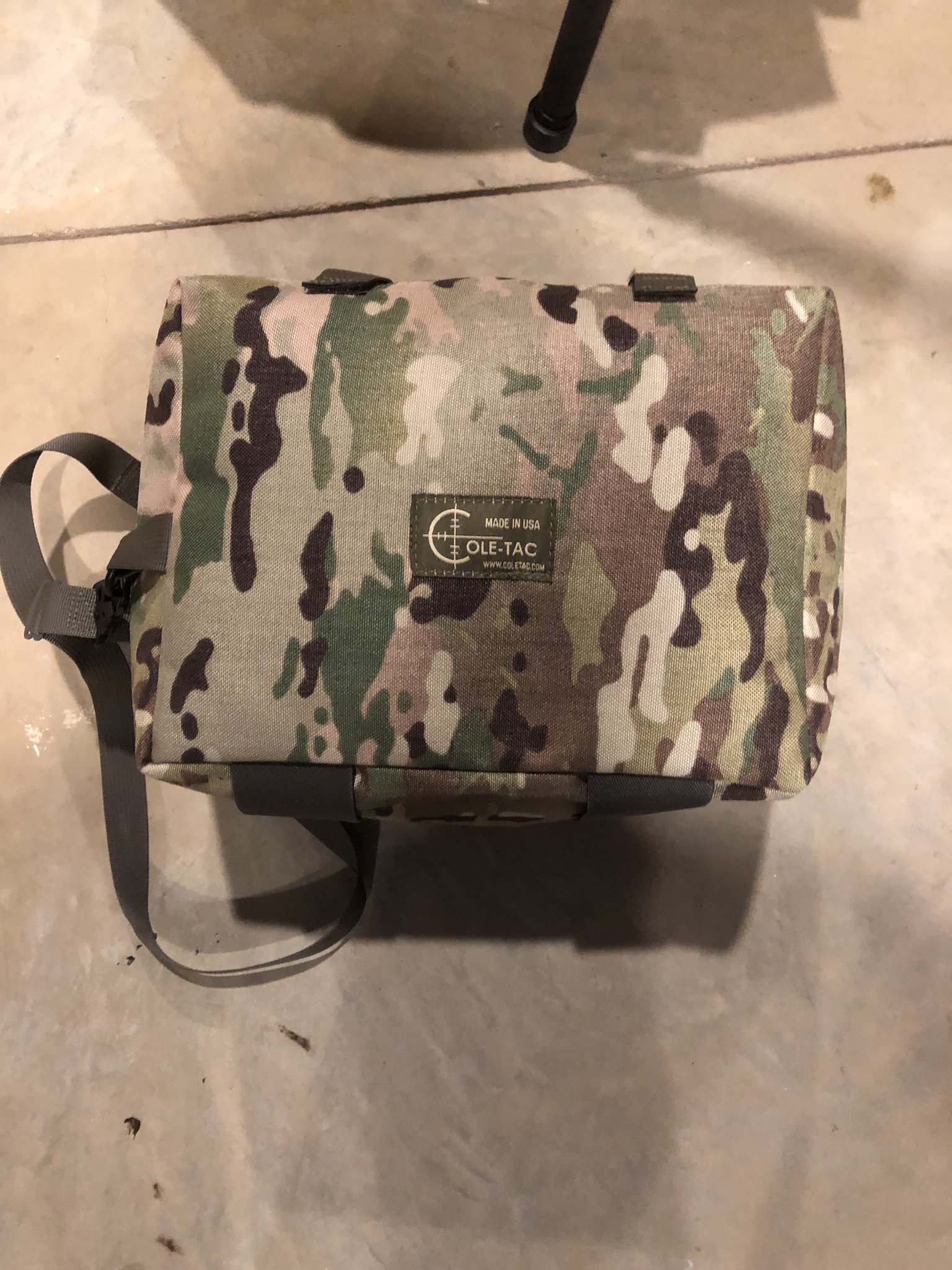

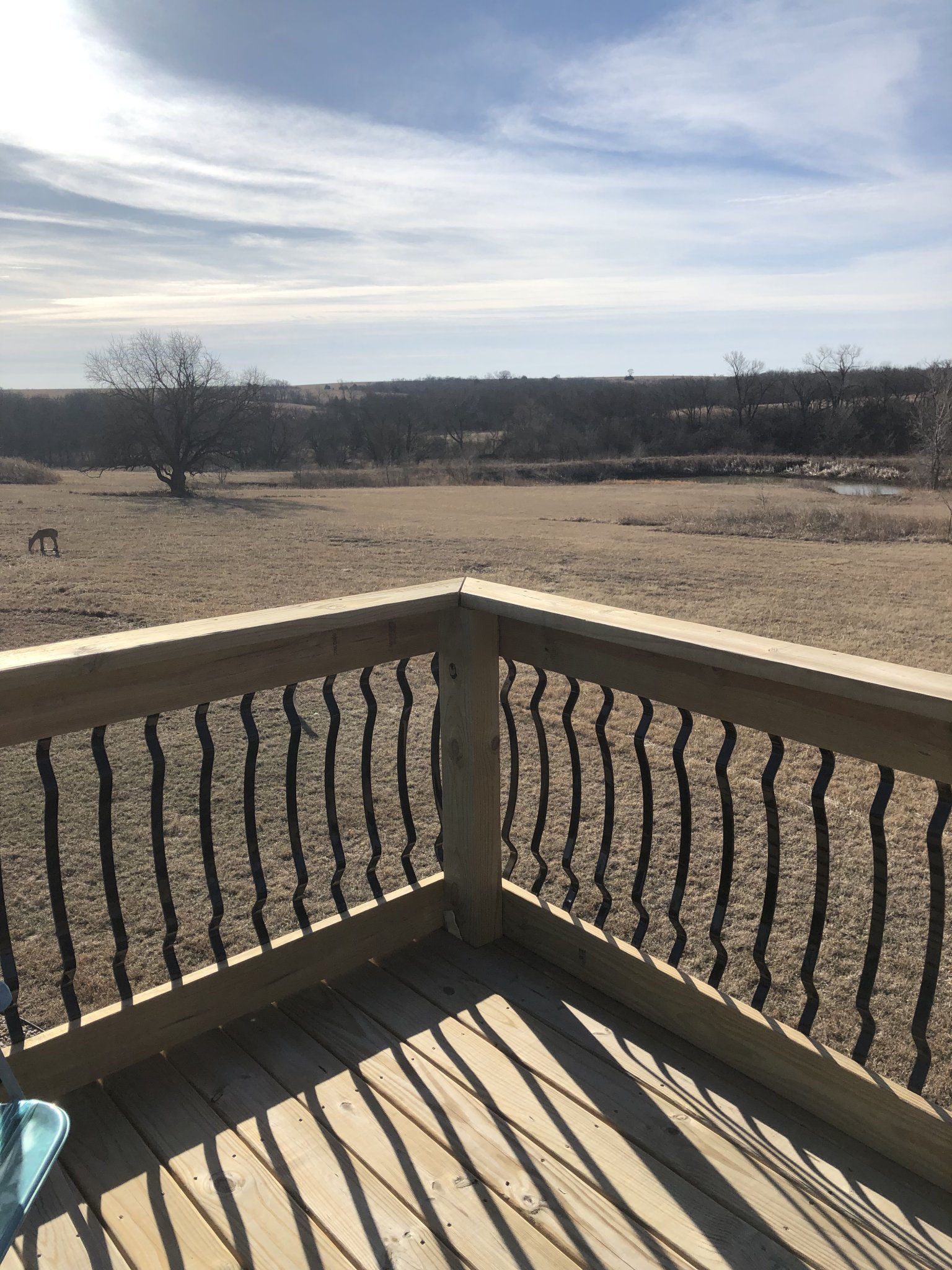

Shooting off my deck I’m having trouble with vertical movement.
I bought a cole-tac pillow to help but not stable enough.
Would like ideas on how to be as stable as possible. I have a tripod that I’m going to try under the butt. Have the RRS clamp.
Target is 444 yards off the corner.
Picture of how you do it would be helpful.

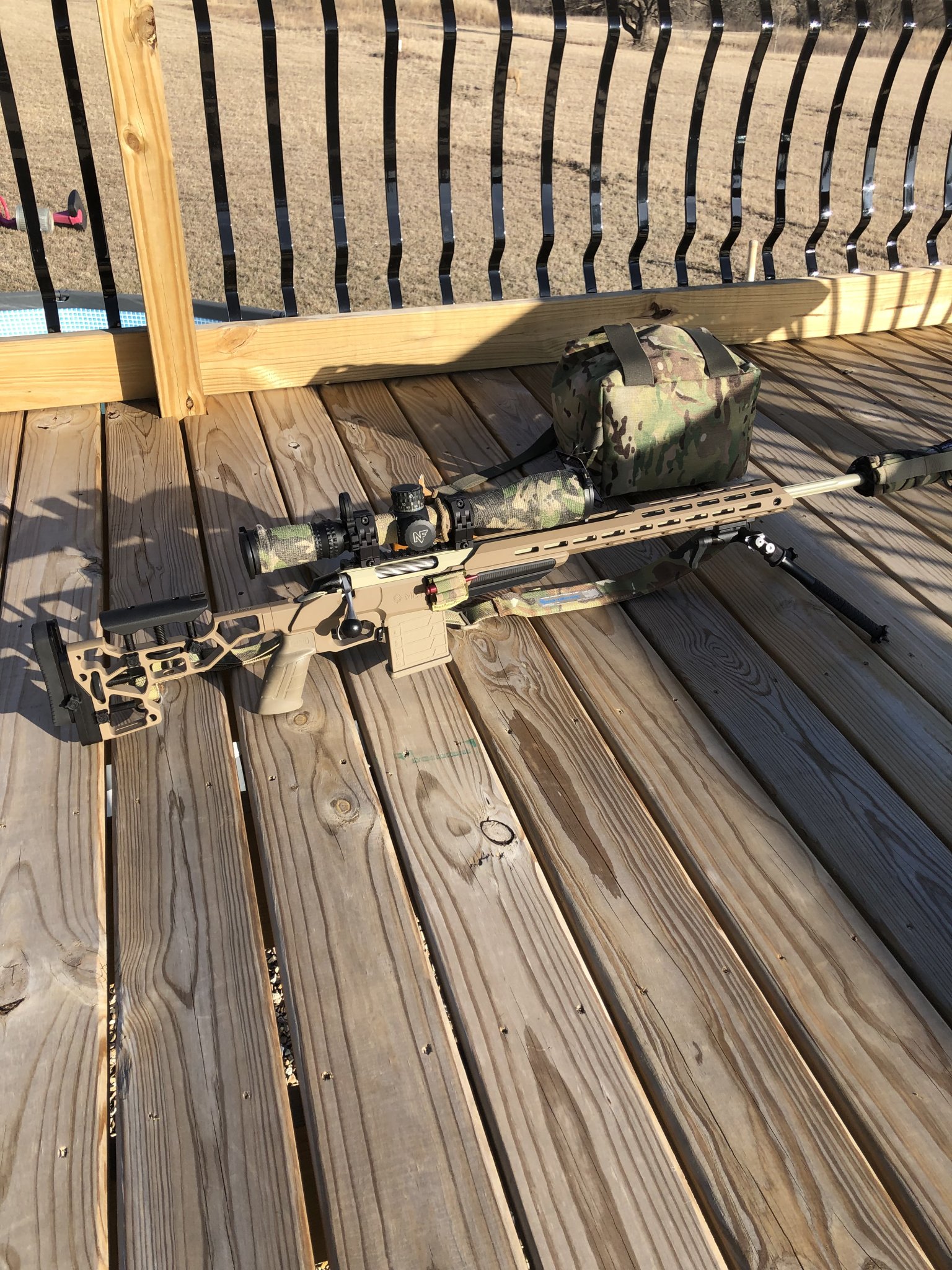

You trying to shoot using the bipod or juat the bag? In either case, you need a different bag. My preference is a Weibad Tater Tot with heavy fill. Can be used as a rear bag for tripod or for shooting off that railing.
Where are you shooting off of on the deck? Top railing? I'd use something more like a game changer on the railing and set the rifle on it and then just strong side knee up and larger bag there to stabilize the rear. If the railing is too high to get the knee to help then you can have the bag under your arm or use a tripod for rear support.
That chassis with that lump in front of the magazine might be an issue also with the rifle sitting on a bag but don't know unless you try.
I set the handgaurd on the rail . Bag under right arm.

You’re using no bag on the rail at all? Honestly, you can’t expect that to work well. If you have no bag in the front, you need a tripod in the rear.
Like rob or other have said - gamechanger, fortune cookie. or anything else similar in the rail at the balance point of the gun. You shouldn’t start with any other bag used/requires for filling voids on your body in the rear. (What that coltac is really for).
Look up a few youtube’s on position bag shooting. No offense intended here, but you’ve sort of got it all backwards. Video will be worth a thousand posts from us.

One other note - if at all possible don’t shoot your bipod in that forward position. put the legs wide before forward. In the forward position the legs and stop points can flex/bounce more than vertical.
Maybe it was just for the pic but thought i’d mention it just in case

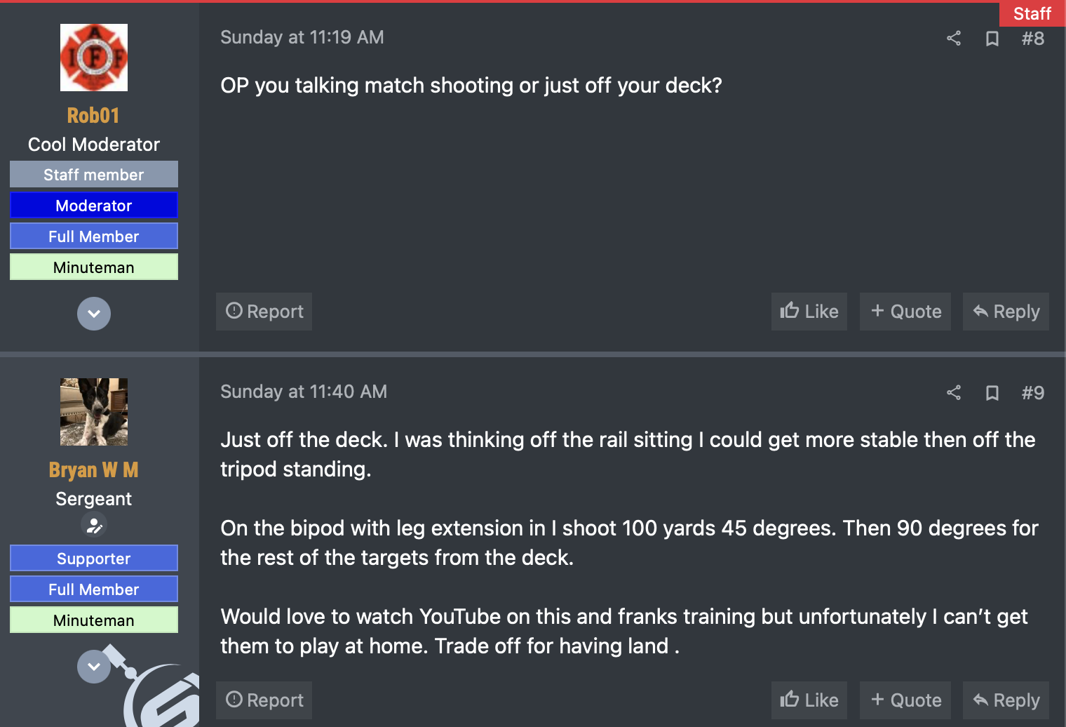

Just off the deck. I was thinking off the rail sitting I could get more stable then off the tripod standing.
On the bipod with leg extension in I shoot 100 yards 45 degrees. Then 90 degrees for the rest of the targets from the deck.
Would love to watch YouTube on this and franks training but unfortunately I can’t get them to play at home. Trade off for having land .
Then just get a good front bag that will sit on the railing and the rifle can sit on it and mold down into it for stability. Then use whatever works best for you in the rear to stabilize the rear of the rifle.
Use a bag on the railing and a tripod support in rear.
You could also use the bipod up front, but bag is easier.

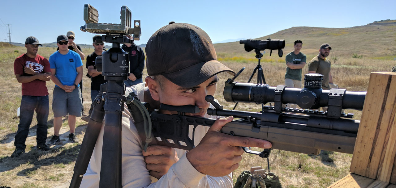

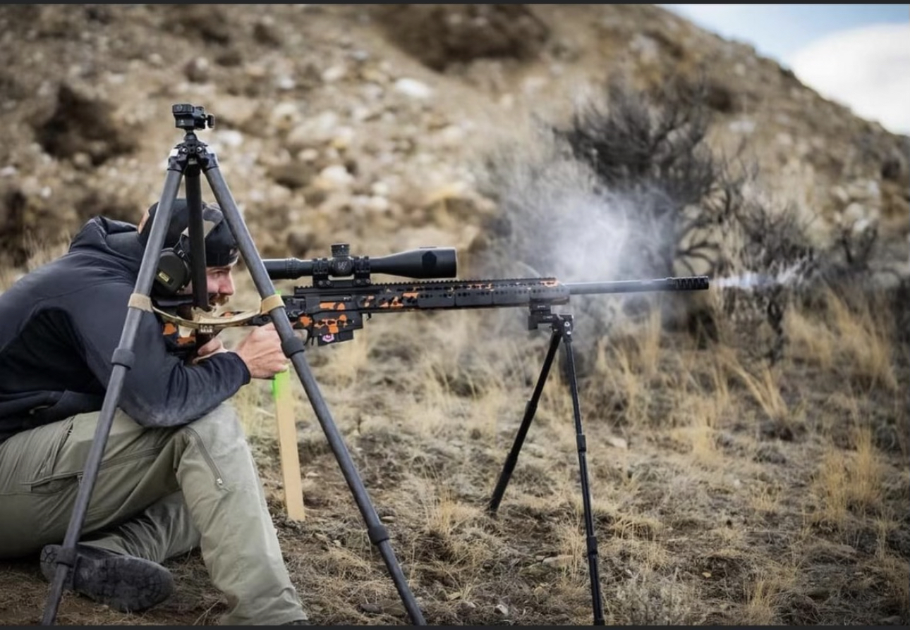

I know you’re not doing it for speed, but the ideal setup would be something like the plate with a bag attached way up front on the rifle. Then use the tripod in rear and “pinch” the rifle to the tripod leg with your support hand.
Reactions: Bryan W M
Bipod upfront would look like this. Obviously with a much shorter tripod being used on the railing and you’ll be standing. But you get the idea.

Does the cole tac not do me any good?
It will hinder your development. So many people go right to the bitch bag because they never properly learned how to setup a rifle and shoot off a single bag. Half the people dont even use them right and they score worse than those who are single bagging it. Most of the very best shooters just single bag it, and with the push to 90 second stages, you don't have time to run a rear tripod in alot of situations. The pump pillows (Bitch bags) have their place but learning to shoot off a single bag is the most important thing you can do to become a better shooter. It just translates to so many different props and positions.

As has been said, the best bet is probably a Gamechanger or Fortune Cookie-style bag on the deck railing, or on top of the tripod (if you want to be more upright).
You want to try to eliminate as much vertical wobble as possible, but there's almost always going to still be some happening, the only solution for that is working on what guys call their "natural point of aim"...
