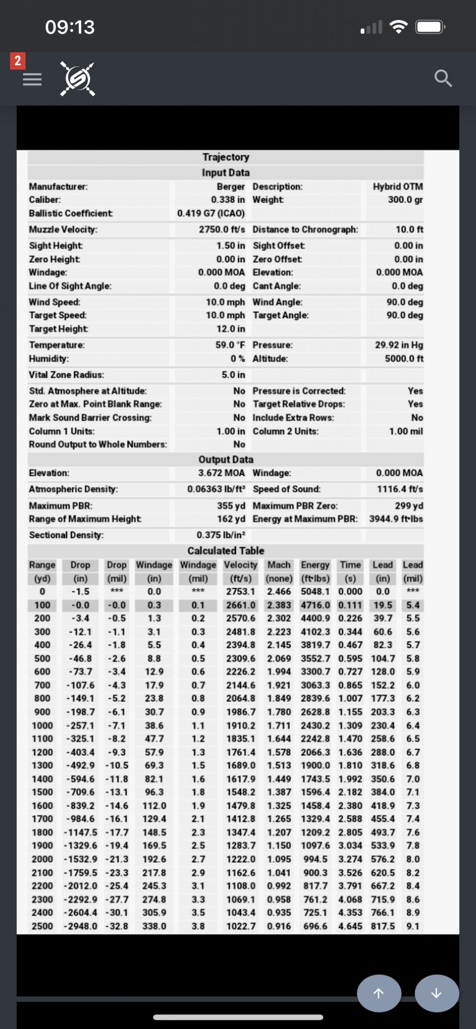

I am trying to calculate if it is possible to zero my rifle at 100 yards. If not 100 then what is the minimum distance my rifle can be zeroed. Below are the specs:
1. Firing 338 Lapua Magnum (300 grain hunter berger, G7 as 0.417)from a 26 inch barrell (AI AXMC).
2. Rifle rail has in built 30 moa inclination
3. In addition to 2, I have a 61 MOA scope mount.
4. Muzzle velocity 2775
5. Scope is nightforce atacr 7-35x56 FFP with 29MRAD /100MOA internal adjustment range.
6. Scope height 2.96 inches
thanks for your time and assistance !
Well, if I understand the 61 MOA scope mount is adjustable, I would think you could zero the scope anywhere from the 30 MOA = 8.7 MRAD rail that you'd prefer.
On the other hand, if the scope mount is fixed at 29 MRAD, It seems as though you may not have the internal scope travel to zero at 100.
The chart I posted on other thread. Again not mine but relevant to what you want to do
If your rail is >40% of your total travel I would get a less severe rail. Maybe @koshkin can chime in about being at the absolute maximum/minimum travel of the erector, but I thought it was a bad idea to be at the extremes for full functionality. You don't want to be wound out on your zero, and quite frankly you don't need that much travel even with a .338L.
Reactions: harry_x1
got it...let me know if I am thinking right. I have 91 minus 50 = 41 MOA of excessive elevation. Which should mean the my minimum zero is around ~1400 yards?
You have 91 moa added elevation from your mount/rail. If you had zero then expect the scope to have 60 up and 60 down of travel when zeroed. By adding the 91 moa up you’re basically starting with 31 moa high on elevation.
So let’s say with no elevation you sight in at 100. You can come up 60 moa from that zero. Which gets you to about 1800 yards
Now add 91 moa in the base and mount and that same bullet will hit 31 moa or about 31 inches high at 100 when the scope is bottomed out.
If you made that 50 moa instead of 91 (so 30 moa rail and 20 moa mount) that would back it off 41 moa. Or essentially giving you 10 moa of elevation down at 100 yards. Which is where I’d say you are reaching limits
Ideally you want to play in the center of your scopes adjustment. Not maxed on either end all the time
Personally I’d have:
- 30 moa rail (which you already have)
- 20 moa mount
- Zero for 300 yards is what I had on mine. Dialed down for closer shots
This would give you 110 moa of travel or 32 MIL up elevation. Putting you just shy of 2500 yards. Which you can make up with a reticle like the Mil XT. Beyond that distance we start talking big 33’s or 375 options if your serious about making those hits
Just my opinion. It’s early so if my math is off someone feel free to correct me

Not sure you can do the math on paper by simply splitting the overall travel. that would assume center of travel is baseline of 0 at 100yds.
that is most likely not the case.
for example. I have a Burris XtR2 with 90moa overall. I could not zero with 20 rail and 20 mount. After contacting Burris they said its because they purposely offset the internals to compensate for about a 20 moa so with a 20 moa rail you should be in the center of scope travel and zero at 100yds.
So actually the 20 rail + 20 mount + 20 factory offset gave me 60 moa overall.
make sense?

your concept is absolutely correct..however the issue becomes when you have a newly mounted non zeroed scope...like in my situation, it would be pretty dangerous to fire the first test round...minimum zero is 14 mils and the very first round could potentially land 2 miles away.

You're doing something severely wrong if you cannot depress the scope enough to be able to hit something 100 yards away and still have elevation travel to hit something at over 1500 yards.

Just because a scope says 90 moa doesnt mean you can put 90 moa of cant in mounting it.
They make adjustable scope mounts and also other devices for ELR that allow you to add elevation and still have a normal scope setup and 100yd zero.

If I'm understanding you correctly, your 41 yard point of aim is lower than your point of impact as seen through a boresight. This means that you could theoretically zero even closer than 41 yards. So obviously you'd be able to zero at 100 yards as well. Just push your target out further.
FWIW, 91 MOA of elevation is almost exactly what you need to shoot out to around 1 mile with a 338LM. And then you still have all the elevation you can dial in your scope which would push you out to maybe 2 miles? I dont know exactly, I'm just estimating, but the point is.... if you're planning on shooting to only around 1500 yards, you have WAY more elevation than necessary in your rail/mount combo. All you would need is that 30MOA rail and a different 0 MOA mount and you'd be more than fine at 1500 yards. That would be a more sensible setup.
thanks for the recos...I am seriously considering the charlie tarac option. Picked this higher elevation scope mount as it seemed like a cheaper way to get things done. Lesson learnt
if you want an inexpensive way to maximize dialed elevation check out Burris XtR signature rings. they will give you customizable cant from 0-40 moa. for around $100 they are actually solid rings. I have 3 sets. Its allowed me to dial out to a mile with my 300PRC.
Bottom your scope out on zero and start trying the inserts with the laser on until you get a combo that puts the reticle just below at 100yds. this you can do at home.

You have way too much forward cant in your mounting system. Like someone else said, 50-60 moa should suffice for 2500y and you should be able to zero somewhere between 200-300 yards but you’d have to verify that on the range. You can also persue one of those adjustable cant-capable mounts.
Given that, I wonder what your round’s transonic threshold is (can be computed based on known input data such as MV, DA, etc).
And 70% hit rate at 2400y on what size target?
You’re asking a lot of a 338LM and yourself if the target is man-sized. Go right to .375 CT or beyond if that’s going to be a significant part of your overall long range work as a hit rate below 70% all other things equal makes the cost per hit (not cost per round) non-sensible financially, IMO.
I’d change your mounting set up on this 338LM rifle but its up to you.

Max Effective range: varies a bit based on conditions, location to location and what kind of day you’re having but broadly speaking it’s the lesser between either the max range that the bullet’s flight path can be reliably, mathematically predicted (general definition) or the maximum distance you can reliably hit a target within two to three rounds if beyond 800m
Your Hit probability: cannot be calculated until you build up enough of a sample size of attempts (30 at minimum) and it will be only applicable to you on your system and ammo being used (i may take that same system and do better or worse, for example). Everyone has different proficiency levels, etc.
That said, the Canadian Land Forces contract solicitation (2005) for the C8’s SWS replacement specified a 90% probability of a first round hit at 1200m using known inputs and constraints as a performance requirement so you can perhaps apply a similar approach to think through acquisition of a similar system that routinely achieves first round hit at 2400m 70% of the time. The rifle that ultimately won that contract was the PGW Timberwolf and became the C14 SWS…just a bit of trivia to help you along those lines.

Thanks for sharing the inputs. I did look up the C14 numbers and they are helpful in understanding outer limits of 338LM. Combining this with my own experience, I think the effective range (70% hit rate) for my 338 set up is around a mile. I will still try to stretch this to 2400, just for confirmation and data collection. As of now, it seems 375CT is the way to go for consistent 2400. I will come back and update this thread if/when I start getting consistent at that range.
