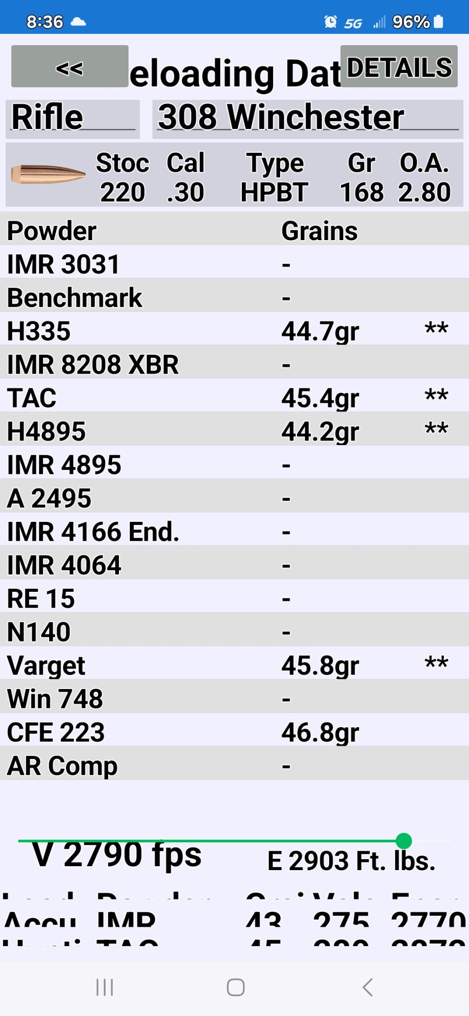

    FYI

    Are you seeing any kind of pressure, because you shouldn't be anywhere near max. Hodgdon shows 2737 with a barnes 168 and 45 gr of varget. The berger data is no good.
    Thinking way back, my standard load was 43gr of varget with a 175 smk.
