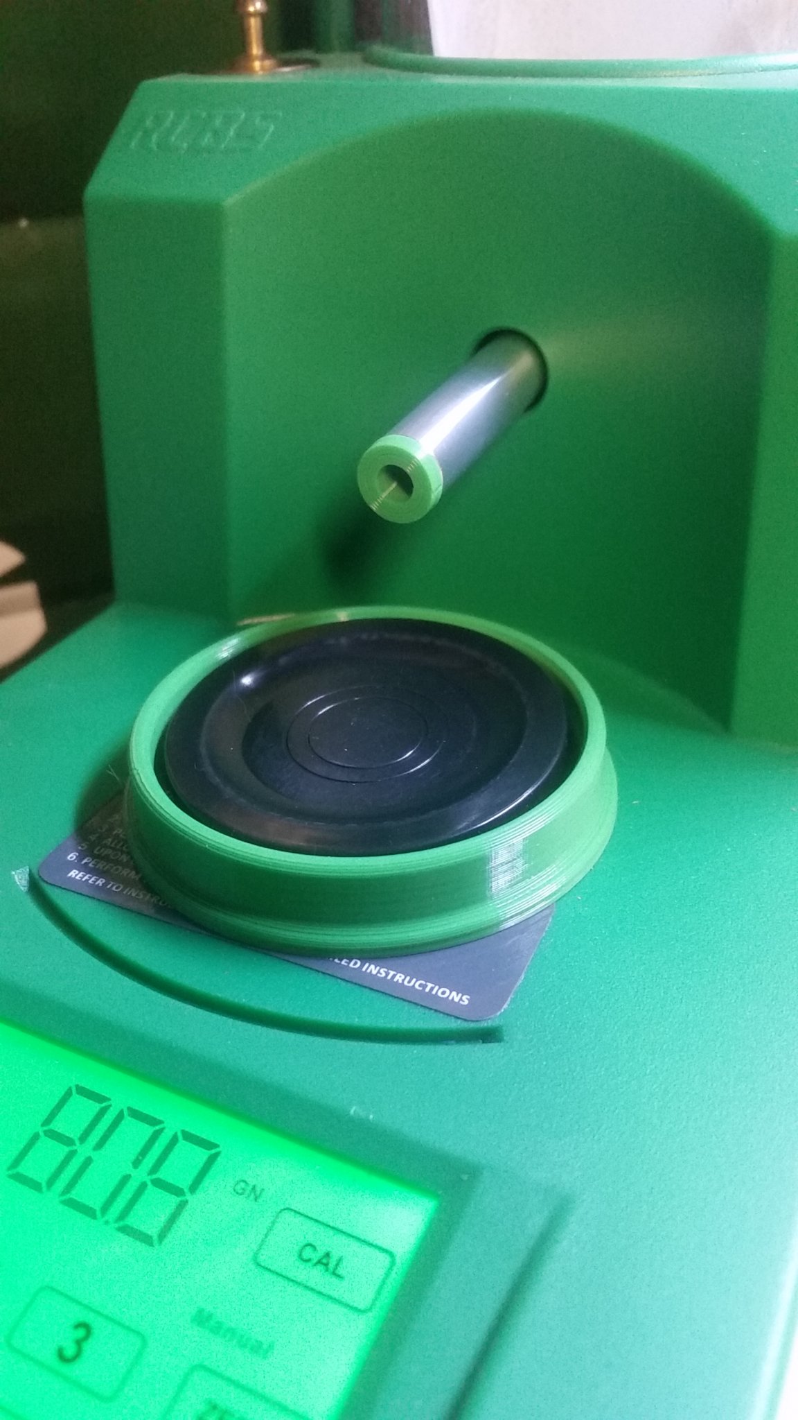

Hey guys I need a little help in the powder dispensing department. Currently I drop with a Charge master lite. (SDs in the very low teens)
I was thinking of purchasing a A&D EJ-54D2 and using it in conjunction with my charge master (trickling up on it). This is the cheaper of 2 options.
Or I could purchase a Matchmaster. I would sell off my lite version to help offset the cost.
So just wondering between the 2 choices what route you would suggest.
Thanks!!

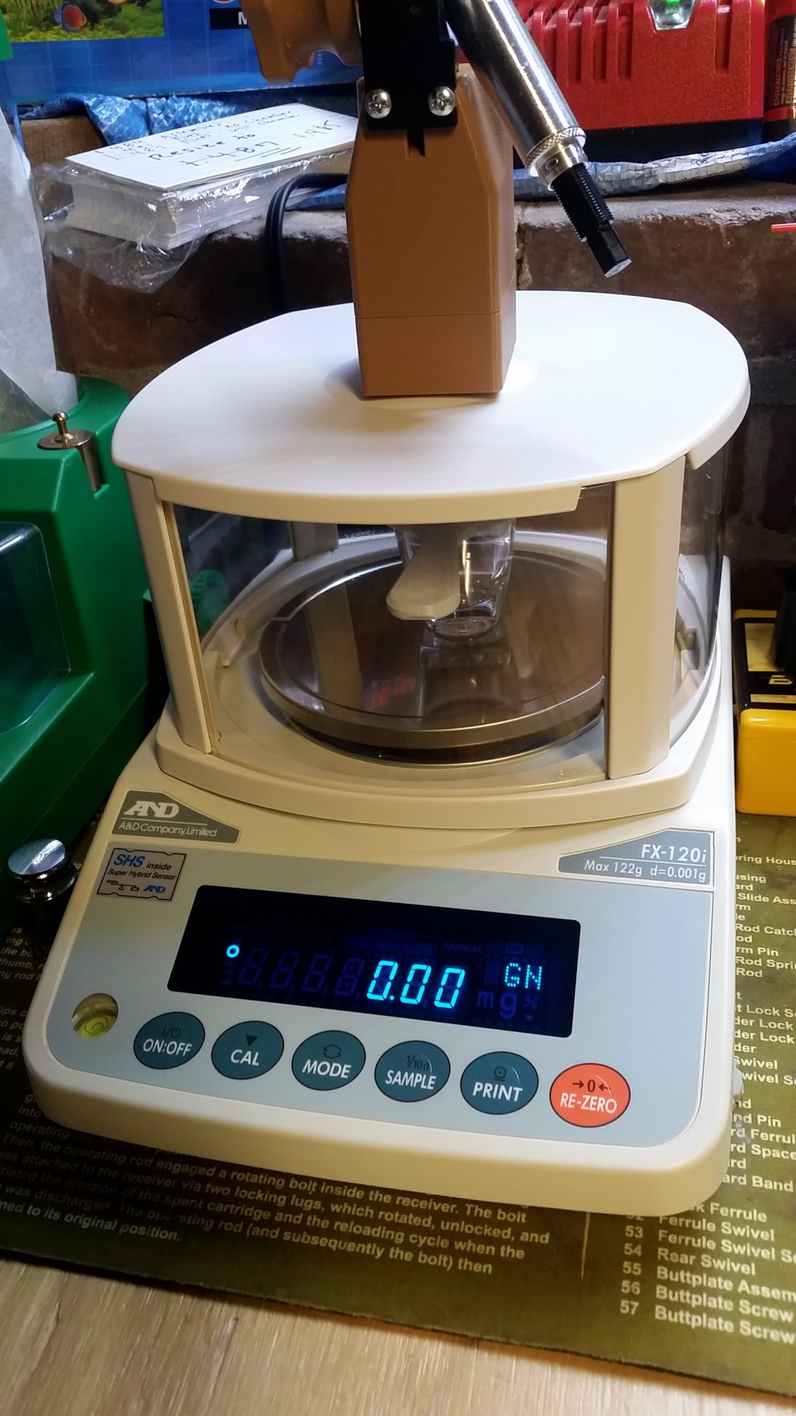

I went from a lite to an Auto Trickler I honestly don't think it had any impact on my precision. I wanted it regardless but it doesn't really seem to have affected my ES/SD that being said I had low teens ES. SD was already in single digits.
The AT V4 is definitely faster than my lite and I have peace of mind with the accuracy of weight.
If I was doing it again I would definitely consider the super trickler

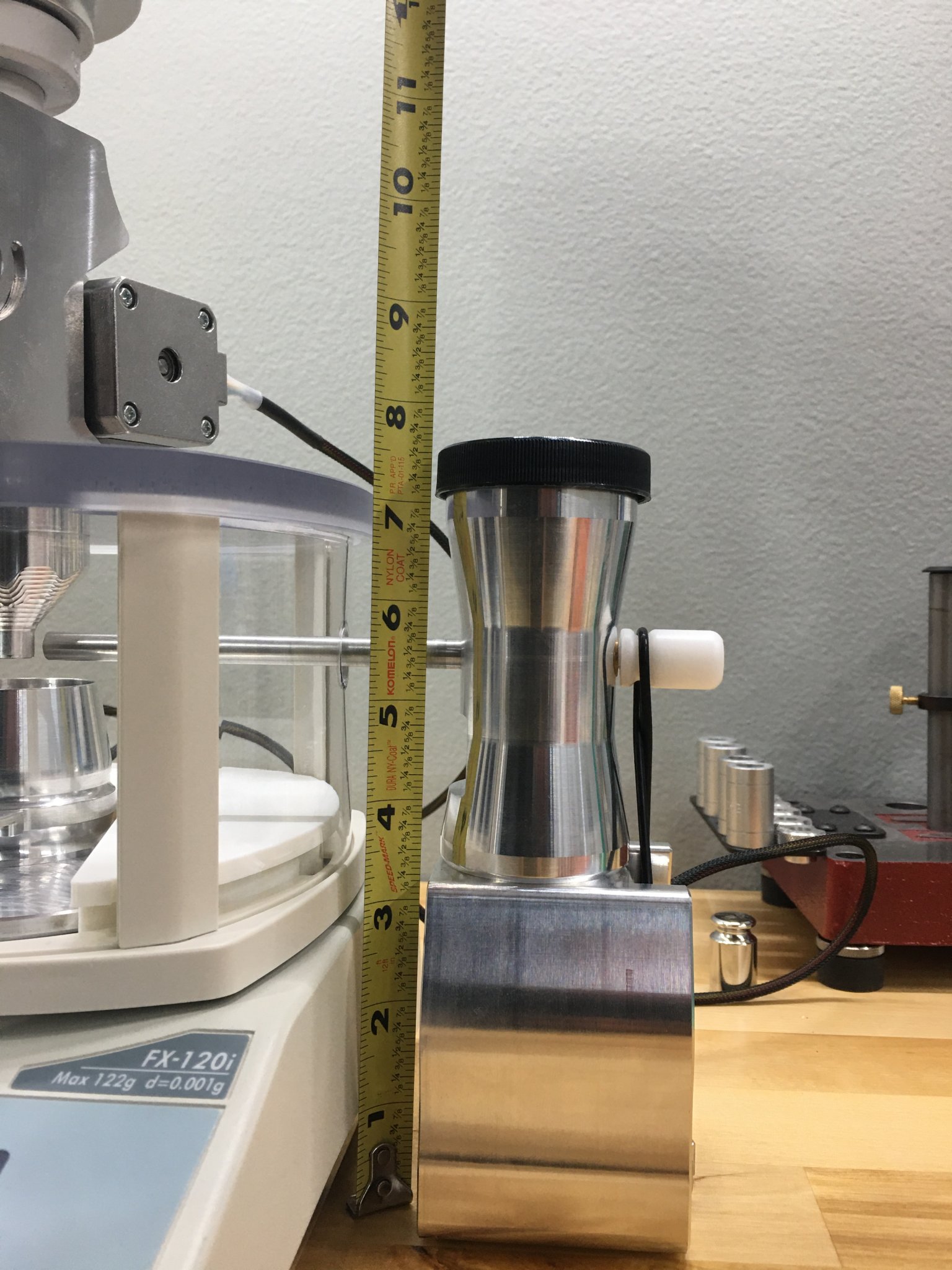

The Auto Trickler and the Supertrickler are the latest state of the art before you jump to the Prometheus. These both use the FX-120I scale.
If you don't mind spending a little more on the Autotrickler, the Ingenuity Precision trickle unit is a very good upgrade that adds speed and reduces over throws.
The Hornady unit and the RCBS Chargemasters are about the same cost and performance. Lately there has been some evidence that the Hornady unit is just a touch better.
If you just go with just the scale, you may find the advice to just get a FX-120I is worth the extra since it can become the foundation of the next level if you choose to upgrade, and is only slightly more than the EJ.
Going from the scale you have to another to gain the .02 resolution isn't going to make your SDs drop from the low teens to single digits. I would revisit your loading procedure and components before you spend 1200+ on a auto trickler setup. I load on 2 Chargemasters at the same time and I can get my loads well within about 5SD most of the time. Some loads are closer to 2-3SD. ES around 9-11FPS on Chargemasters.

I never cared for the factory on/off lite shield vs the one on the 1500. So I printed one that surrounds the load cell to keep breezes away.

Well guys I bit the bullet and ordered the FX 120i scale. Could someone be so kind to tell me about how high the trickler nozzle should be . I 3D printed the adapters so I can mount a Lee powder measure up top.

It depends on how tall your cup is.
Sadly I’m not at home to measure my trickler height so you could match that.
