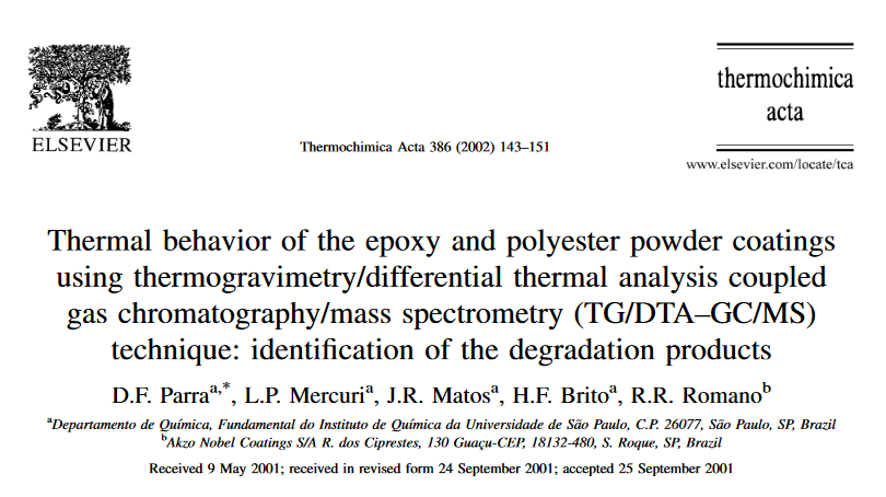

So their is a nice paper published that talks about toxic thermal decomposition products of both Polyester TGIC and Epoxy powder coatings.
The paper used Thermogravametry/ Differential Thermal Analysis analysis (heat it up and see the phase changes and decomposition). then they run it through a gas chromotograph/mass spectrophotometer to determine what the gasses contain. They did it for the raw materials and the final coating. The raw materials decomposed at 200°C/392°F and the coating about 300°C/572°F.
These temperatures are easily reached during the burning of the propellant and friction of the bullet down the barrel.
Here is their conclusion.
Conclusion
In this work was observed, under thermal heating
conditions, that cured coatings of polyester resin for-
mulation containing TGIC, and coating of epoxy resin
formulation without TGIC decompose and liberate
toxic products as benzene, phenol, among others, as
the result of thermal degradation process.
The separation and identification analysis devel-
oped by the TG/DTA–GC/MS coupled system had
identified toxic products evolved in the decomposition
of the polyester and epoxy resins. The identification of
similar products in the resin and the polyester coating
confirms the origin of the formulation. The thermal
oxidation stability of the coatings after curing is
greater than those of the individual resins, as expected
by the reticulation of the resins chains occurred during
the cure process.
So anyone who doubts powdercoated bullets are not producing toxic/carcinogenic chemicals, please post up your data.

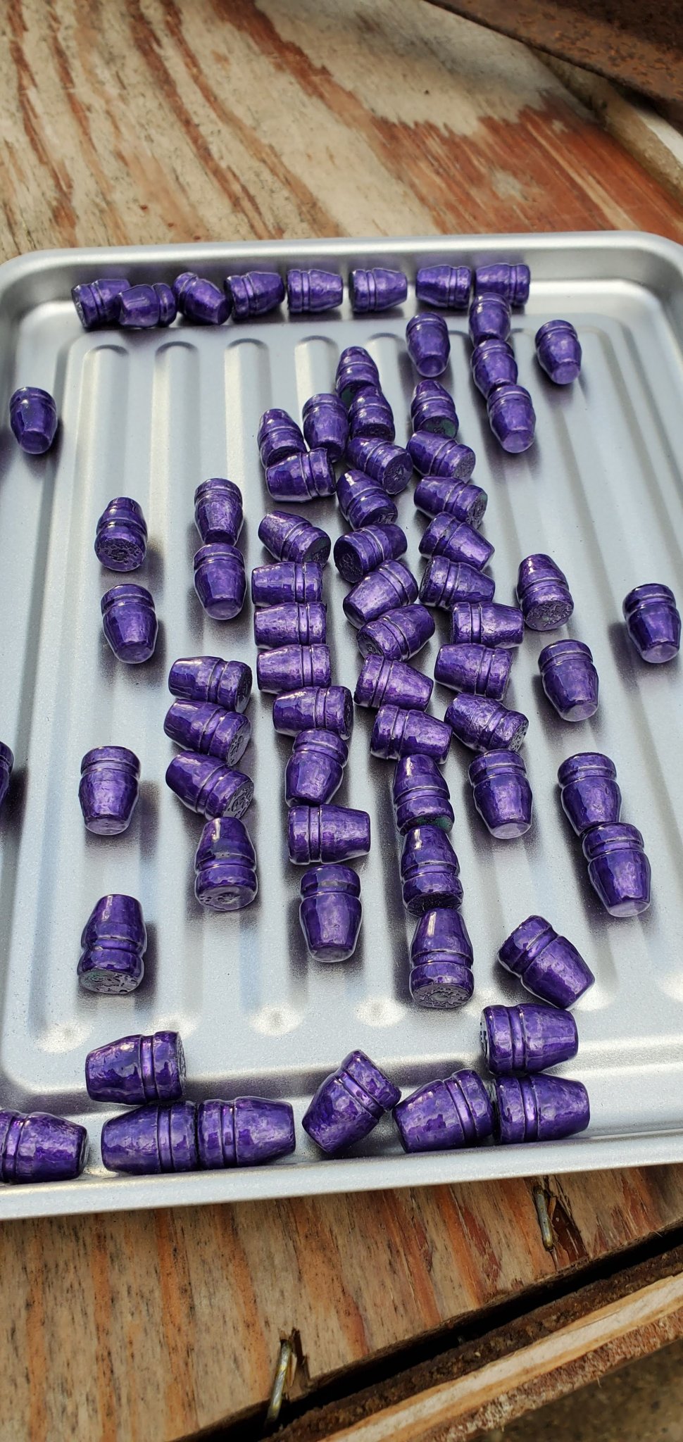

If you're old enough to remember polyester pants - we're putting that stuff on bullets now! :D
It's weird stuff though; it's a thin flexible polymer layer about as thick as a plastic shopping bag, which you wouldn't think would hold up in a barrel very well. But it achieves the goal of separating the lead from the barrel, and reduces friction enough that it doesn't get wiped off the bullet by the rifling.

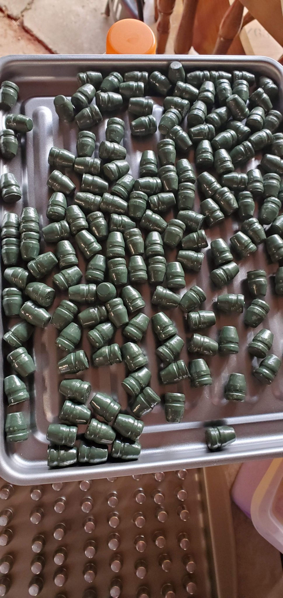

About 10 years ago, before we had an easy way to coat bullets, a bunch of us bullet casters were experimenting with different coatings. Lots of different types of paints were tried, I messed around with some spray epoxy coating and a bunch of different aerosol dry lubes, but nothing worked as well as powder coating. At the time, those of us who were powder coating used a wet process of mixing the powder with a solvent like acetone, then rolling the bullets around in it and setting them out to dry. It did work, but was slow.
Then in late summer 2013, I experimented with trying to apply the powder dry, and found that the white plastic yogurt tubs worked really well to generate enough static to stick the powder to the bullets. I first published my method on the old 10mm Firearms forum, and then a number of other places like the one linked below. I think it's likely other people discovered the same method, because it took off and within a couple years became commonplace among a lot of bullet casters.
Here is the method I developed; I could re-post it here but that thread has a lot of useful questions and answers.
Powder Coating Quick and Easy

I have reloaded a lot of cast 158 gr swc in 38 and 357. Used to shoot a lot of PPC and the only way I was able to afford it was cast lead bullets. This is one reason I am worried about what I breath when I shoot. I stopped shooting cast lead 20 years ago when i found out I had elevated lead in my blood, It is still elevated 20 years later. This is why I considered powdercoated bullets. I even used federal syntech polymer coated bullets. I was working on a powder coating project for work a few years ago and came across the article. This led me to do a lot of research and the more I dug into powder coating and sublimation, the more I became worried. You are correct only very little vaporizes, and is it more toxic than the combustion products of the powder and primer is unklnown. Especially now with the shortage and people buying what they can find, and a lot may be even more unhealthy. but having had cancer once I never want it again. I am not saying to not shoot powder coated bullets, just to do it with more caution because of the potential carcinogenic combustion side products.
The main problem is when one does not cook the bullets long or hot enough for the PC to cure. I have been at the range when other were shooting their bullets and you can smell burning plastic. The Hitec also does this. Some of the commercial casters were not cooking long enough to speed up production. Boy you could smell the plastic from 20 feet away in a lite breeze. I am sure there is some gas coming off. Shoot inside and you will see what I mean. You can tell when someone is shooting them. At least I can.
I will not be going back to lubed bullets. The benefits to PC are way too great to step backwards

So I powdercoat both pistol bullets made from lead and I powdercoated some .224 bullets for 223. I'm not sure what the concern would be exactly because the 223 bullets that I tested as an example for testing I run 53gr cast bullets powdercoated with 25gr of Tac. I loaded 2 thirty round mags and shot my M4 suppressed just doing a fast mag dump trying to make them fail. Ie FTF or FTE. After that I completely disassembled the gun and cleaned. There was no kiwi green colored powdercoat found in the barrel, gas tube or bcg. So I'm not sure what the concern would be. The chemicals used to clean are more likely more dangerous than what is residual in the gun. I have also melted a powdercoated 9mm bullet with a map torch, the lead melts faster than what the coating disintegrates in. Meaning the coatingactually remain structural of sort with molten lead inside until it finds a defect to flow out of. I guess I understand the possible concern but I'm not sure it actually applies since its only in the barrel a fraction of a second after being fired.

In my next post I will get into published scientific articles on thermal decomposition byproducts of powder coatings.

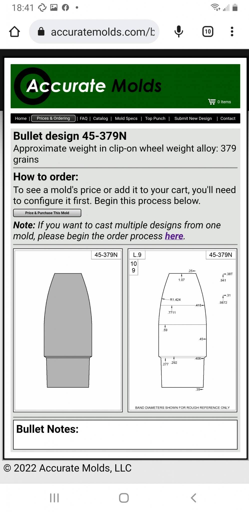

I'm designing a bullet mould specific for subsonic in my 450B. They will be coated with polyestercyanacritoxin.
