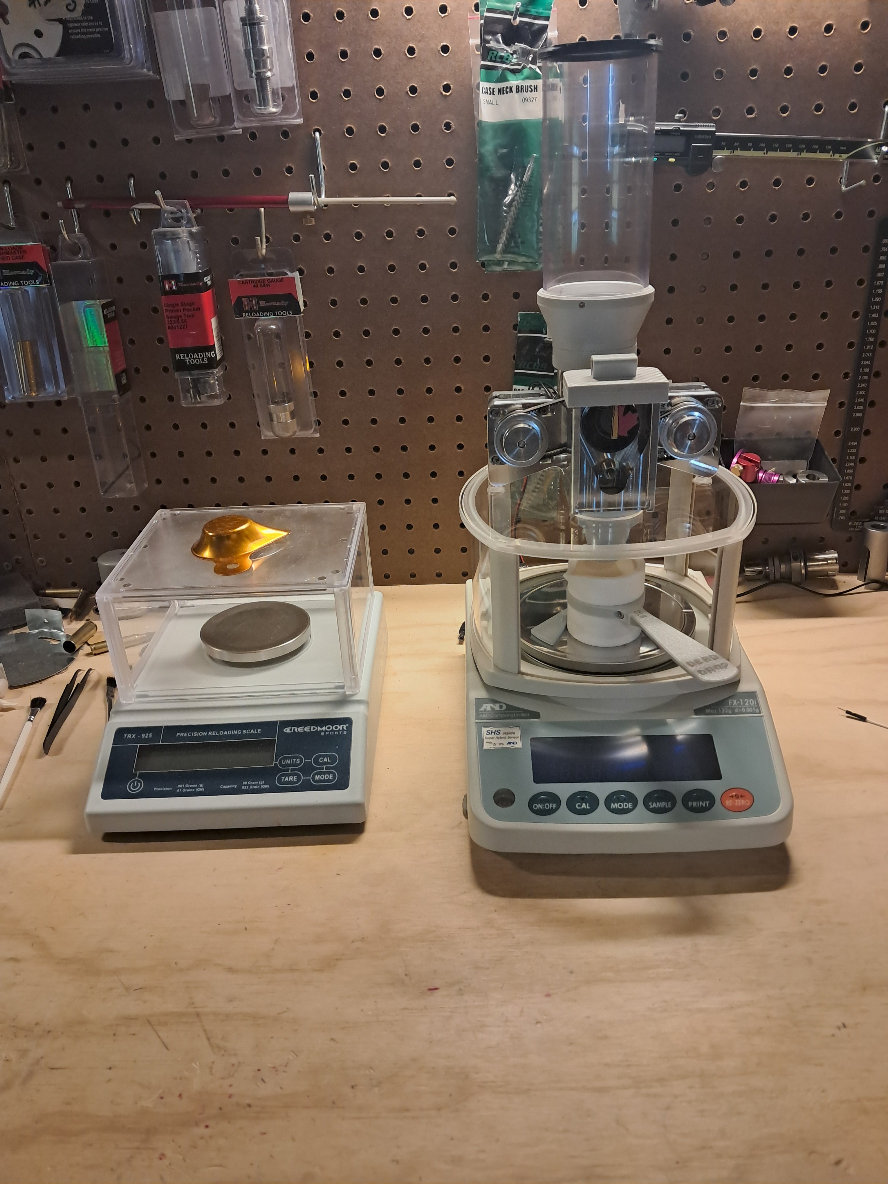

I know it's been a few months but if your still choosing I would go with the ingenuity/sartorious route and never look back. I have the creedmore scale and a atv4 I love the v4 but it will over throw sometimes if not calibrated correctly. I use the creedmore just for periodic confirmation but the fx has never been off.
