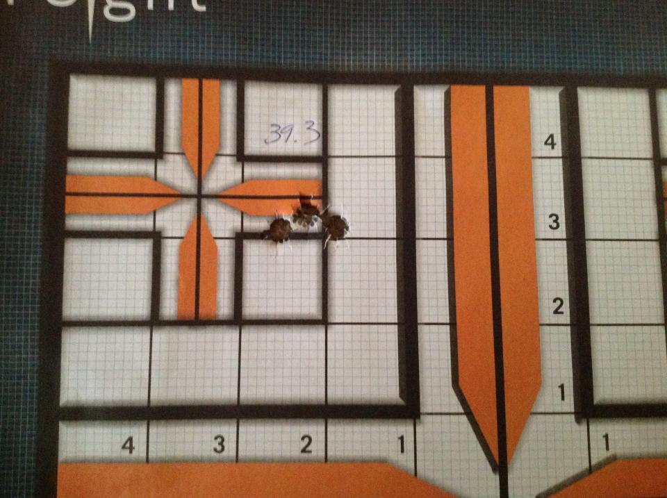

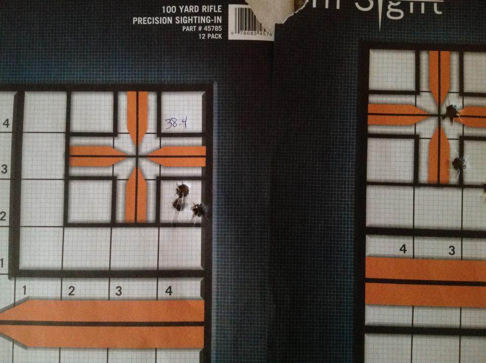

Not sure if I was actually successful in getting these pics uploaded but these are some results I got at 100 yards with a black rain 308 and ar-comp with 168 gr Sierra bthp. I was happy with it. Didn't have enough time to shoot all the loads I had for it before the storm rolled in.
