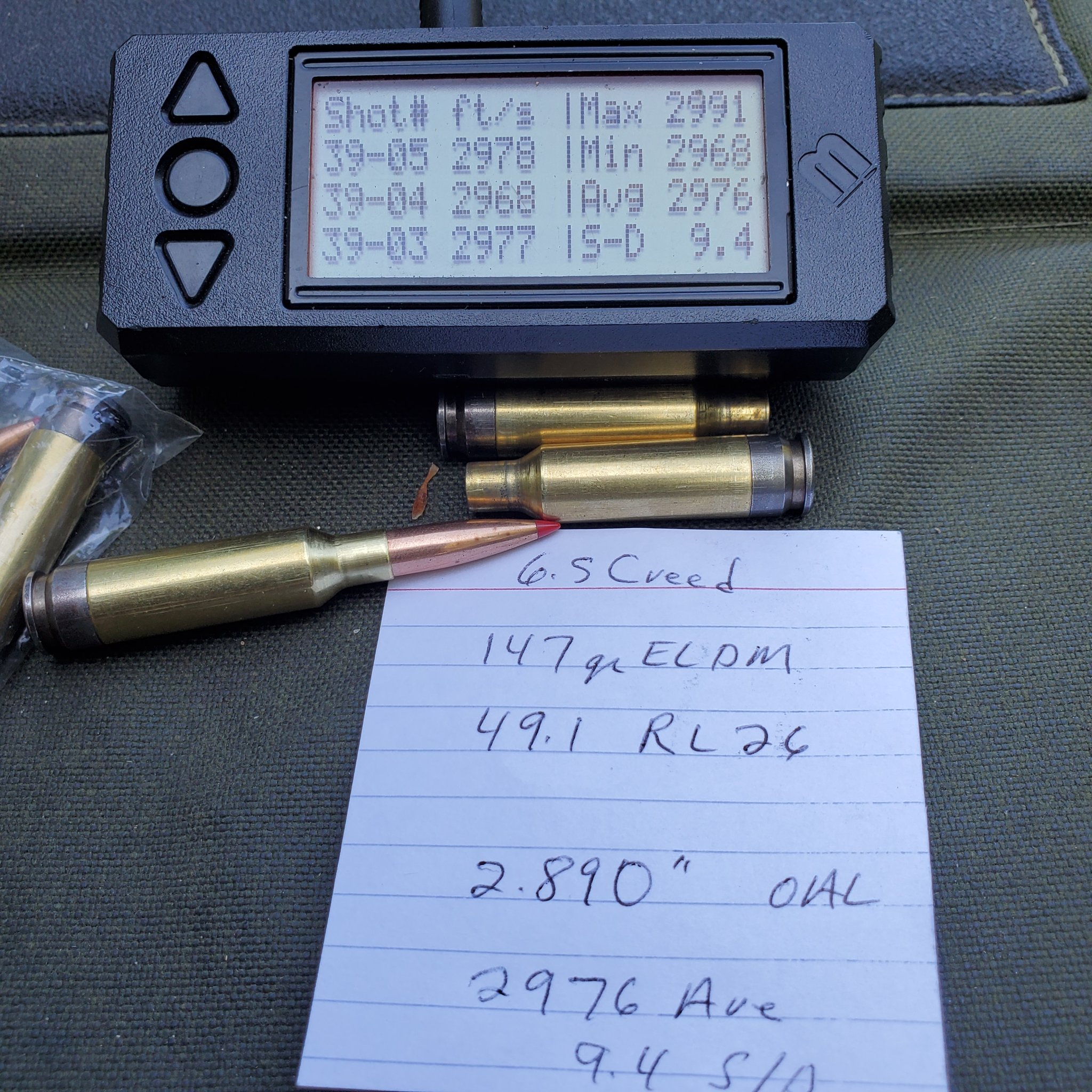

6.5 CM ...Reloader 26, 153 gr Atip "hybrid cases" factory 24" barrel 2964 fps. 150 SMK 2990 fps, accurate and fast running loads.
Ran the 140 gr up to 3150 fps, but run at 3100 fps, as a running load.
Not safe with brass cases, these cases will handle 80,000 psi plus...although the these are under, they are way over pressure from brass cases.
But its whats possible with a 6.5 CM if one cares to work up loads slowly, with these hybrid cases.
