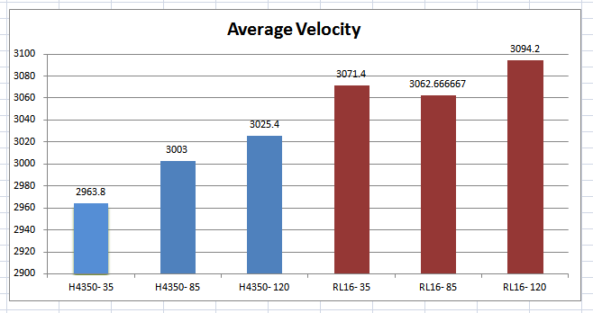

    Make three 5-shot groups out of identical ammo, put some on ice before you head out to the range to get them into the 30s, keep some normal in the shade at ambient temp, put some in the sun to get it real hot. See what they measure when you shoot em. It might be something you need to worry about (like with my h4350 laods) or it might not be anything that matters (like wiht my rl16 loads).
    You can also just reference prior data that was collected in the different seasons but if you dont have months to do so the test is easy to replicate.

    That's some nice data. I've been looking for the same info with IMR4350. It was the only powder I could find for a while so I stuck with it. I'm about done with my keg and deciding if i want to reorder the IMR or start working with something else. Sounds like I should run the temp test myself on the IMR4350.
    I always though H4350 was supposed to be pretty temp stable. Are/have people moving to RL16 for 6.5CM?
    It IS pretty temp stable.
    Im at .73 fps/° in my 6xc with a 105 which is a tad more than usual. Some combinations show more or less change though, maybe its just a variance between lots as well, who knows? The PRB blog got it at .21fps/° with a 6.5x47 and 140s. Other tests have shown higher and lower. Dont ever believe that it wont change at all though.
    The older non-extreme and reloader powders are 1fps/° or more.
