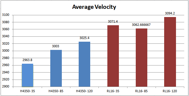

I did a test of my own a couple years back- 6xc 24" 105 rdf H4350 and RL 16 in the cooler on ice 35°, normal in the shade 85°and left in the sun 120°.
Came out to .73 fps/° for H4350. Not every combination will give the same results so the onus is really on you to observe what is happening yourself. Be it by waiting for the condition to see or deliberate recreation. There is a change.

Depending at what velocity the middle of the node is and temp - more specifically the time of year I worked up the load, I add or subtract a 10th grain of powder to compensate a little. Keep in mind I'm a fair weather shooter, no brain cooking going on or freezing my ass off either so.....!
Been there done that. I don't know that simply changing the powder temp makes the difference.

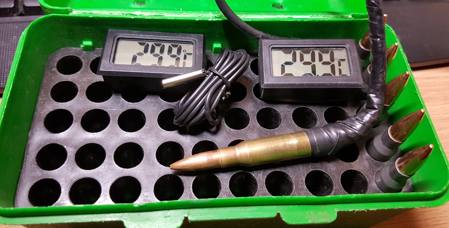

I did some testing with ammo at 20* at the range, and 160* on a 50* day. Ammo was soaked in those temps for 3+ hours prior to shooting 10 fps between the high and low temp ammo in 4 flavors of powder...including the super temp sensitive CFE.
I did this test on PP2000MR and saw the same thing, BUT I think it depends on the totality of the components.
I read somewhere that CCI250 primers are more sensitive than FC215’s. So maybe the primer has something to do with it.
In my test I used FC210’s with 48grs of 2000MR in FC brass with Berger 175’s @ 2.805” OAL. The average velocity did not change, but the ES got crazy with the hot ammo.
