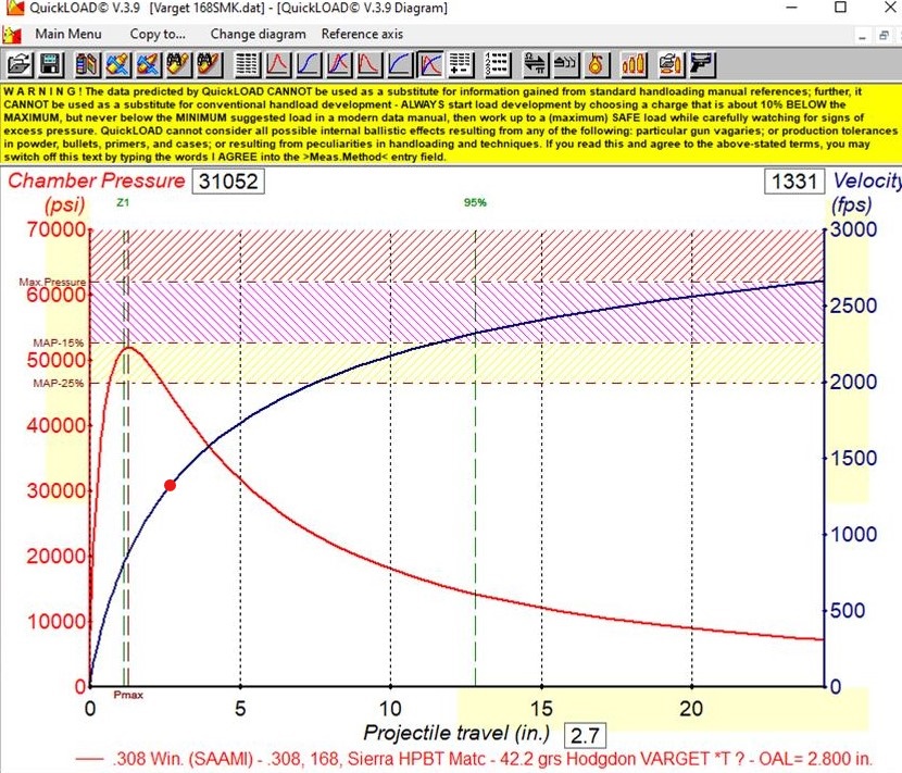

    In 5" that bullet in this quick load graph google image is already going 1500 fps, it takes another 10" (3x the distance traveled) just to make another 1k fps. The difference between a 15" and a 20" is only 150 fps or so in this example which is 10% of what the first 5" got you. Going from a 20" to a 30" will an even slower nfactor on that curve flattening the acceleration and top velocity, but it will still gain speed, just not at the same rate it did to start with.

    Maybe the pic below will give you some idea regarding the velocity through a barrel as it relates to distance and pressure (note the red dot on the curve indicating the 50% of total velocity as indicated in the box at top right and the distance distance the projectile has traveled in the box at the bottom:
    Reactions: Rockdoc173

    So, if I have a little 16" bolt action 308 shorty right next to a 26" competition rig, the 16" wouldn't need a faster powder? Would you use the same powder in both? I'm omitting for a moment the differences in what guns like what powders for the sake of comparing a faster powder to a slower powder.
    there is more to it but simply;
    if the case is already full at 16" there is no other way to create more speed (which would mean increased pressure) for the 16"... would need a faster powder
    if the case is not full then by adding more powder/case fill you will increase pressure which will increase velocity but diminishing returns
    It depends on a whole lot of factors and if you are just talking velocity alone. If you are shooting a light bullet in one and a heavy bullet in the other, generally speaking you will have better results choosing a powder based on bullet weight rather than barrel length. That said there is no way to know for sure except for testing. The caveat to that is there is a lot of manufacturer's data out there to give you a whole lot of clues.

    To answer your hypothetical question about the 16" vs 26" the answer is generally speaking absolutely no. Given you might find a faster powder that produces great results out of the shorter barrel, but those differences will come from the nature of the powder vs purely how it falls on a burn rate chart.
    It's also worth noting that going from 26" to 16" is a substantially different thing than going from 18" to 10.5". That being said, the general concept of what I posted above is correct.
