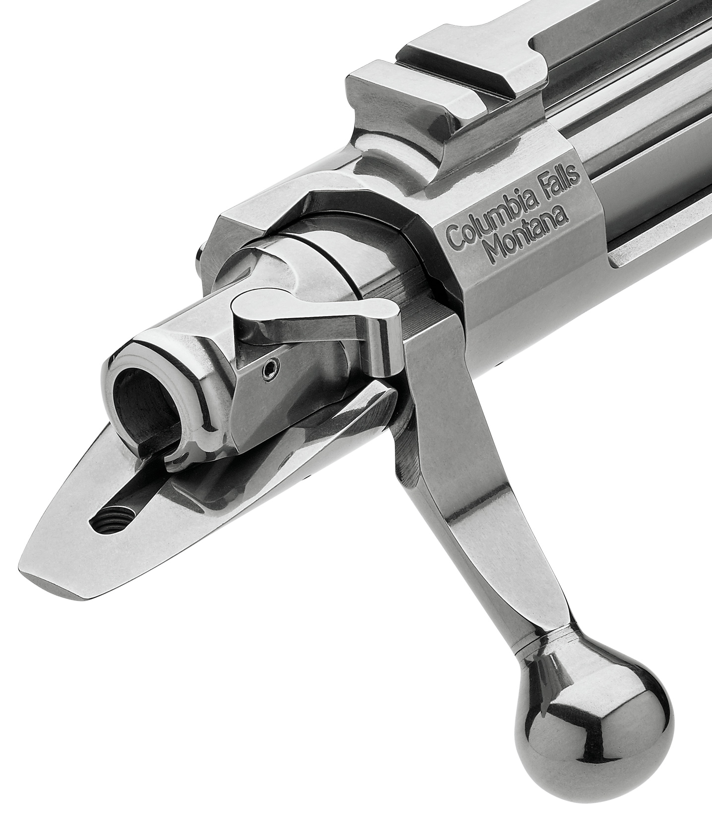

Defiance will sell you a controlled feed brand new custom action.
Fits the large selection of stocks and chassis, triggers, and bottom metal available for the 700, while giving you the controlled feed and blade ejector. Gives you the flexibility to change as your desires change in the future.
Unless you happen to have an old m70 laying around, I'd leave them to the collectors and get the newer tech and materials.
However, if you just have to have one, I would do whatever really makes you happy.

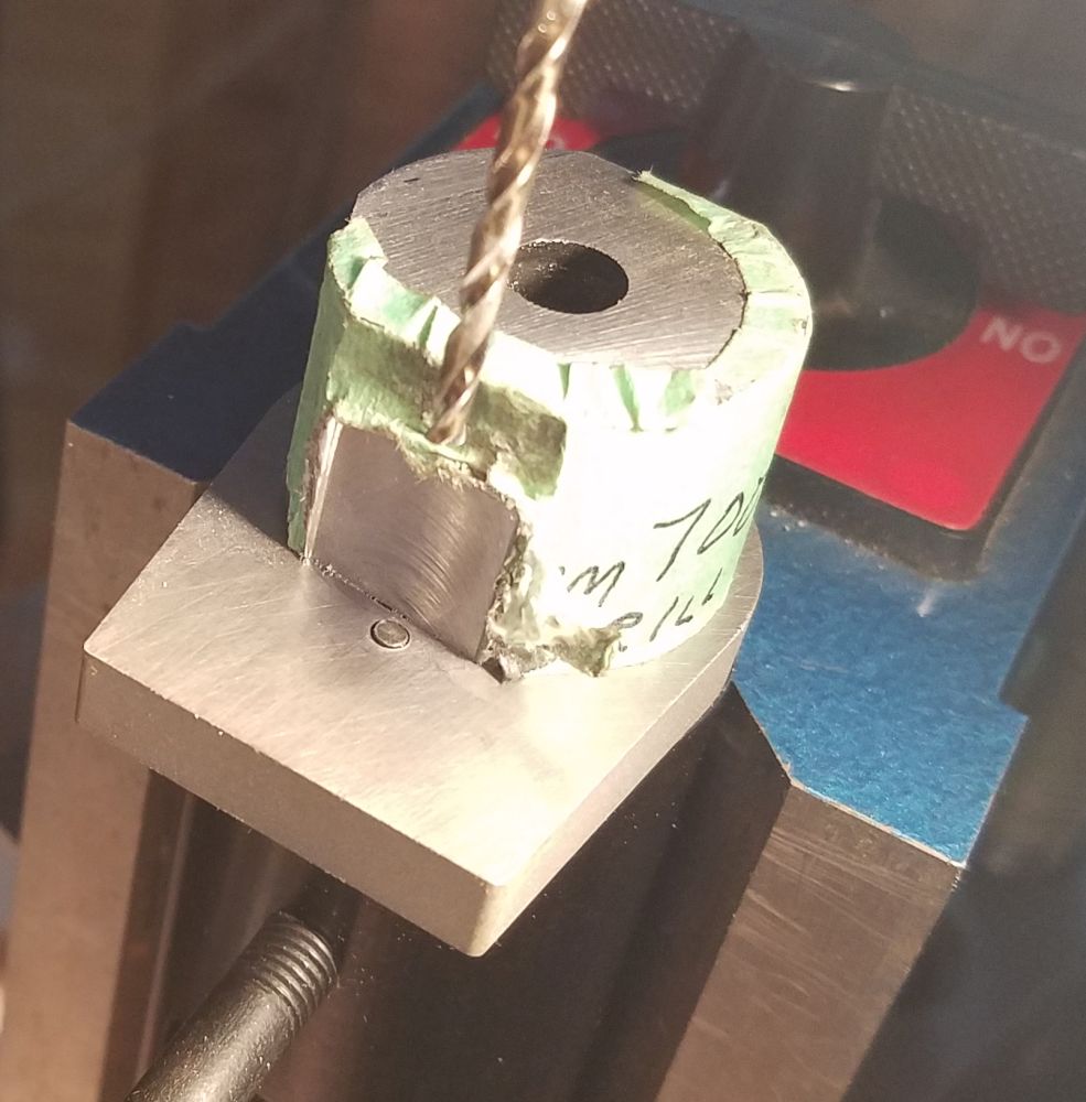

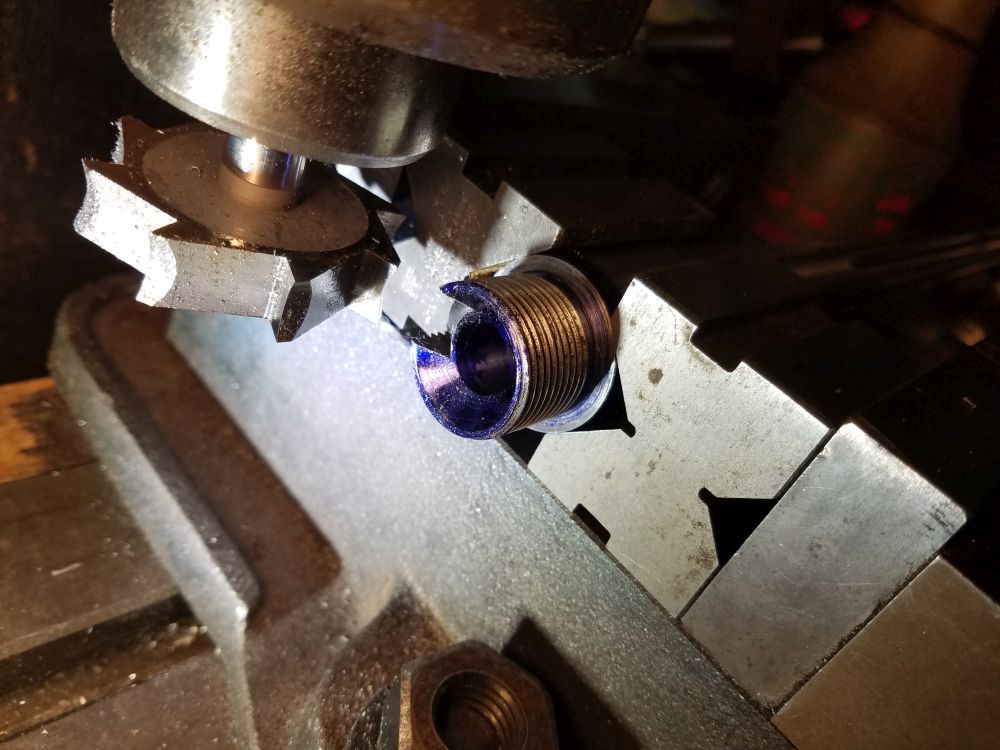

M70s have an extractor relief cut that Rem700s do not need.
I have to drill a Rem700 action to pin the recoil lug.
The Rem700s cost about 1/2 as much as a pre 64 M70, but I spend money on the Rem 700 bolt, extractor, bolt knob, and trigger. So Rem700 and pre 64 M70s wind up being about the same cost.
Reactions: Ledzep

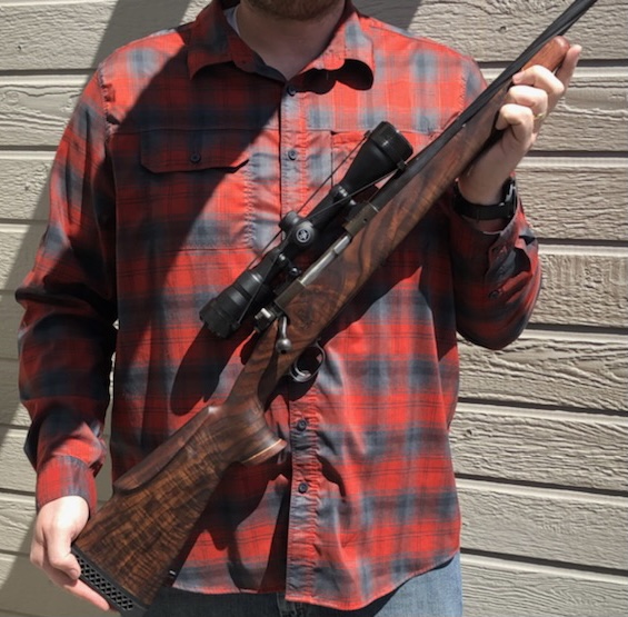

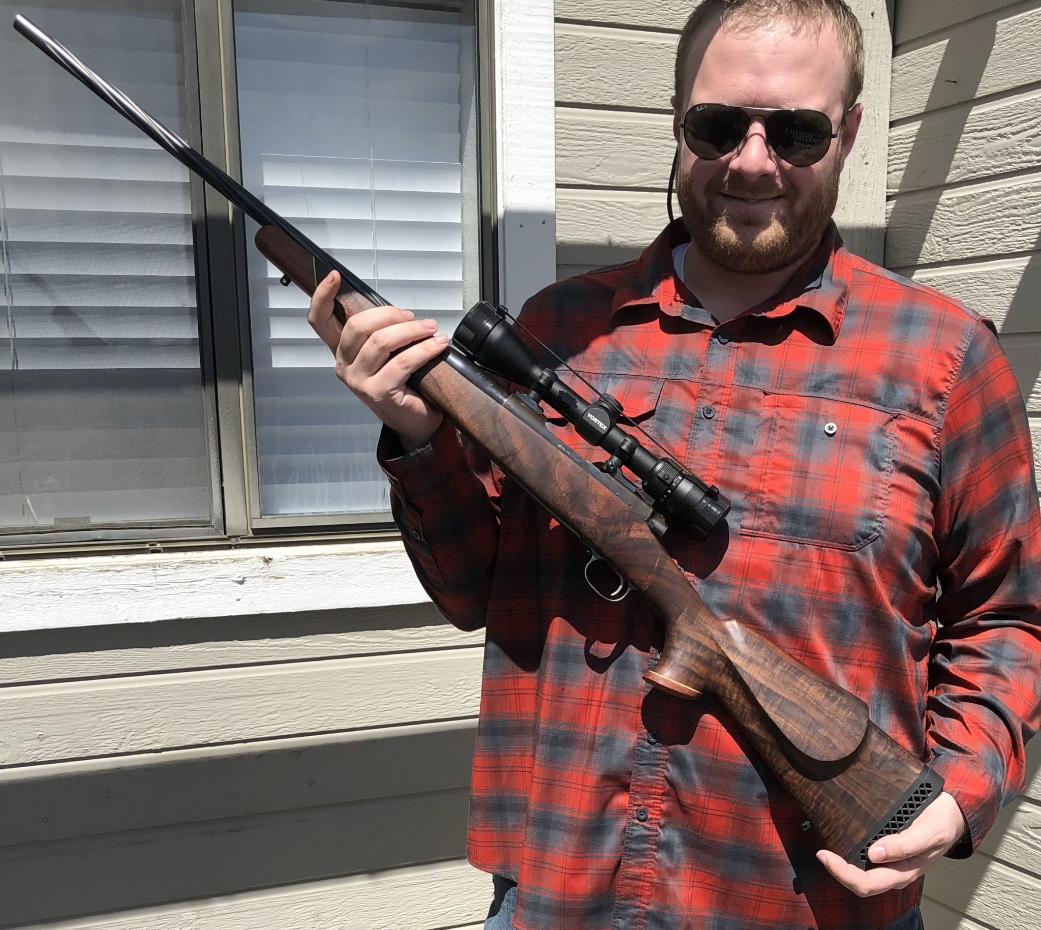

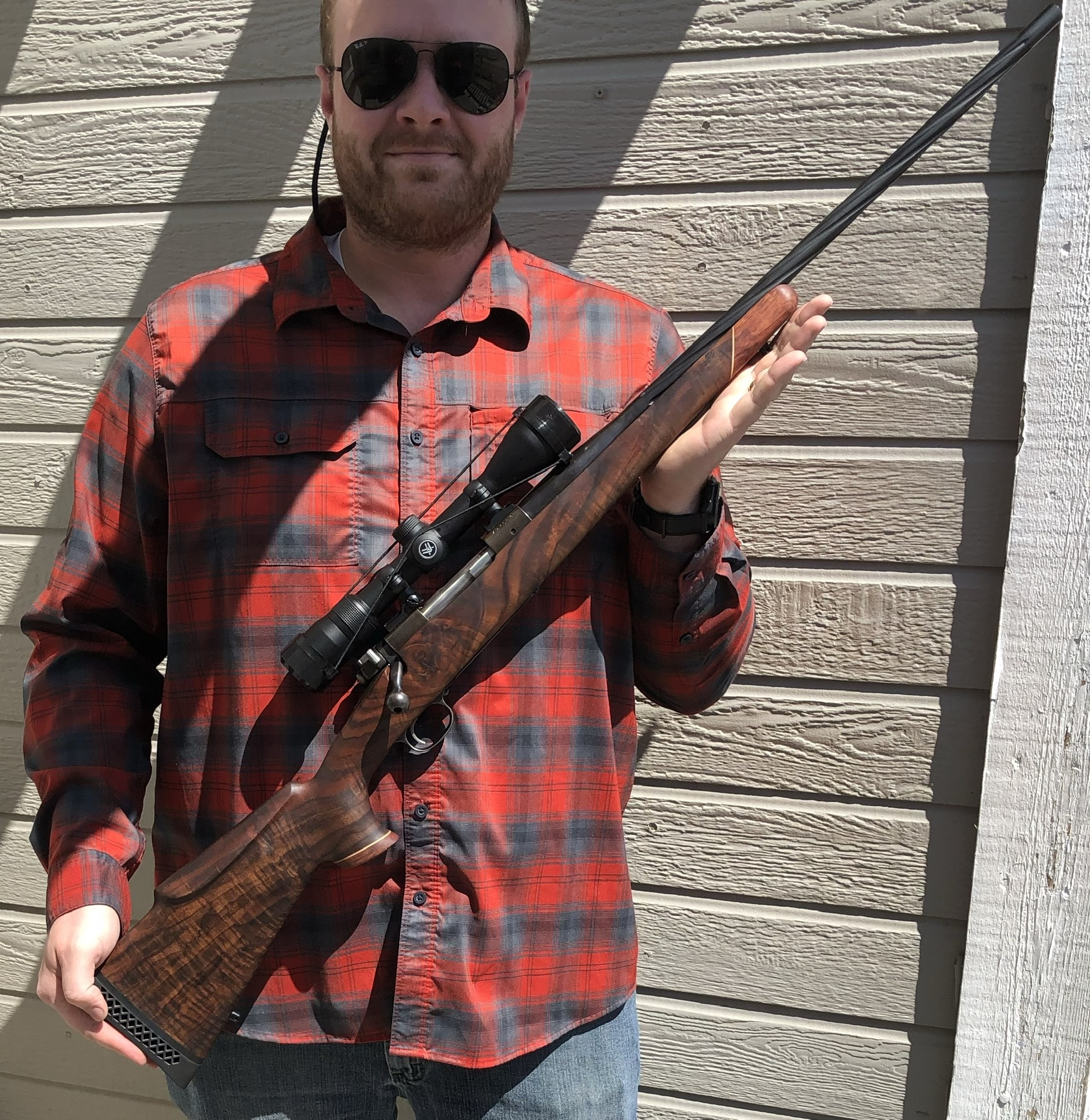

I recently built a rifle on a pre-64 70, I scored the old beat up rife from a local pawn shop for $500. ER Shaw barrel for $350, and a Richards stock for $300. Rust blued all the steel and oil finished the stock. Did all the work myself. Great action to work with, smooth and reliable. My personal opinion is it’s probably not going to be as accurate as a modern defiance like what was previously said. However they are a fine actions. That make fantastic hunting rigs. Someone said they need to be in wood and I 100% agree.
Nice find and work after the find.

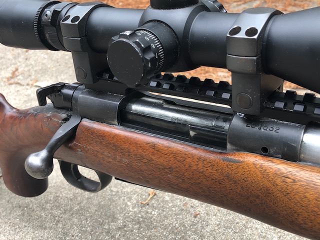

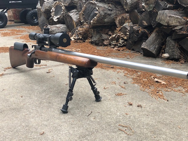

I am finally about complete with a pre-64 build. It has the short stroke kit for the new 260 chambering. It's bedded in a Winchester marksman stock and has a 26" Hart 8 twist barrel contoured the same as the original target barrels were, just 2 inches longer. Starting to see some pretty nice accuracy too. My buddy down in South Texas trued the action and chambered the barrel along with a great trigger job using all the original parts. I plan to go to a 600 yard F- Class match this Sunday and see how it does.
Looks sweet.
Looking forward to a range report!
