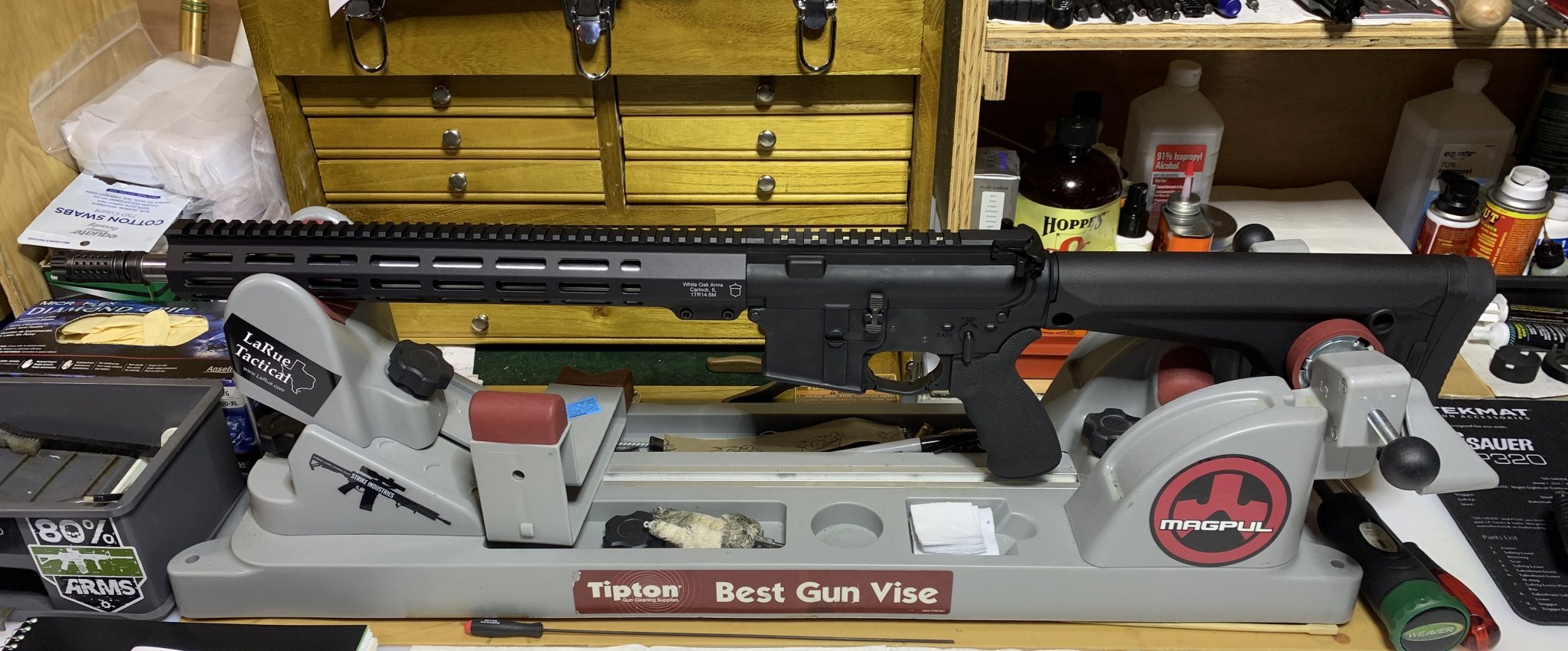

Here's my cheapo setup with a $35 tube handguard, steel barrel nut, steel lock ring, and a bag rider.
It don't flex :)

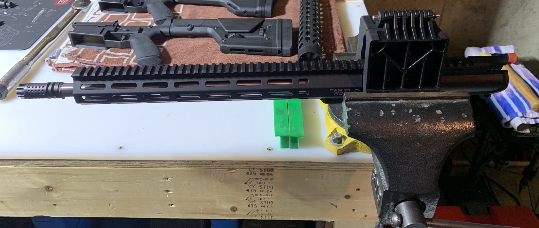

This was on a AR10 SLR handguard. I know they recommend 35lbs which is in my opinion not enough. I believe I only had the torque wrench set to maybe 50lbs. Bottom line hold an SLR barrel nut in your hand . It weighs almost nothing you could probably crush it like a pop can. Definitely not very robust to say the least.
Yes, they are light & I'm sure that they can be broken, given enough torque; I also agree that 35 is not enough & is whyt I tighten the SLR's to 42-43.
