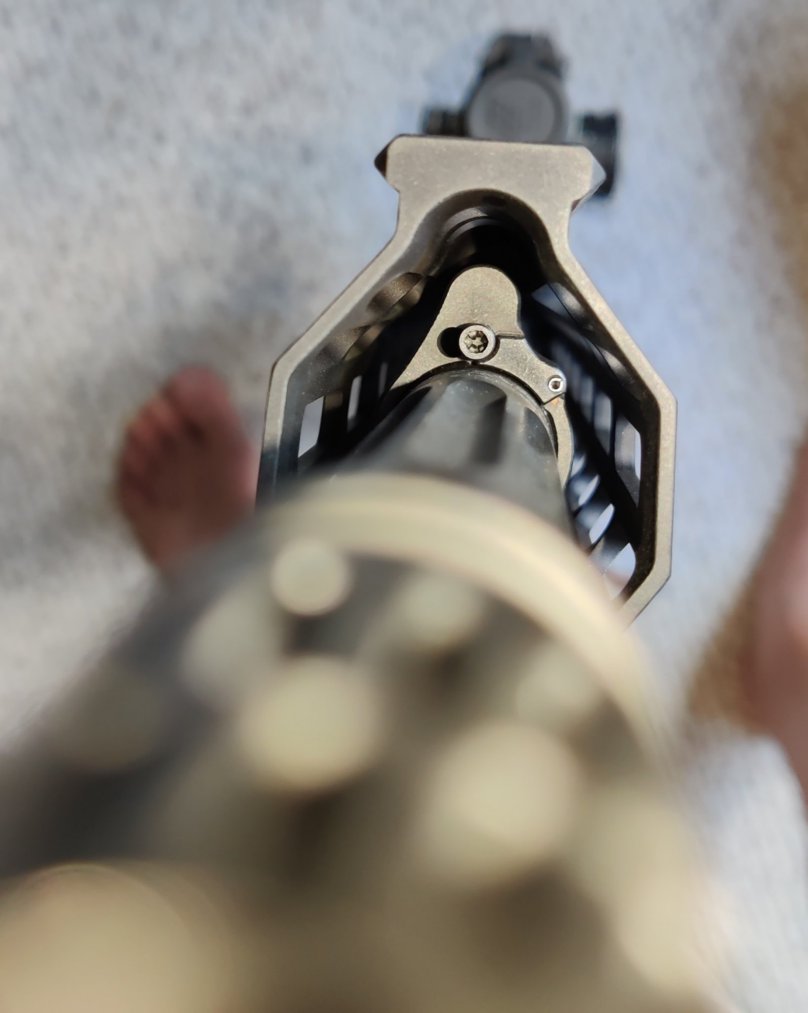

During the Pandemic I pieced together a 6ARC build for fun. Mostly parts bin stuff, with a new BA Barrel.
The goal was to see if I liked the caliber....well I do.
So I just double down and ordered a new 20" Tbox Barrel from Sgt of Arms, and I'm going to do a full build the right way.
I need some suggestions on Handguards
On my other build I have a Geissele Rail, which I love, but it's too small for most of the Adjustable Gas Blocks that I know and I want to be able to tune this build, so I need to rethink the handguard.
I've looked at JP, BCM, Seekins, WOA, but I'm getting overloaded.
Goal is a precision AR, 800-1000 yards. Don't have any ARCA mounts now, but if it's compatible in the future it would be a plus, but not required.
What are most guys running these days?
Midwest industries suppressor compatible or aero precision m4e1 enhanced are a couple of large diameter handguards with plenty of room for a clamp-on adjustable gas block. But both options require timing the barrel nut to allow for gas tube installation.
The M4E1 Threaded model requires timing the barrel nut. The M4E1 Enhanced you mentioned does not, as the handguard interface is built into the upper itself. It makes installation so much easier in my experience
I assumed he was going to need the BAR nut to adapt the enhanced handguard to his existing upper receiver.
I've had a Seekins upper rail combo for years that I really like for a DMR type rifle. However, without the matching upper receiver installation really sucks on the stand alone handguard as you need to time the nut/block it goes on. I wouldnt consider it unless you got the matching upper for the rail. But aside from that its awesome.

If you don't need anything too Gucci, I like the following:
- Aero Enhanced G2: big OD and rigid, screwed into the barrel nut, shrouds the gap between th barrel nut and receiver, a bit bigger than I like for shooting off hand, tons of gas block clearance.
- Ergo Superlite: round profile similar to the Aero with a smaller ID, more comfortable for off hand shooting, leaves a gap between the handguard and receiver, seems a little less rigid than the Aero but still good.
I use Superlative Arms and Wojteck AGBs, which are smaller than most, requiring less space.

Gucci isn't something care about.
Really just want something rigid and good quality.
With that upper, or the BAR nut, the contact area with the gas tube is much longer than most installations. Make sure the gas tube can freely move within the upper/nut. I've heard this can be an issue.

The only handguards I can stand these days are the Aero Atlas S-One...I have no use for a full length pic rail.
The Atlas series has super close clearance, so you have to be careful with gas block selection. Probably want to use Aero's AGB.
Superlative Arms block fits with plenty of room to spare...at least a .750" one...
Geiselle, SLR, WOA & ALG (owned by Geiselle) are 4 of the very best rails you can buy, all with good attachment systems.
The WOA is a little heavy but very stiff, & the price is right; however it does not have any anti-rotaional device, but I've not seen the need for it yet on the ones I used, so far.
The SLR set screw adjustable Sentry 7 (.750") GB will fit on all of them & you'll be hard pressed to find a better AGB.

Pursue Atlas r-one m-Lok handguard, has a Picatinny rail across the top with M-Lok style slots on the bottom and sides. At the base of the handguard, it also has sling mounts on both sides. Used it for a build, and that has been my wife's favorite firearm.
