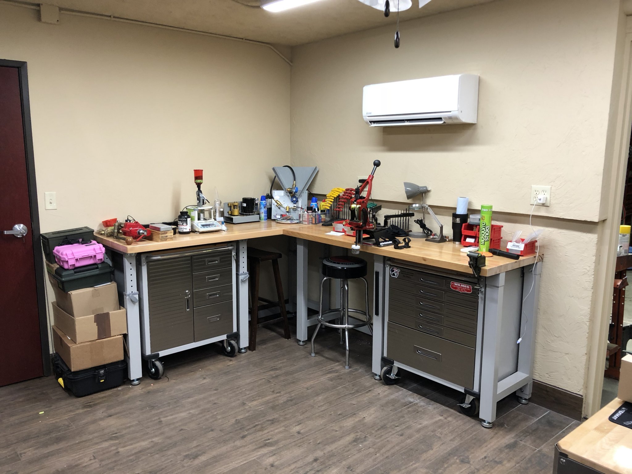

I’m currently using a Forster Co-Ax and an A&D 120i with auto trickler setup to load all of my precision stuff (6cm, 6.5x47, 223ai, 7SAUM and soon 25cm). My time is limited with two young boys so I load while they are sleeping so I can spend as much time with them as possible.
My main goal is to try and save a little more time and making Ome handle pull do three things instead of one like on my coax.
I had good success with loading on a 550 a few years back but hated having to index each time. I never could get a rhythm down and would always forget to turn the cases before pulling the handle.
I would still plan on manually dropping powder from my auto trickler and use the Area419 funnel with extended drop tube probably.
Have any of you used a 650 to load precision ammo before? How did it work out? Would the floating dies/toolheads be beneficial? Any info is appreciated. Thanks.
