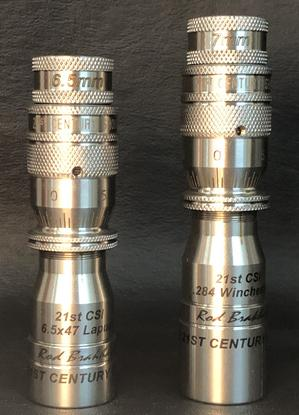

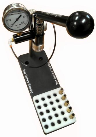

I am putting together my reloading equipment for a .338 Lapua Mag. I am interested in the community's opinion and I am very open to suggestions. I want to have precision reloading equipment that will allow me to assemble ammunition that is incredibly precise. I enjoy the reloading process and I plan to develop ammo for my rifle so I can them compete in various matches.
I have some equipment already, but I plan on piecing all of this together and then writing about it and documenting my reloading process. At the end I hope it will be very informative and also can be easily adapted for new shooters, or anyone that may be reloading their own ammunition.
My first task is to determine the absolute best way to seat bullets. I'd like to get your thoughts on the following equipment for this process. I'm really interested in hearing your opinion and if there is a better way, or better equipment to achieve my goal of incredibly precise ammunition for extreme accuracy.
I'm interested in the 21st Century Hydro Press. For the bullet seating dies, I was looking at the 21st Century calibrated bullet seater.
Would this be the most accurate setup possible and is there any other equipment or manufactures that I should be looking at?
Is all the money you spend to be incredibly precise going pan out in results from precise enough?
If you have an ok press and decent seater like a Forster that commonly get people excellent results are you going to actually be able to shoot the teeny tiny difference?

The hydro press maxes out at 100 PSI of seating pressure. It leaks if you go over. I used it to load 300WM and can tell you that it won’t work well in the 338. You will have leverage issues, excessive seating pressure issues, clearance issues, etc.
That is not good news! This topic is already paying off. I'll be skipping the hydro press.
