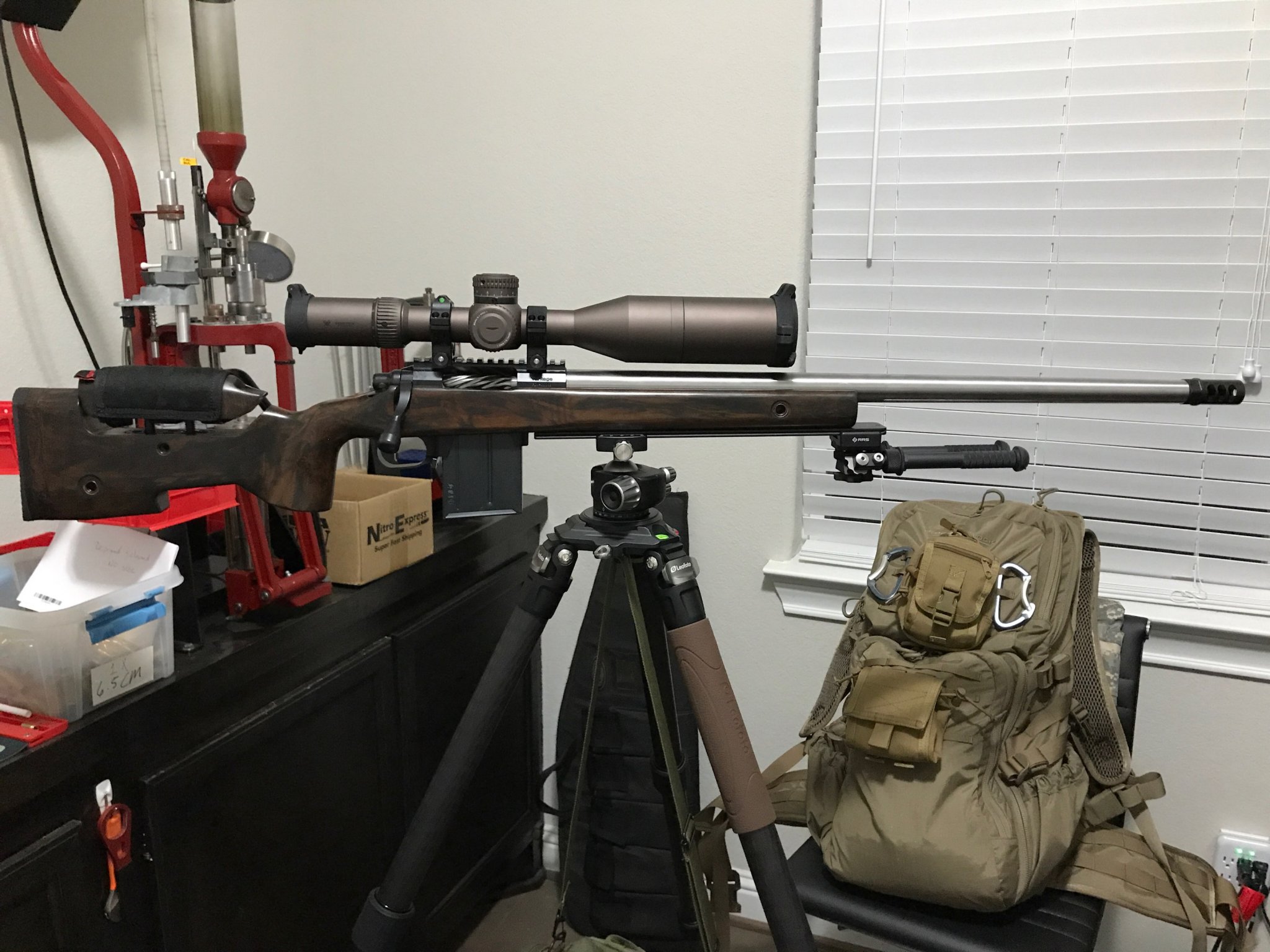

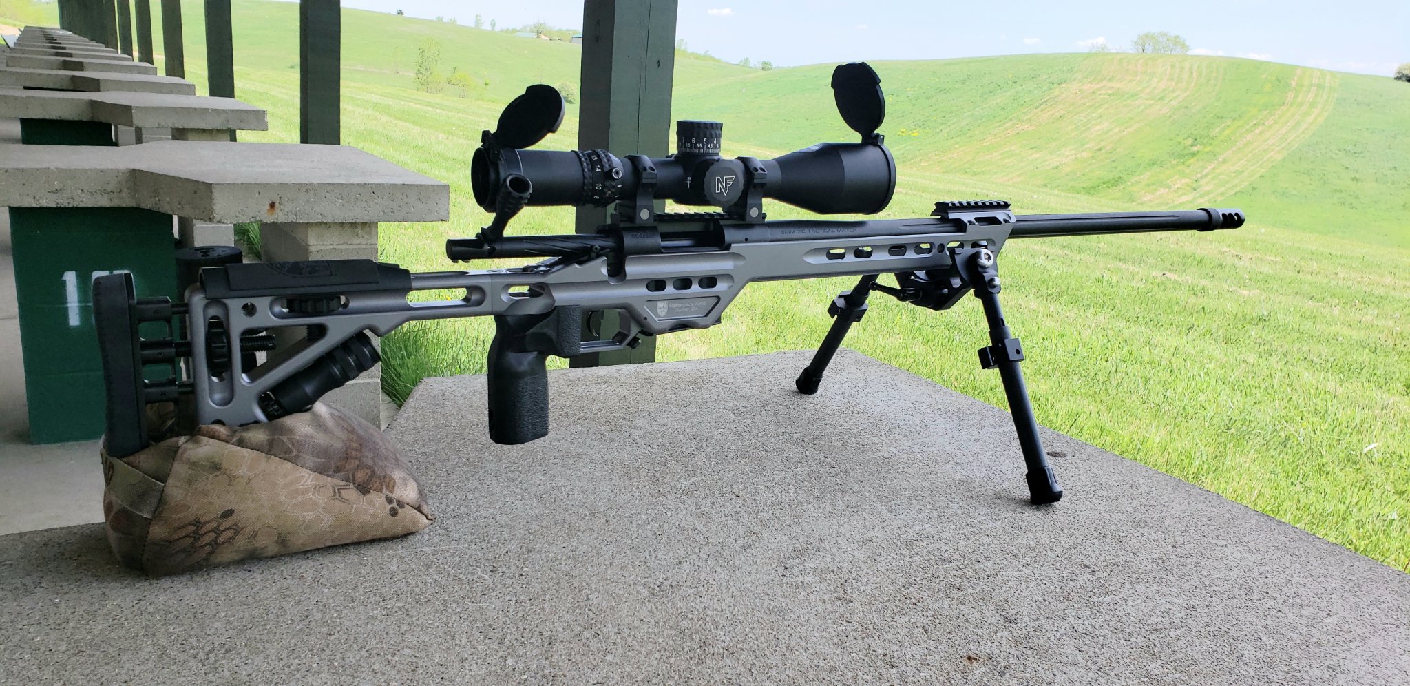

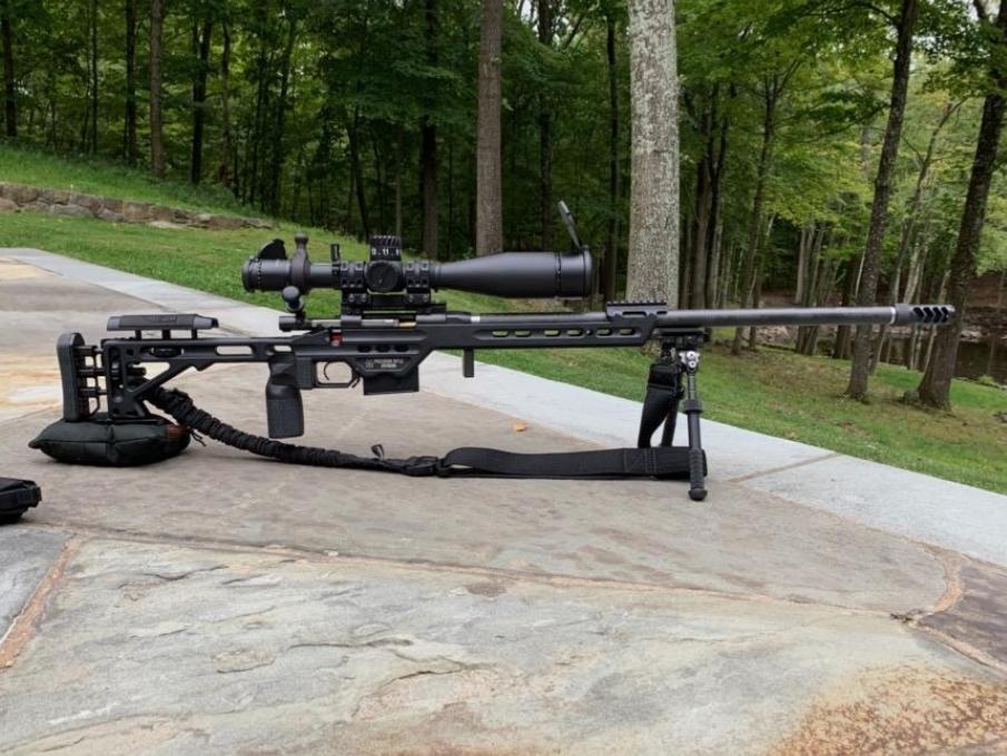

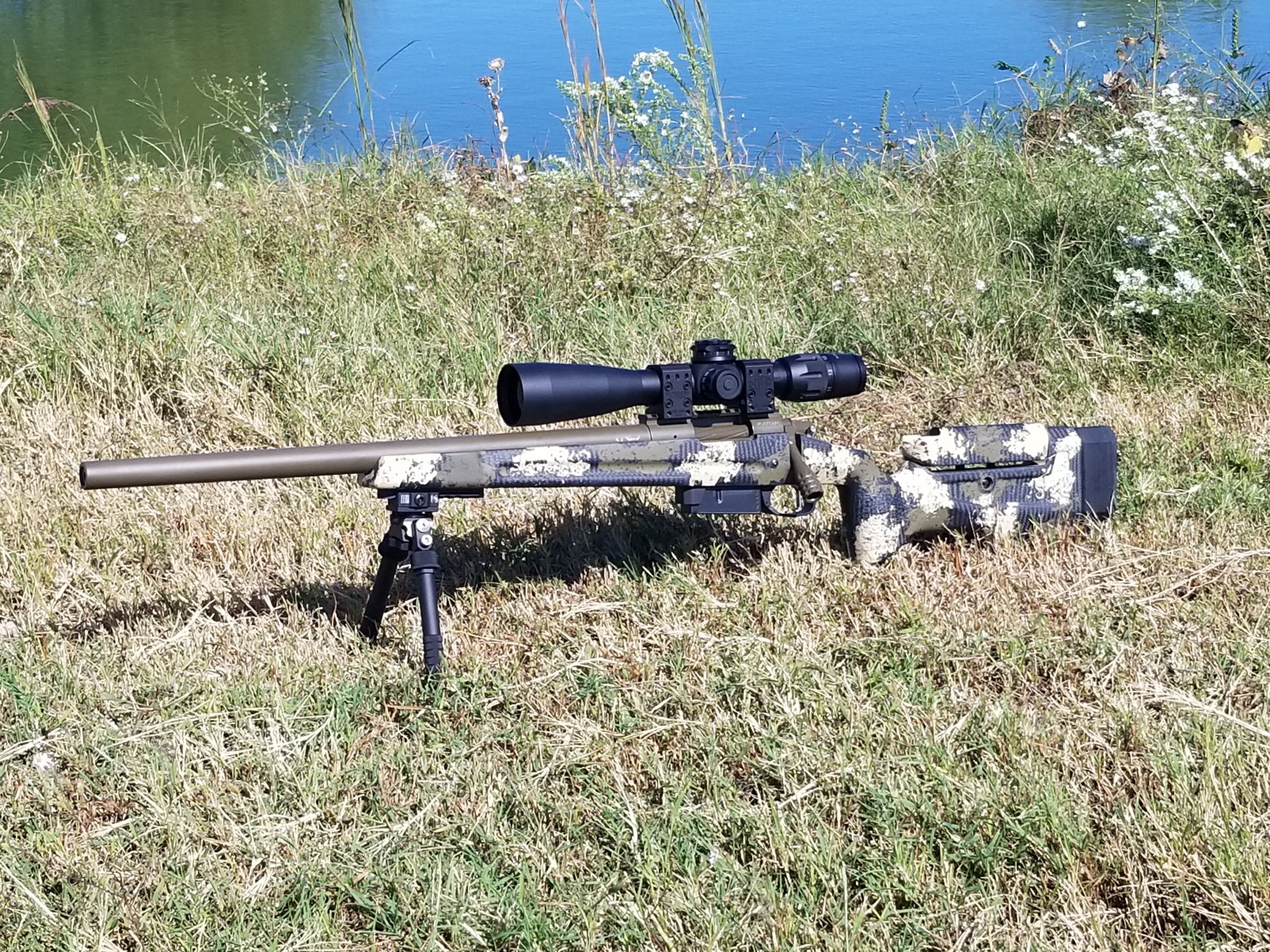

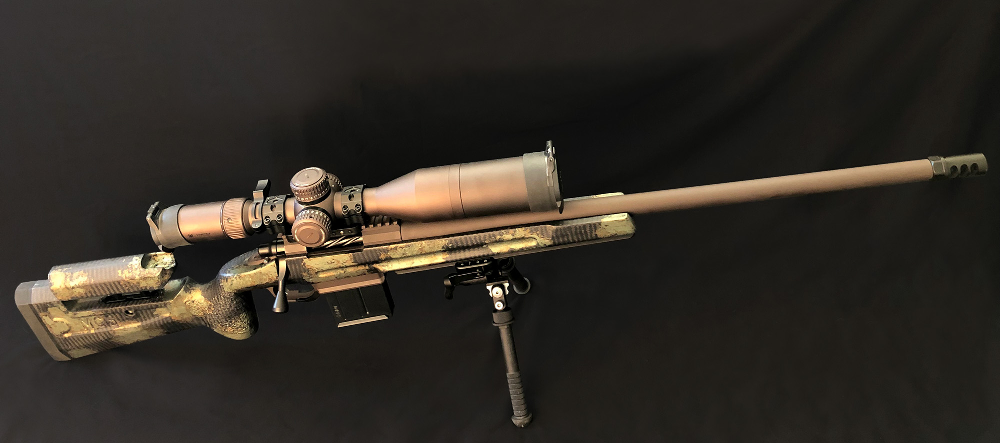

My McMillan Tac.308. Was going to sell her but couldn’t so I put new furniture on it. Still have to get her cerakoted tan.

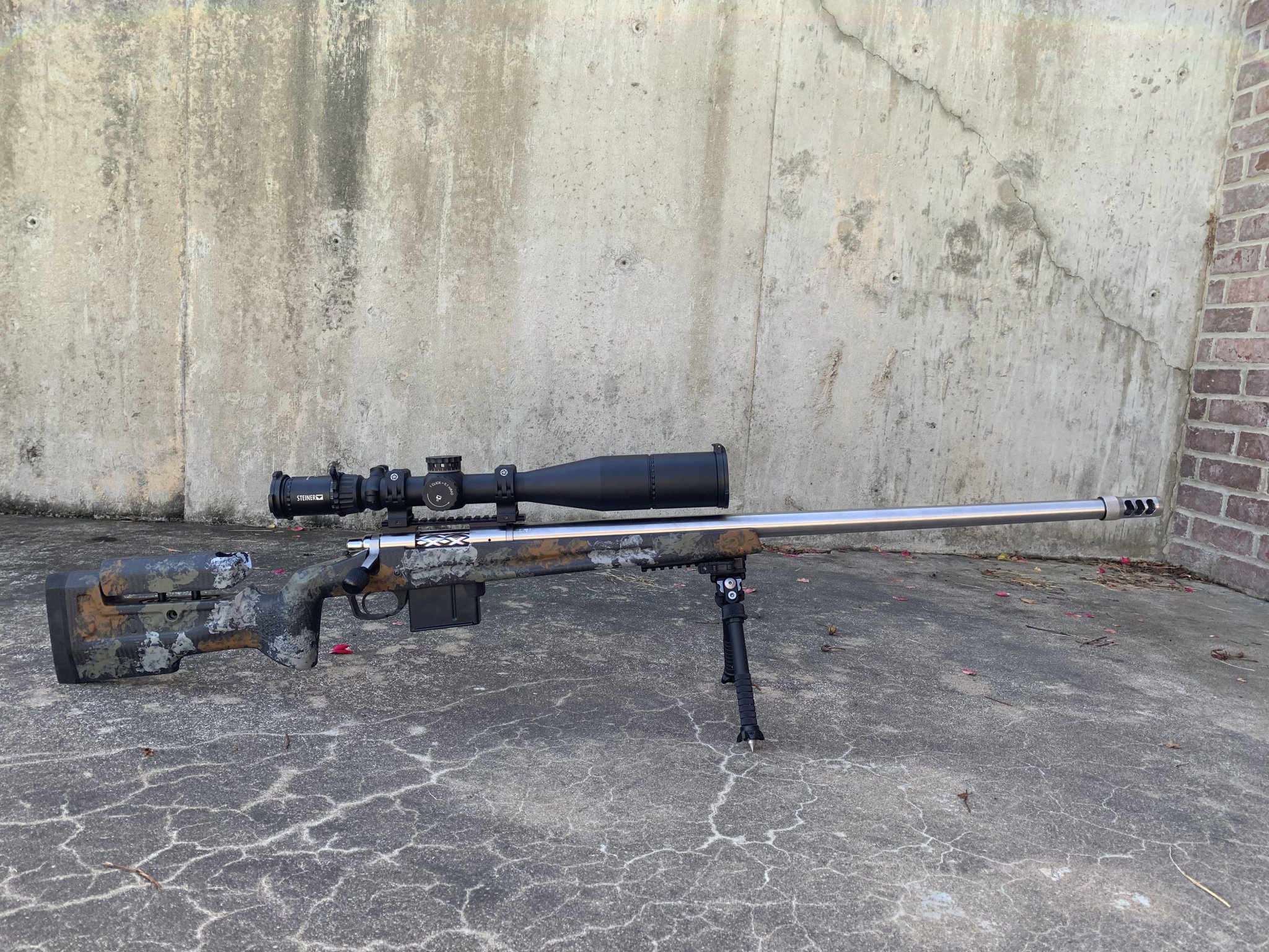

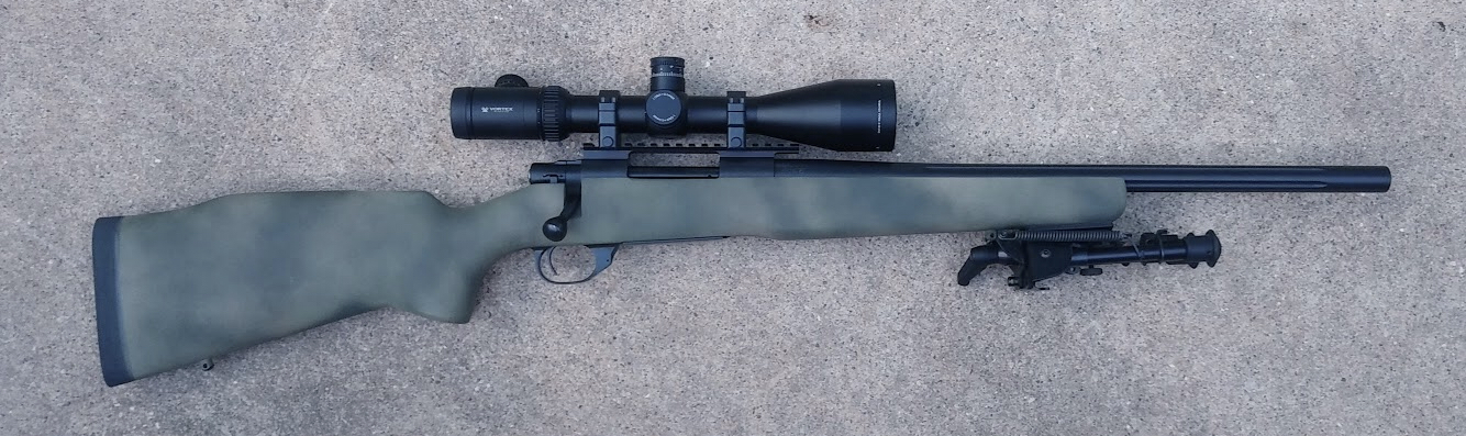

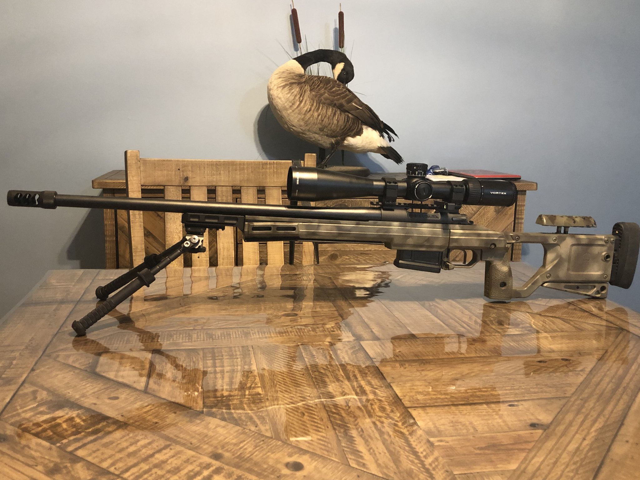

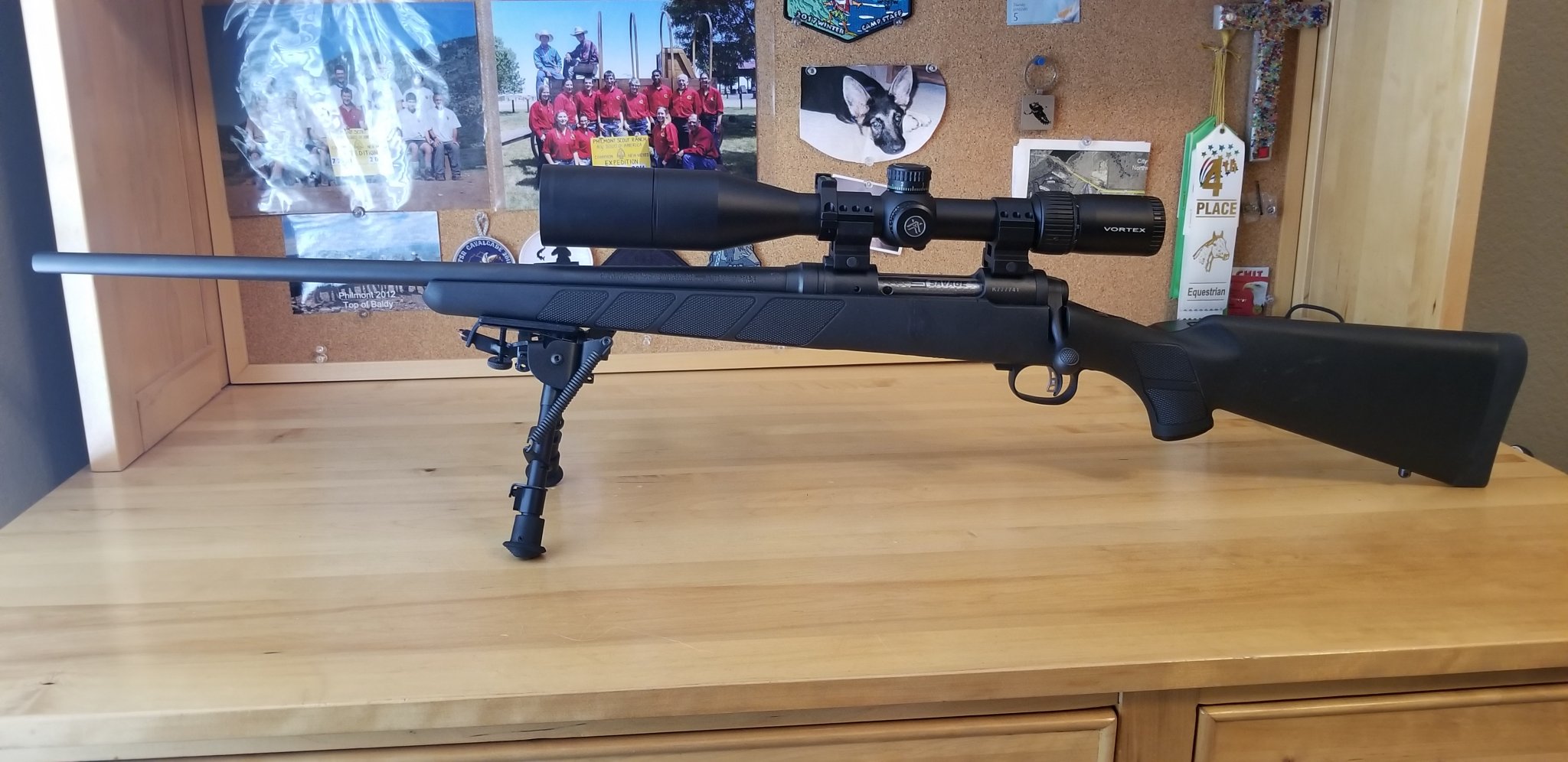

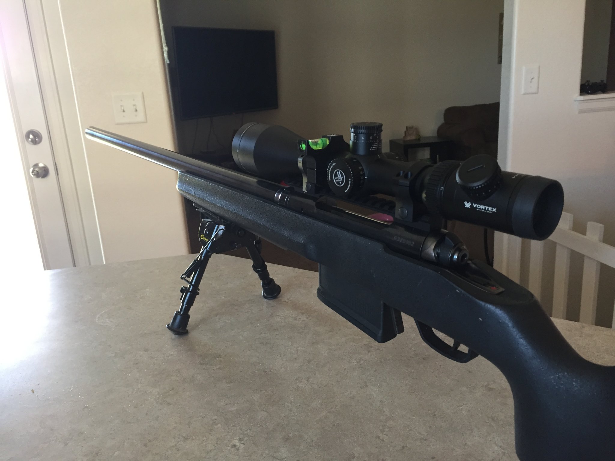

Savage Model 11 LH in 6.5 CM
Vortex Diamond Back Tactical 6-24x50
Harris Bipod
Consistently shoots < 0.5 MOA with 140 gr Hornady Black ammo.
Just ordered EGW 20 MOA scope base.
Future Plans:
XLR Element 3.0 Chassis
Shilen Stainless Bull Barrel (may change calibers when I do this)
APA Gen 3 Little Bastard, Stainless
Everthing is subject to change, but that is what I am budgeting for.

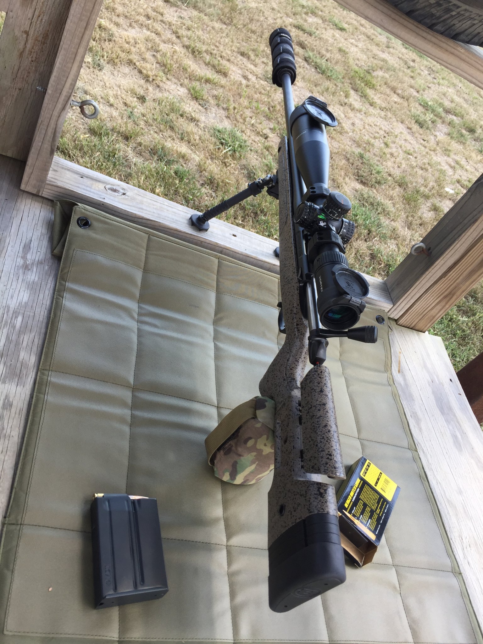

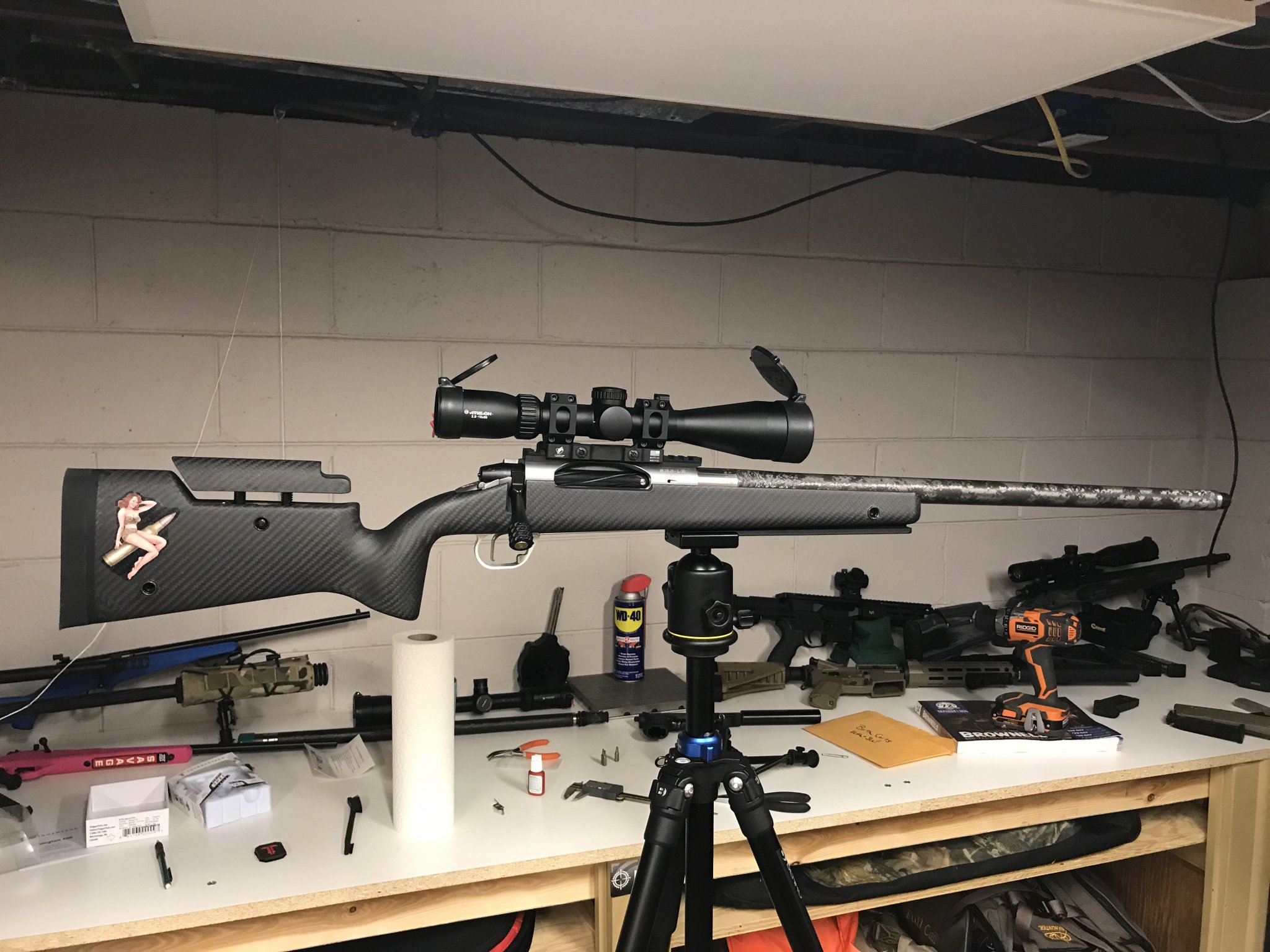

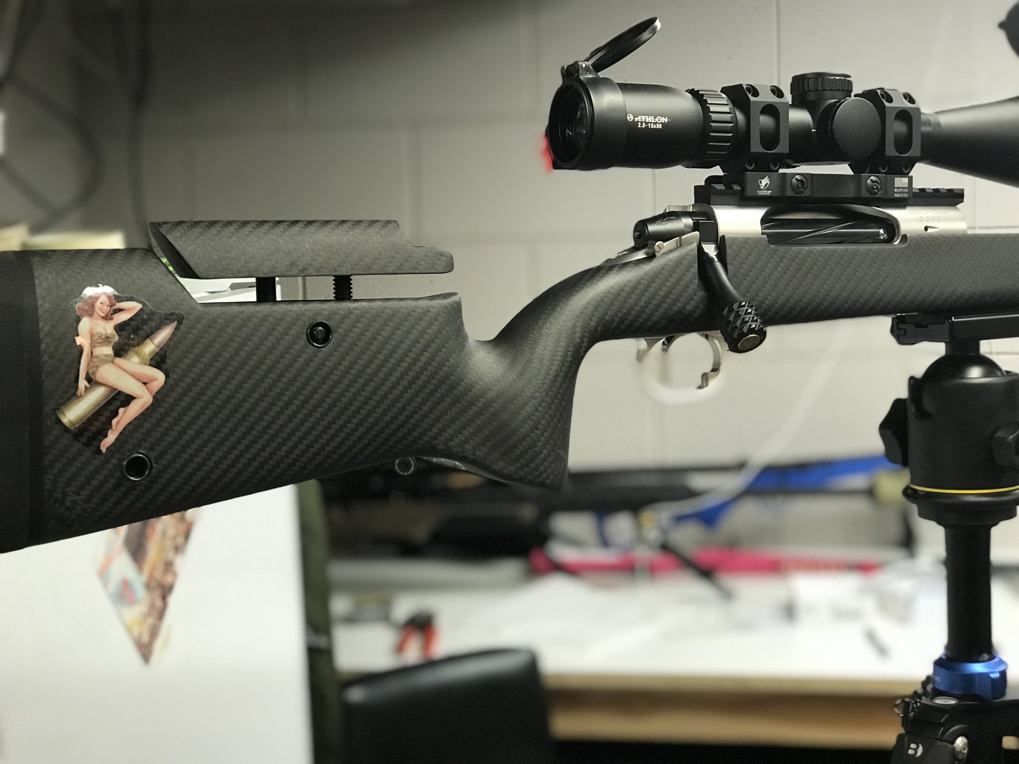

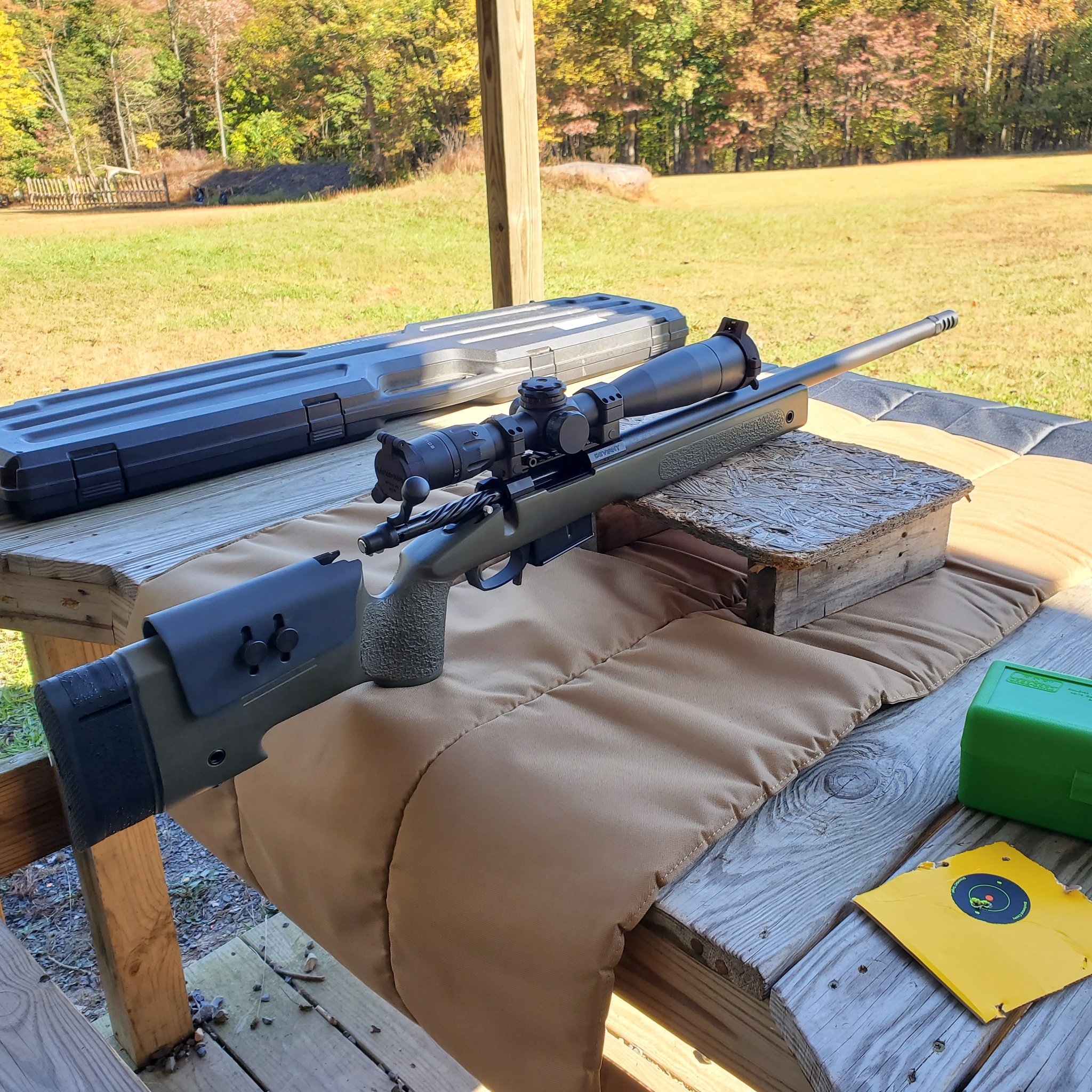

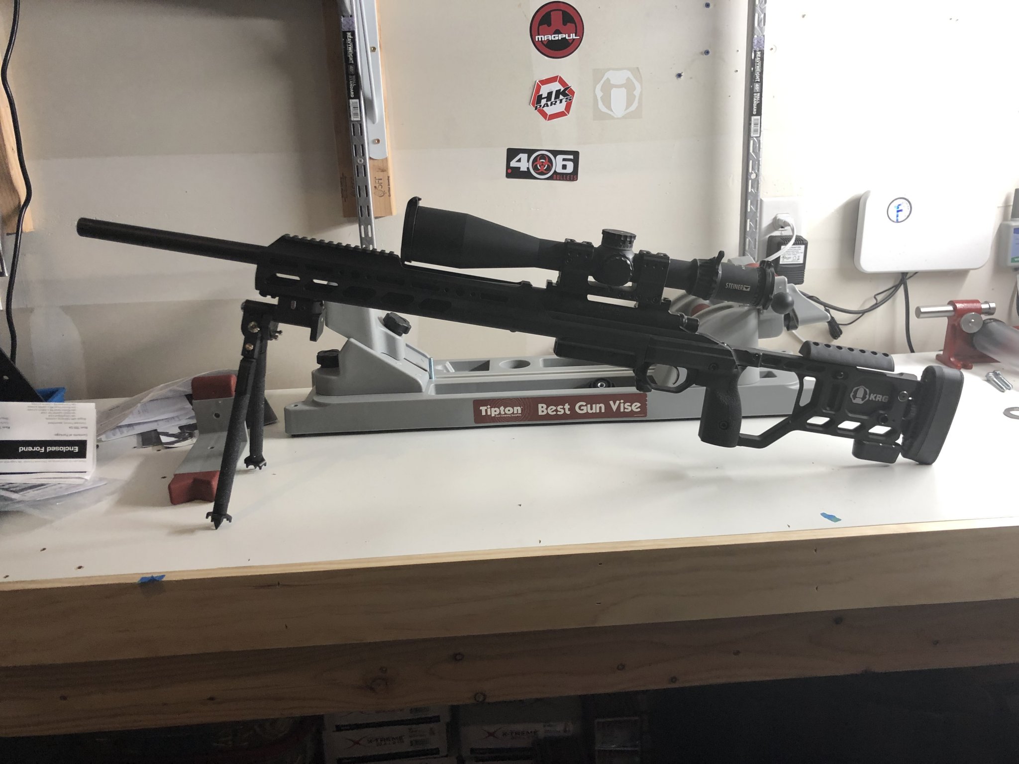

Hey All, Bo Here. Just joined this Forum a week or so back after having taken a class with frank and mile high shooting. Before posting up my build etc a little about myself.
literally bought my first gun a little over a year ago. HK VP9. from there i moved into other hand guns and classes then bought a 30-06 browning FN safari 1959. played with that a bit and then for some reason decided i needed to try my hand at PRS.
so i purchased a remington 700 magpul 22" 6.5 CM 1:8 at cabelas and started building from there. ordered a bunch of parts etc, put it together with a steiner 5x25 t5xi scope. shot maybe 20 rounds and signed up for Franks class with Mike at Mile High.
had a blast there but after decided i needed to up the scope a bit as beyond 800 it was a bit tough to see all things considered. so after the class i purchased the Kahles 5x25 k525i. took that to the range yesterday and zeroed (indoors at 100) it. looks like the gun is shooting great groups.
i took it again today this time with my own reloads. 140g ELD-match hornady with 40.5 g powder. didnt shoot quite as tight but still great and centered.
absolutely loving this sport and look forward to chatting with people here and at the ranges. im starting to consider other courses as well now :)

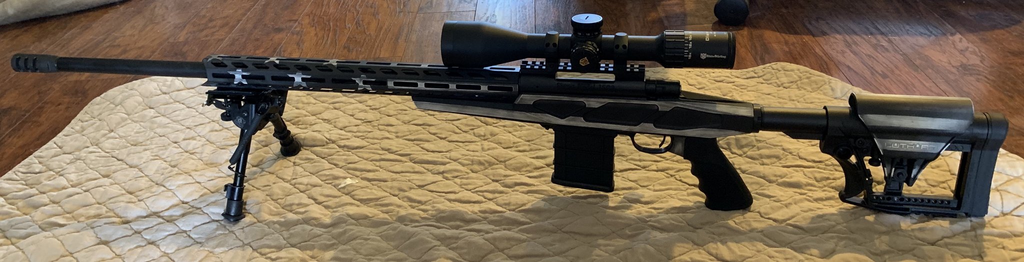

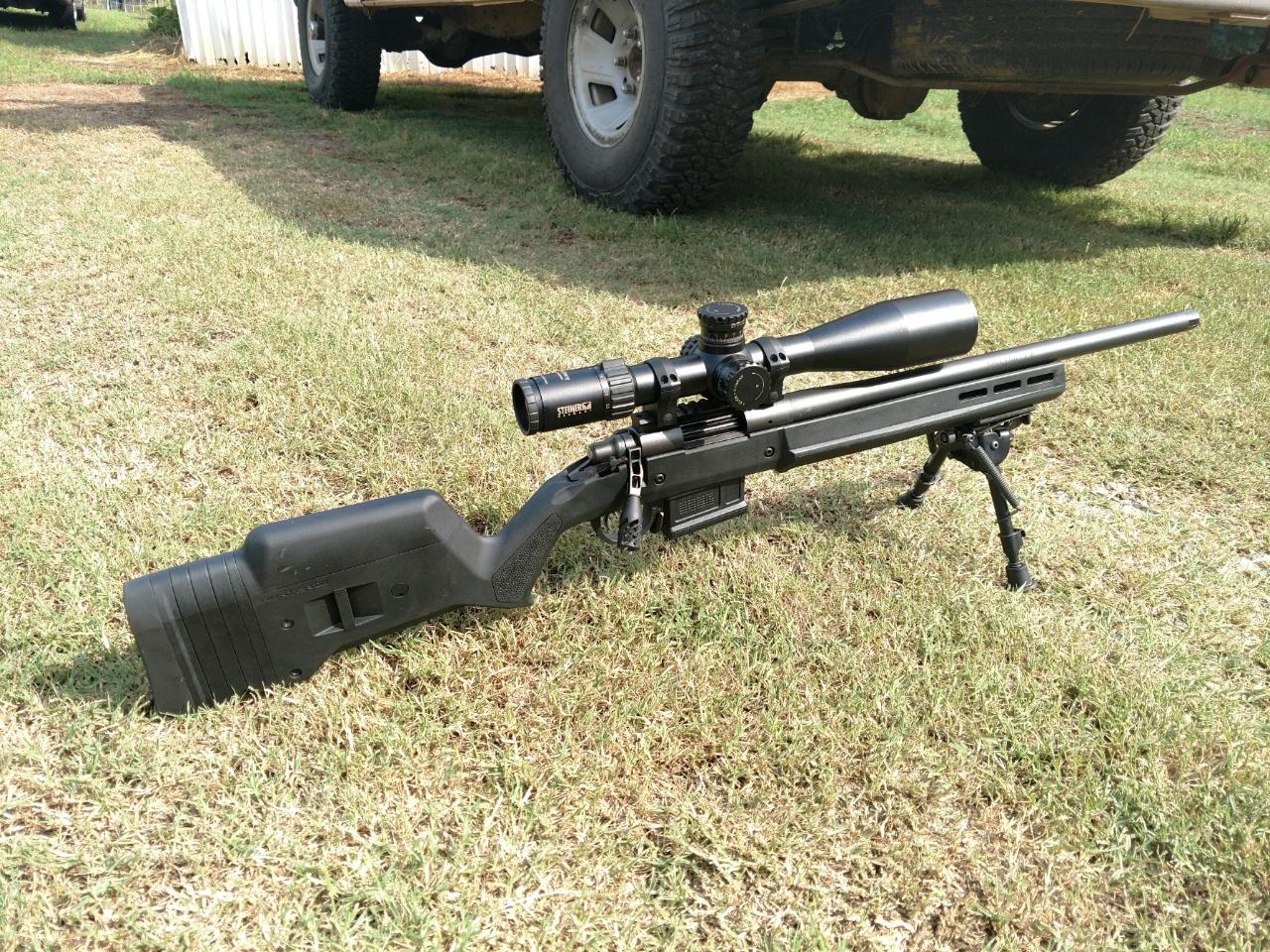

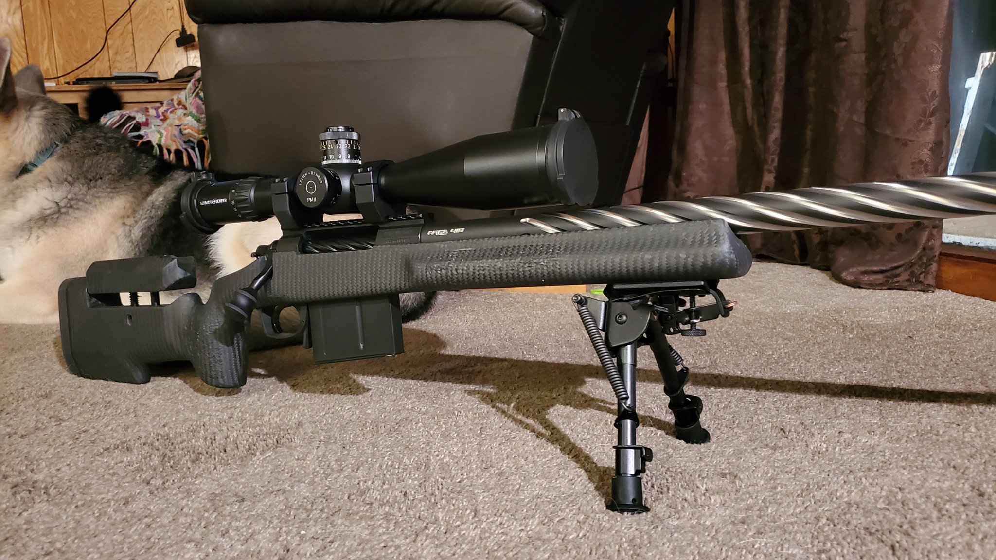

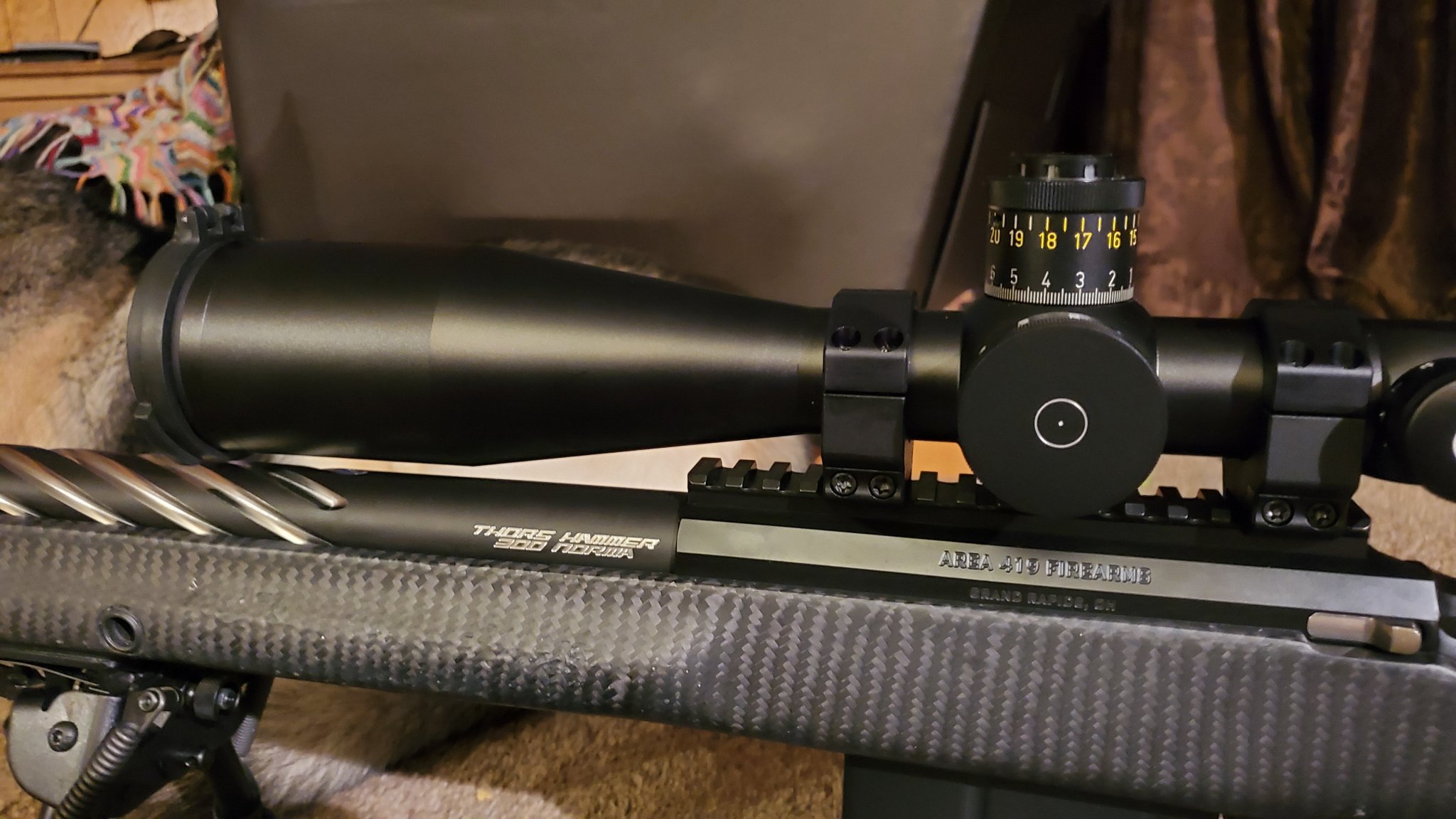

Savage 111, McGowen 24" full bull barrel, 7mm rem mag, tacticool stock (MDT Gen 2 on order) Timney trigger 2.5 lbs, Vortex Viper PST gen 1.
I maintain .6 MOA with it so far. the barrel is too heavy for the stock that it is no longer floated in the prone position. Mile high shooting just threaded the barrel to prepare the way for the Omega.
Had some good times out at Pawnee with that beast! Did you ever sell it?

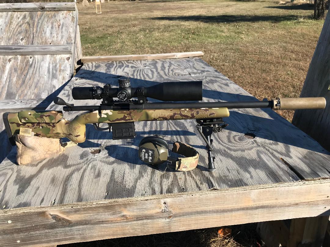

View attachment 6917282View attachment 6917283View attachment 6917284
Noticed that the 1st picture appears to be a Foundation Stock; if so, how do you like it? What is your experience with it? I am thinking of getting one, but wanted to see how others like theirs before making up my mind. Thanks.
Love my foundation. I’ve been running it for a year now favorite stock/chassis by far they just feel great. Actually about to start another impact/foundation build here soon.

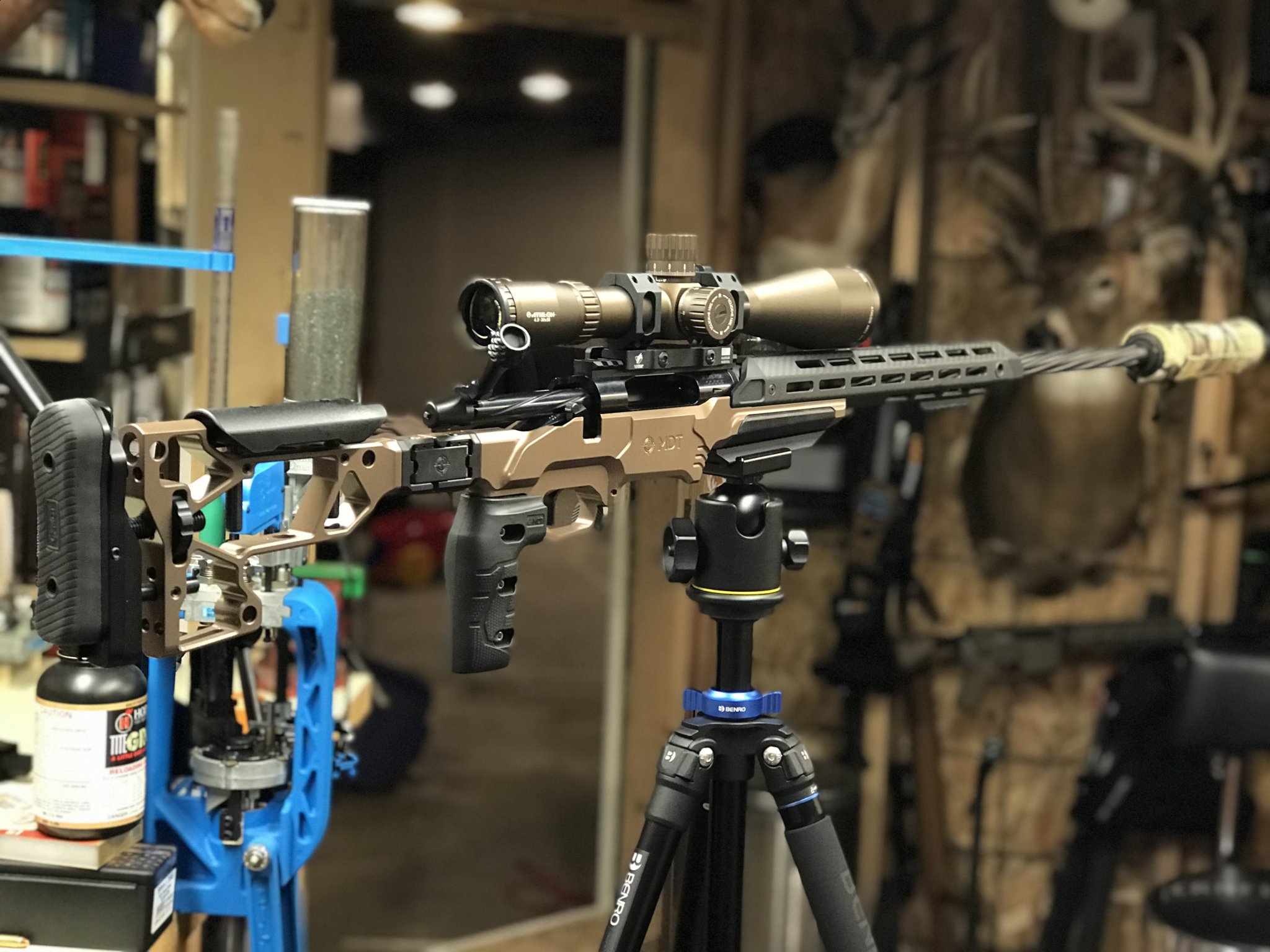

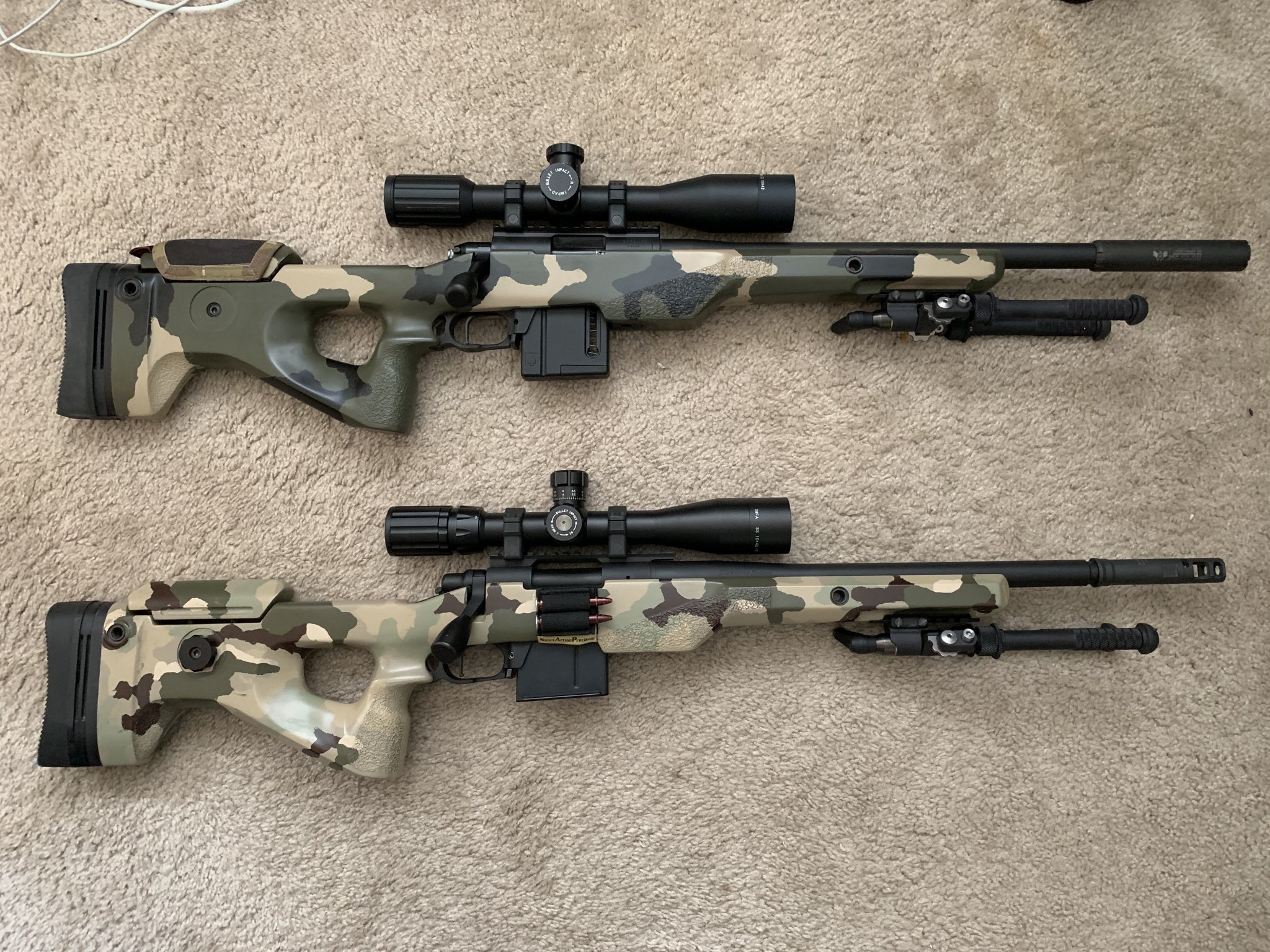

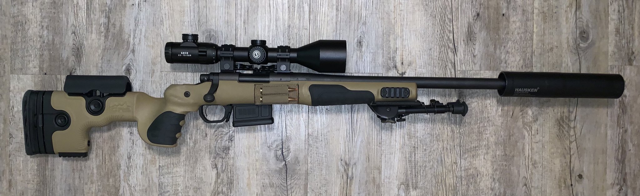

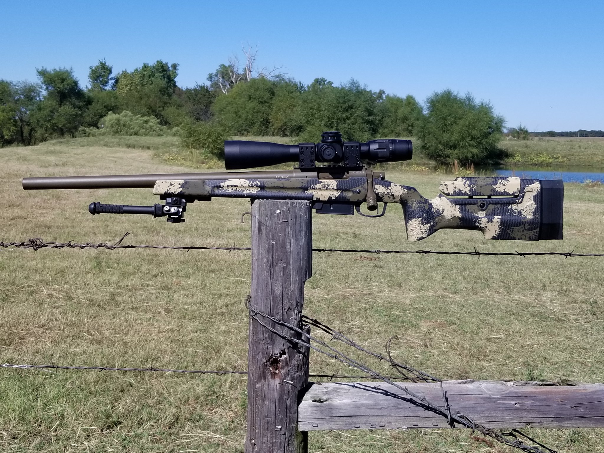

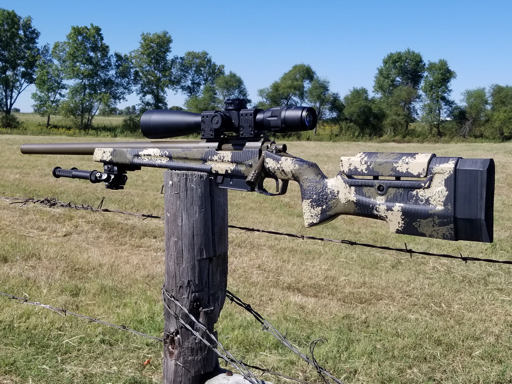

Tikka T3X action.
Krieger SS 6.5mm creedmoor 8"/4 barrel 24".
KRG Whiskey chassis, folding rear stock, spigot mount, and overmolded cheekrest.
Ase Utra SL5i suppressor.
Coletac metal phyton suppressor cover and 2-ammo holder.
Sterk swept bolthadle and titanium bolt shroud.
Spuhr ISMS scope mount.
Vortex Viper PST gen II 5-25x50 mrad ffp scope, with MKmachining goodies.
Atlas CAL gen II bipod, monopod.
Riflestick quick connectors and Boscabel titatium spike feets.

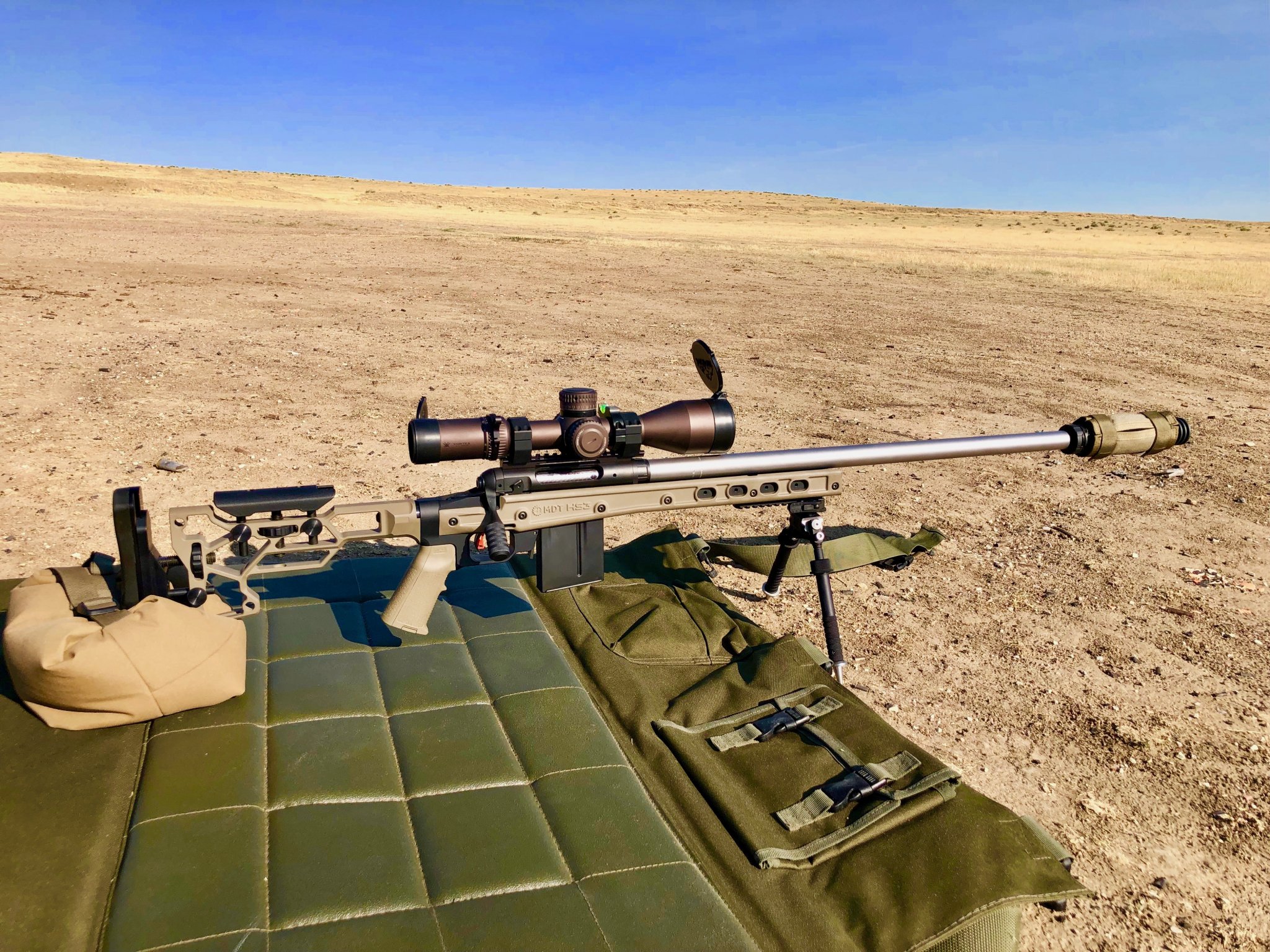

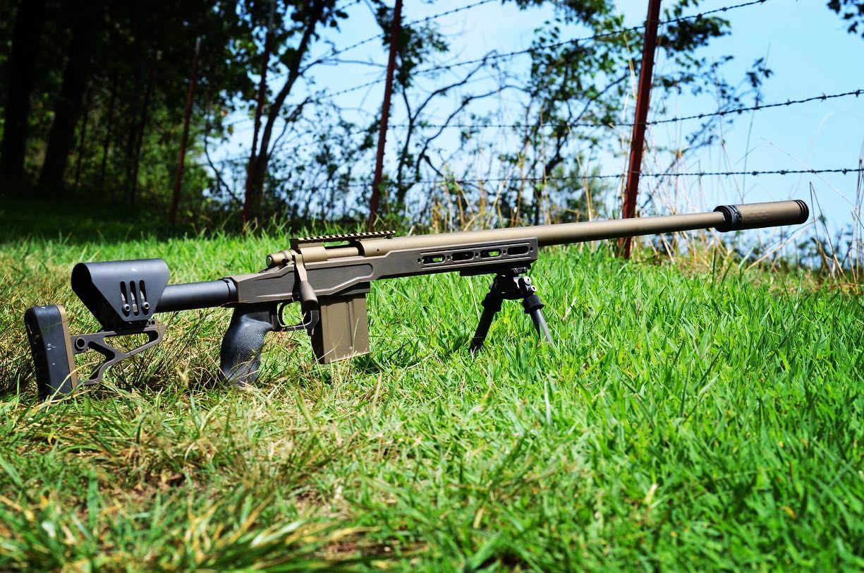

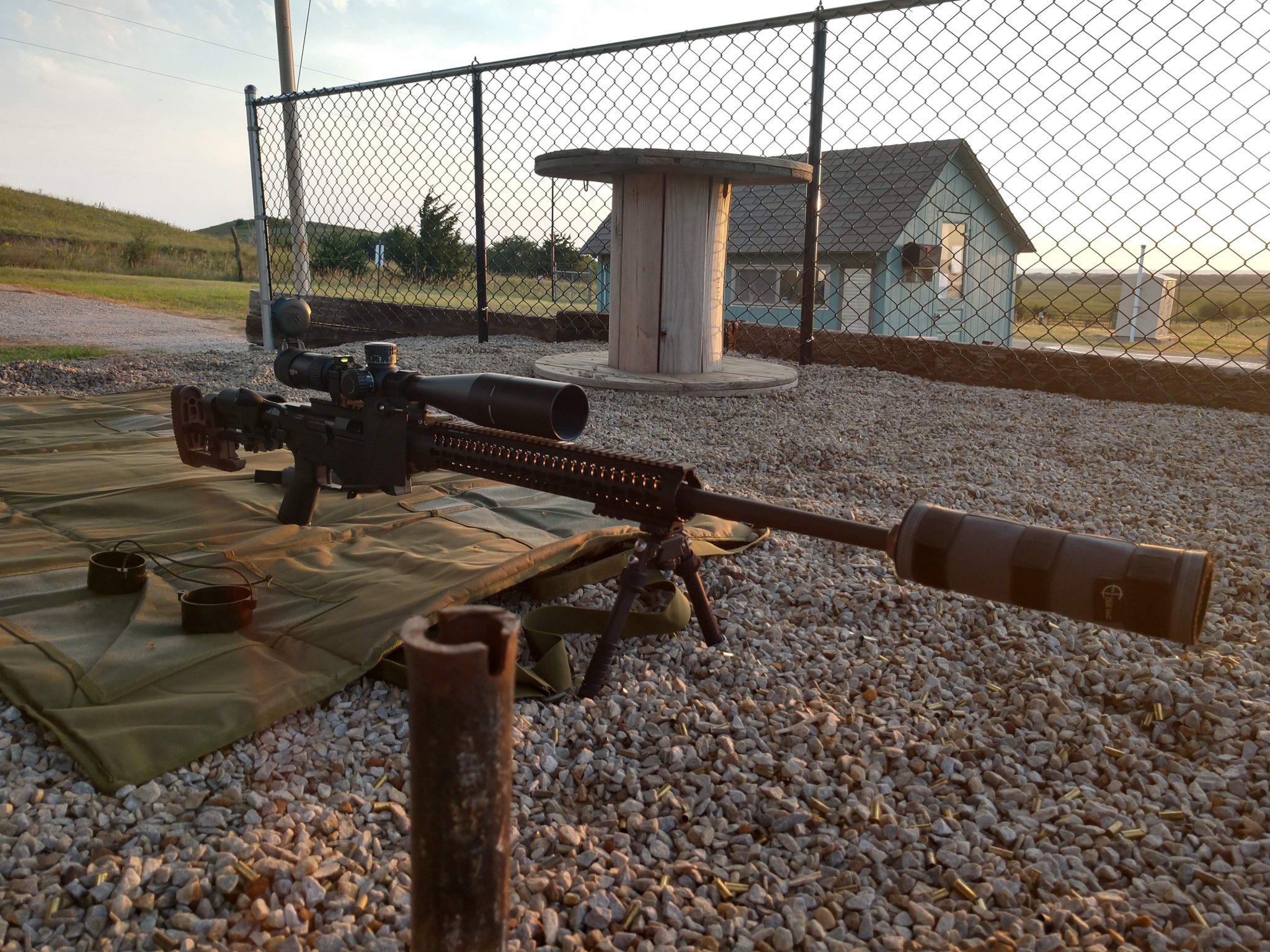

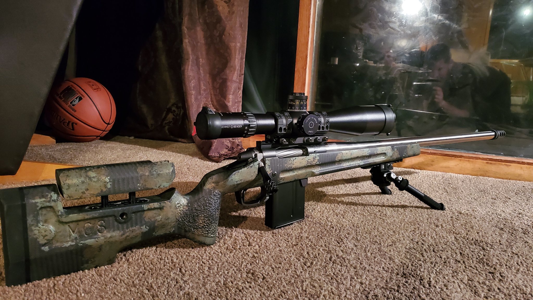

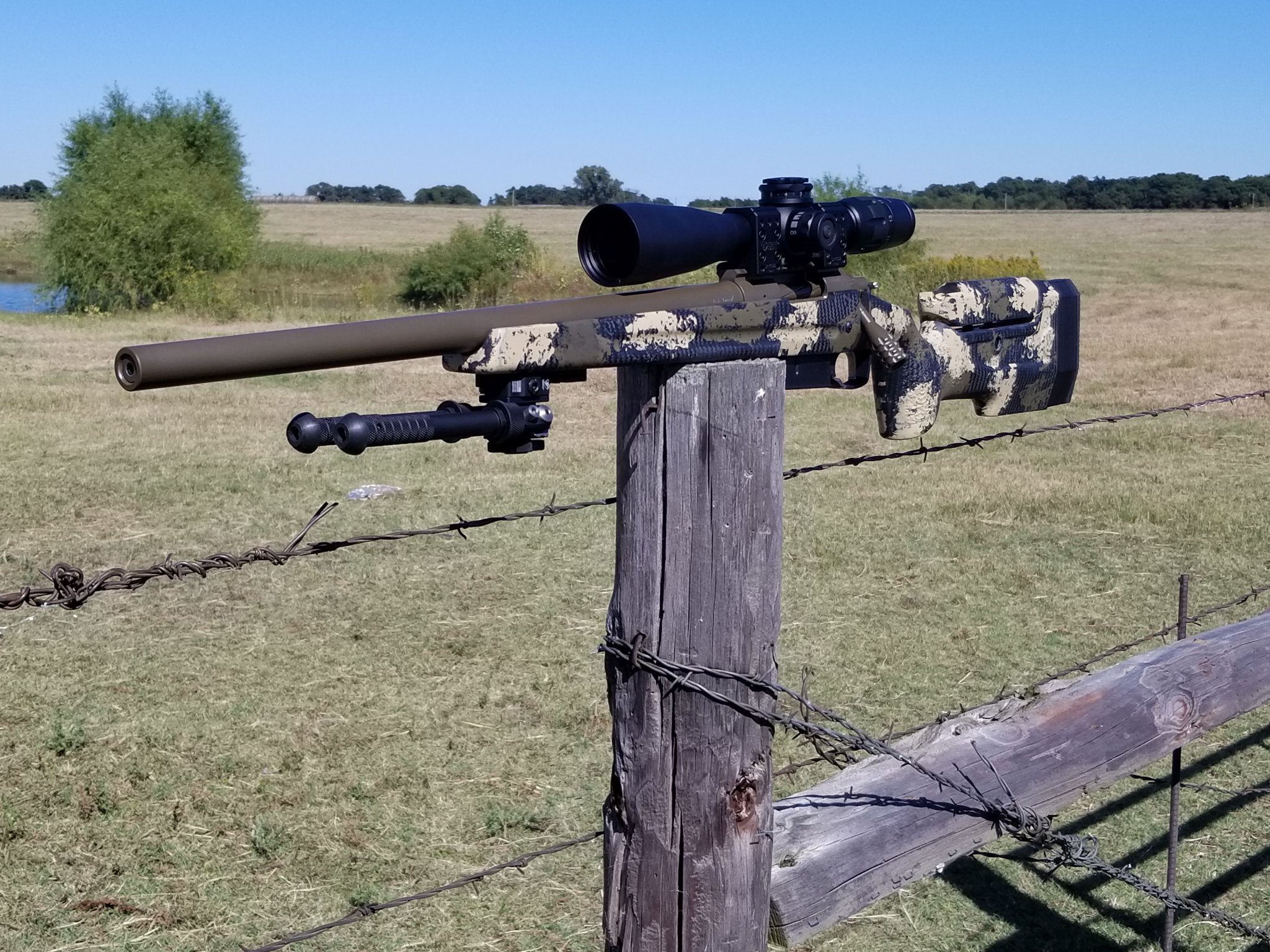

This one started life as a Savage Model 12 LRP 6.5 Creedmoor and morphed into this. Only thing left is the action. MDT HS3, Criterion pre fit 26" Bull, Atlas bipod with spikes, EGW 20 MOA Base, Vortex Razor Gen II 4.5x27, Seekins Rings, Silencerco Omega. Pushing 147 ELD-Ms at 2720 ft per sec with 41.2 gr of H4350. Been hitting consistently out to 1175 yards and waiting on a friend to open his private range out to a mile.
