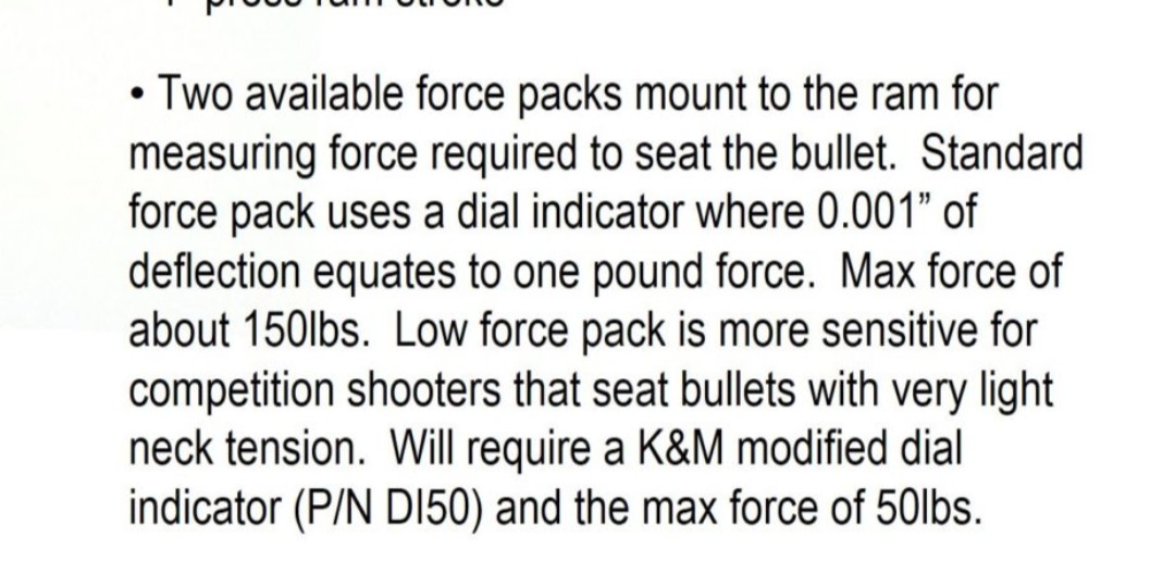

Have been trying to research the K&M arbor press with force pack and the Micron seater die. What's the difference in standard vs low load pack?
Look at the product manual for the press:
Any insight as to a comparison of the micron inline seater vs wilson

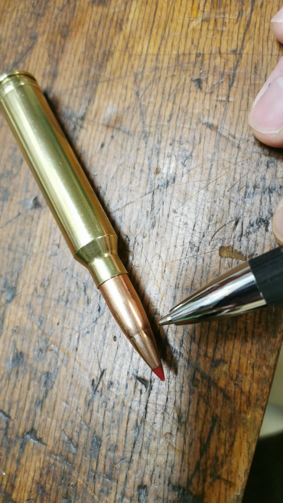

Set up my new 300 WM in line seater, and wanted to initially seat the entire batch a little long, so that I could go back and reseat to exact length.
But the bullet (Hornady 208 gr. ELD-M) wouldn't go into the case. There was no way for the gimpy handle on the arbor press to push the bullet in. I took everything out and apart and checked that it was indeed 300 win mag parts, and the die was the (expensive) optional VLD stem. The bullet just wouldn't do into the neck mouth.
I took the sizing stem out of the neck sizing die and it measures .3065", but it is the same one I ussd before when seating with the RCBS die in the rockchucker, so I didn't suspect that as the problem.
My suspicion is that the bullet is getting so accurately lined up with the neck, and not "slightly sideways twisted in" that it took a little more force to get past the initial penetration. So I tapped the top with a plastic mallet to get it it initially penetrated, the the rest slid in very smoothly (there's a joke in there somewhere, I'm sure) with slight pressure on the arbor press handle.
The only thing wrong is that the seating stem has deformed the bullet. Photo attached, if it works.
Either it's been doing this forever, but I haven't noticed it because of the pressure used with the rockchucker, or the pin tumbling might be mushrooming the necks. But..... i recently loaded some 30-06 brass using the new inline seater, and it was all OK,. The only difference was using a Nosler Partition, which theoretically should be harder to 'penetrate' as it doesn't have a boattail.
Photo didn't work.
