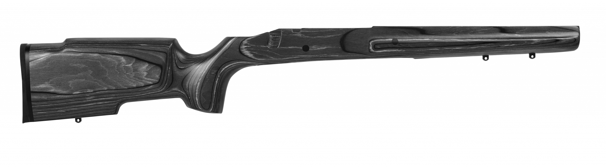

One that caught my eye yesterday was the Ruger Hawkeye long range tactical stock - it appears to be only a factory option, and only for the 77 action or rimfire, but the profile and basic functionality checks the boxes I'm looking for I think - nice straight forend and bottom of buttstock, vertical pistol grip, adjustable LOP and comb height. (Note, those adjustments don't need to be on the fly adjustable; removable spacers etc is fine.)
Do any of you know of a similar stock from an aftermarket company that looks like this for the RAR?

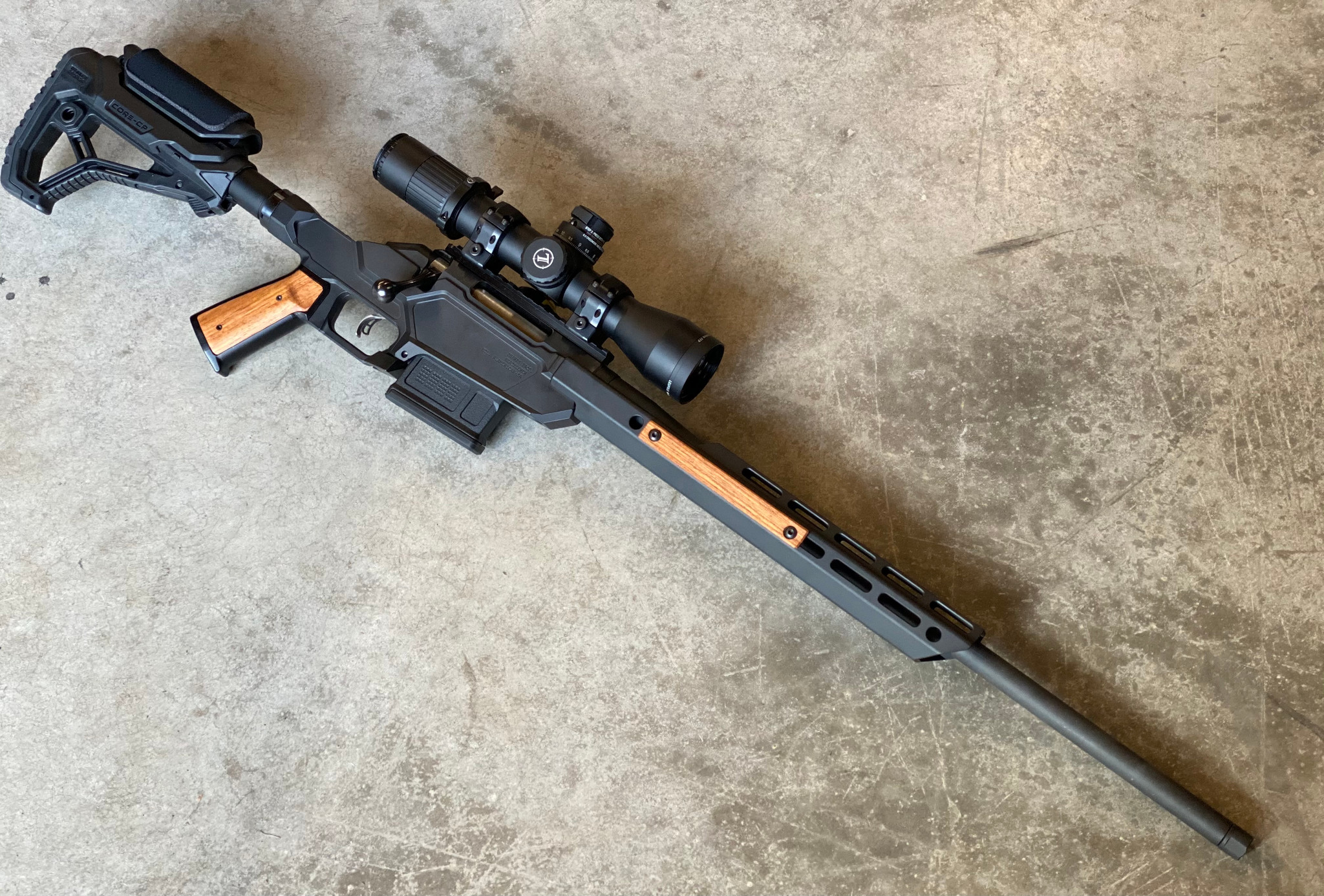

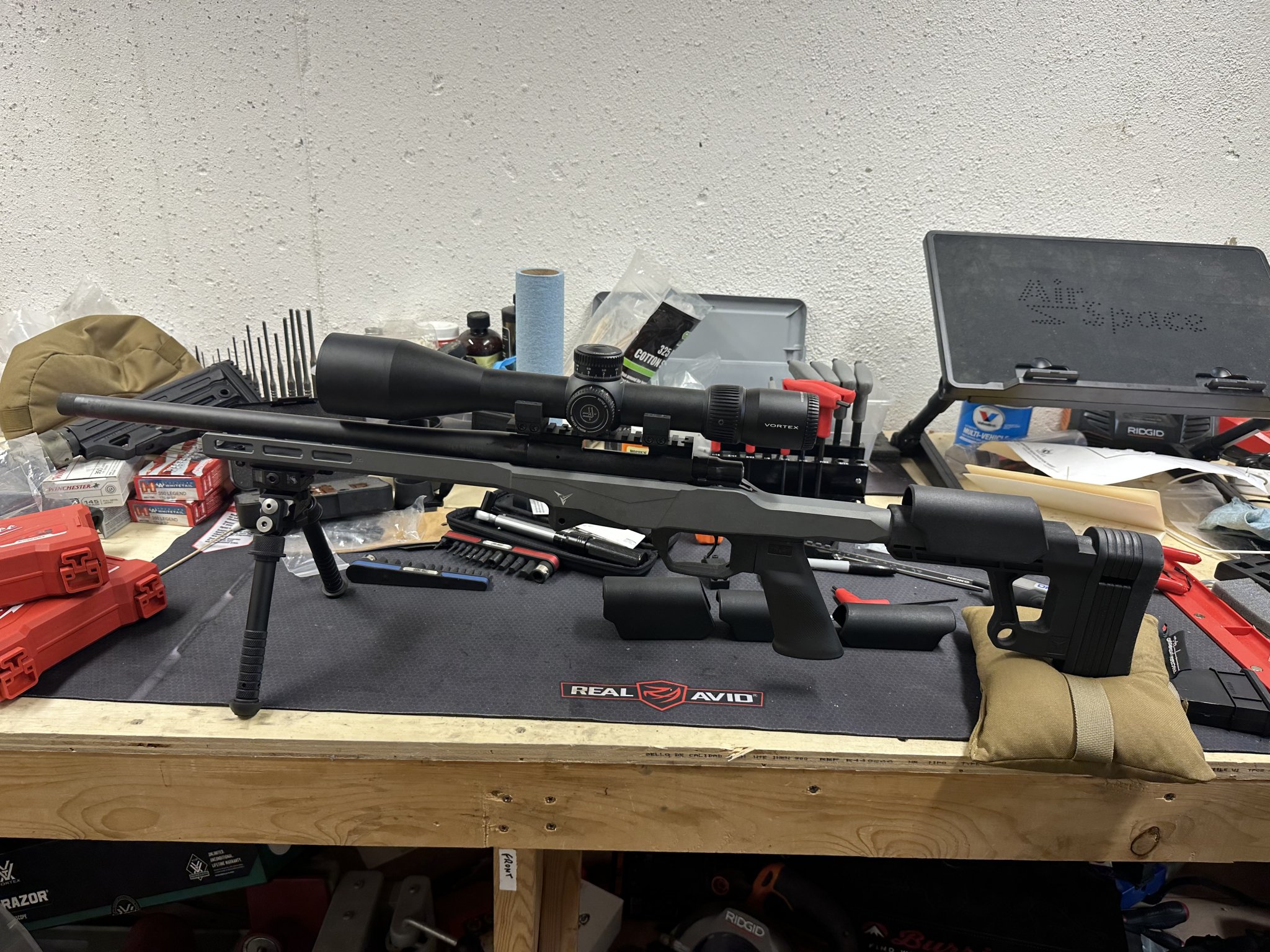

I just got one of these myself for my Howa, to use as a cheap hunting setup. Pretty sure it’s made by MDT. The shoulder pad even says MDT on it.
Hell of a deal for $270 OTD. Pretty decent honestly. Cheek rest uses clip on pads, so it’s not super adjustable but it comes with 4 different sizes so I’m sure you could make something work.
LOP uses MDT shims as well. Rear stock assembly is not replaceable like other Mdt products. I’d say this is a step below an oryx. Reminds me a lot of the chassis Savage comes with (also made by MDT)

Interesting find, thanks; I hadn't seen that. Looks a lot like MDT's LSS chassis but without the cheek rest adjustment. I think I want that, which is my main drawback on this one.

I found that dvor sale as well, about a week after I bought mine and posted about it in here lol.
It’s even a better deal at that price.

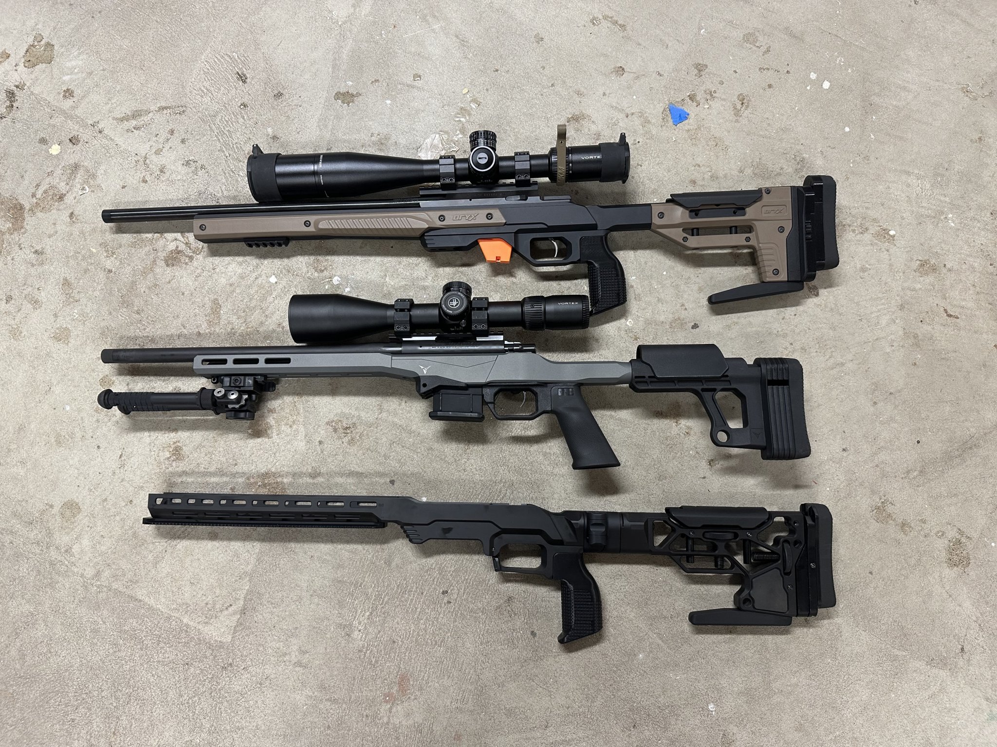

I would say it’s more like an Oryx than an LSS XL, but maybe this photo will help more?
You can see in my photo here:
Mdt Oryx
Trybe ROCS
MDT LSS XL Gen 2
Also take a look at the savage I mentioned:
The Trybe ROCS looks like the front end of the MDT savage chassis, and the rear end of the MDT oryx.
My Howa weighs in the Trybe weighs in at 9 lbs 11.5 oz, empty mag, as it sits. A smaller scope could probably shed that weight down when more. Ignore how the scope sits, it hasn’t been leveled yet, just sitting there to keep the rings from getting mixed up.
I personally tried a KRG Bravo, I prefer the feel of the MDT chassis with more aluminum than plastic, but these are subjective things.
I believe the mdt oryx weighs about a pound more than the krg bravo, with the Trybe right in between the 2 at something like 3.7 lbs so I guess that may be important to your overall build type, depending on the weight of the action and optics.

Thought I'd follow up on this thread with pics of what my son and I came up with. I bought a lightly used MTU profile Schneider 6mm barrel (1:7) here on the hide that was previously set up for a Rem 700, re-threaded it to fit the American with a shouldered profile and chambered it in 6 GT. Made an experimental brake/suppressor mount for it too that turned out pretty well I think; it's hogged out of a 1.5" bar of 17-4 stainless and heat treated to H900.
We dropped it into the XRS chassis I mentioned above, bedded it (probably didn't need it, but I prefer to bed all my rifles) and topped it with a Burris XTR II. It ended up at 17.0 lb all in; plenty of weight there for what we need. I'm actually considering another lighter version too, now that MDT has their Field stock and I picked up a Sendero profile 6 GT PVA barrel; just need another American action to go with it.
I do like this XRS chassis, seems to be a pretty decent setup for the money with a lot of flexibility in what can be done with it. If anyone wonders about barrel diameters, it accommodated this MTU profile barrel (1.208" at the receiver on this one) with plenty of extra room in the barrel channel.
My next project with it will be to make a custom upper half for that Harris bipod (no offense to bipod snobs, but I've got no interest in spending $400-$800 on a bipod) that includes the pivot and attaches directly inside the front of the XRS handguard, so it'll eliminate all of the Harris parts from the pivot up, and put the pivot point immediately below the barrel.
My only complaint about the XRS chassis (@MDT_OFFICIAL if you're listening) is that the vertical grip option leaves a gap between the grip and trigger guard. Not a big deal, but very similar to the gap in the same spot on a lot of older AR15 rifles - just one of those minor quibbles that bugs me more than it should. I may switch back to that grip and just fill the gap with some RTV or epoxy, but it'd be nice to have it fit flush straight from MDT.
Also as a side note - as a machinist & gunsmith I do like working on the American action. It doesn't get a lot of love, but is fairly easy to work with once you have a tool to remove the factory smooth barrel nut. I can post some pics of the tools I used for it if anyone's interested. And for shouldered installations for thicker barrel shanks instead of a barrel nut, the flats on the receiver match up very well with the 1.208" shank on this MTU profile.
Anyway, a few pics:
Anyway, a few pics:
