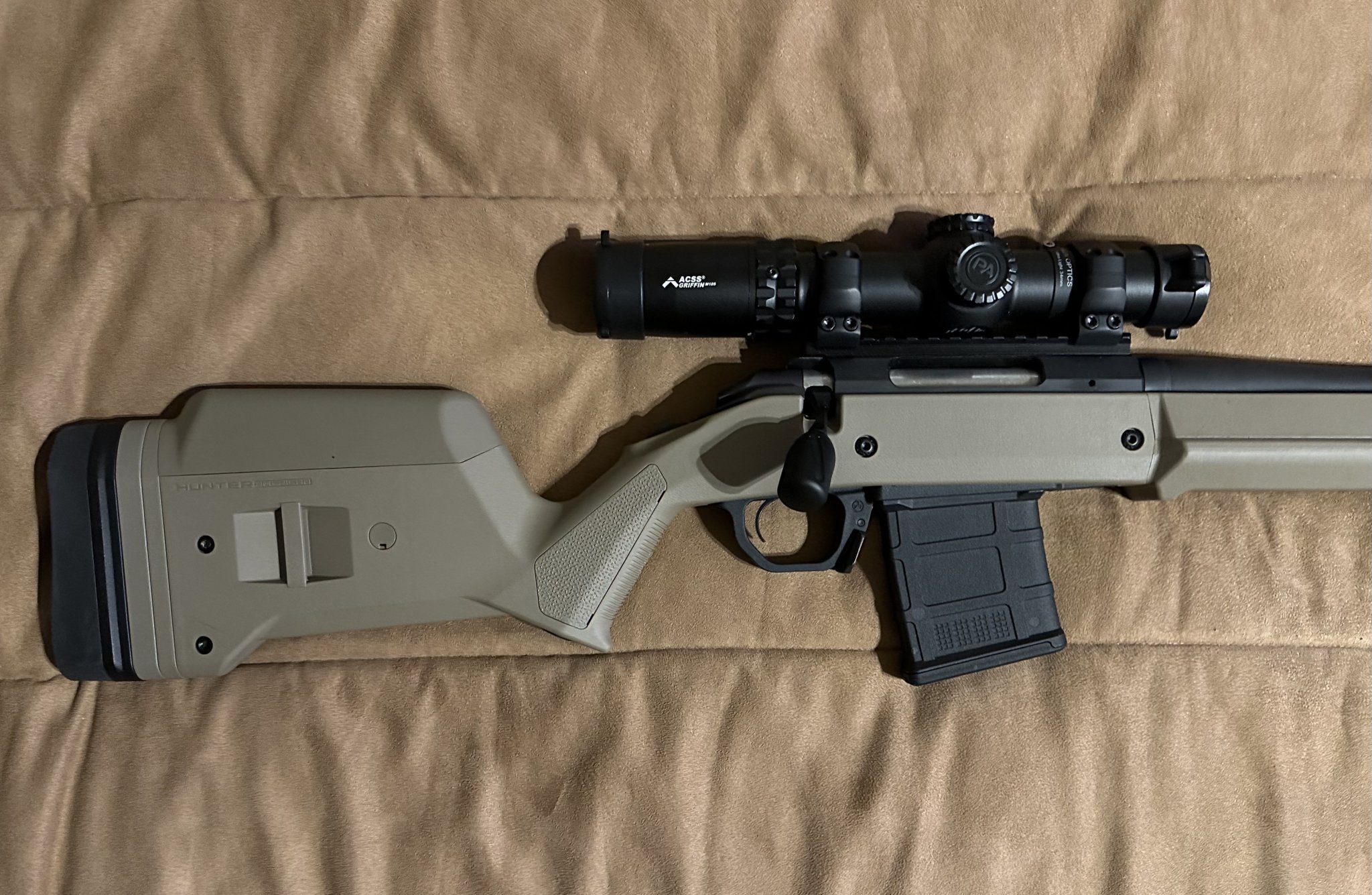

The Magpul Hunter and MDT Field stocks both give you adjustable comb heights. The Field stock is adjustable directly, the Hunter adjusts by replacing the comb with different heights (available in a fairly cheap kit from Magpul).

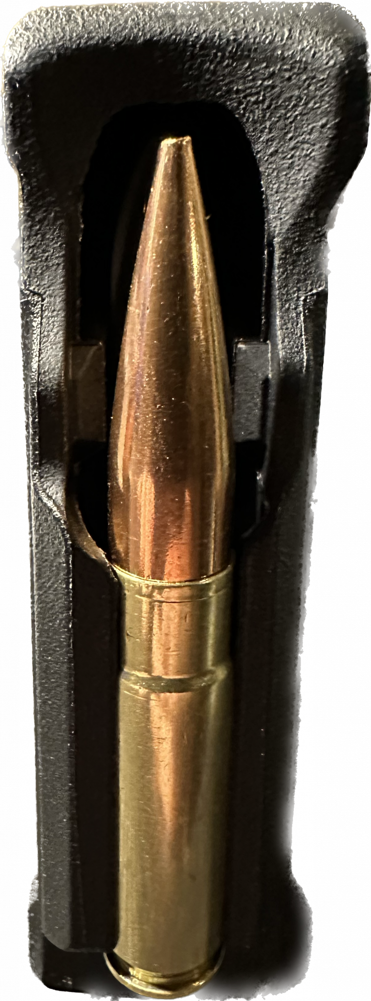

The Magpul works perfectly fine with the right mags… I run the Magpul AICS stock with the Magpul AICS 223 mags for my Ranch .300 BLK. Not a single issue. Also, invest the $150 and upgrade the trigger to a Timney. Worth every penny.

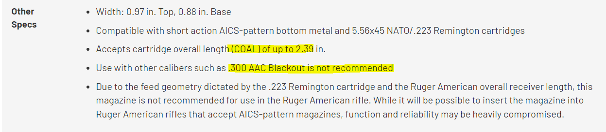

Oooh, good point. The magpul 223 aics didnt exist when I was going through it myself. One caveat is the 2.390" limitation if you want to run some longer heavier 223 load configurations.
I notice that they say its not recommended for blackout but its working for you?

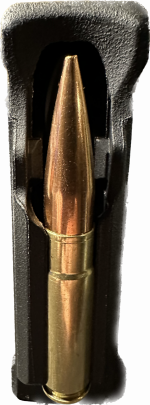

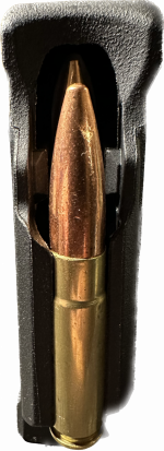

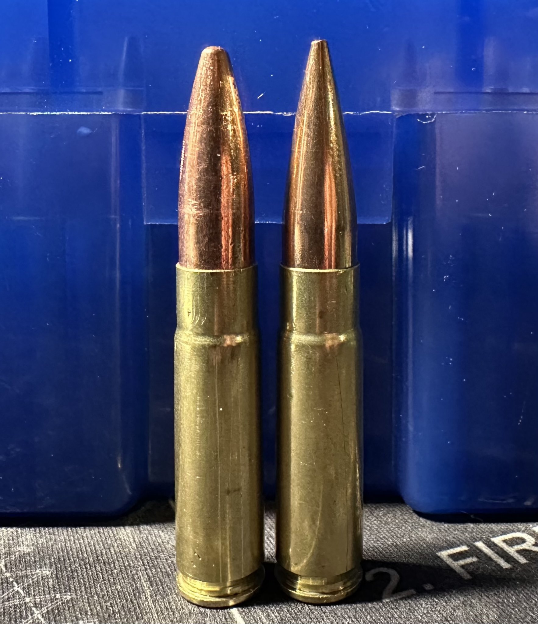

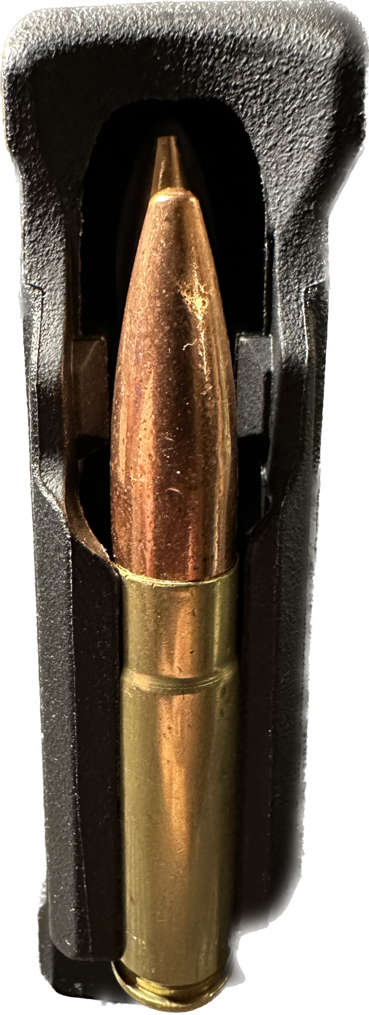

Works fine for me. And allows me to seat the 210 Bergers and 220 Berry’s out into the lands if I wanted to, with plenty of room left over. I seat them 0.010” off, and get excellent results.
L - 220 Berry’s
R - 210 VLD
220 Berry’s
210 VLD
