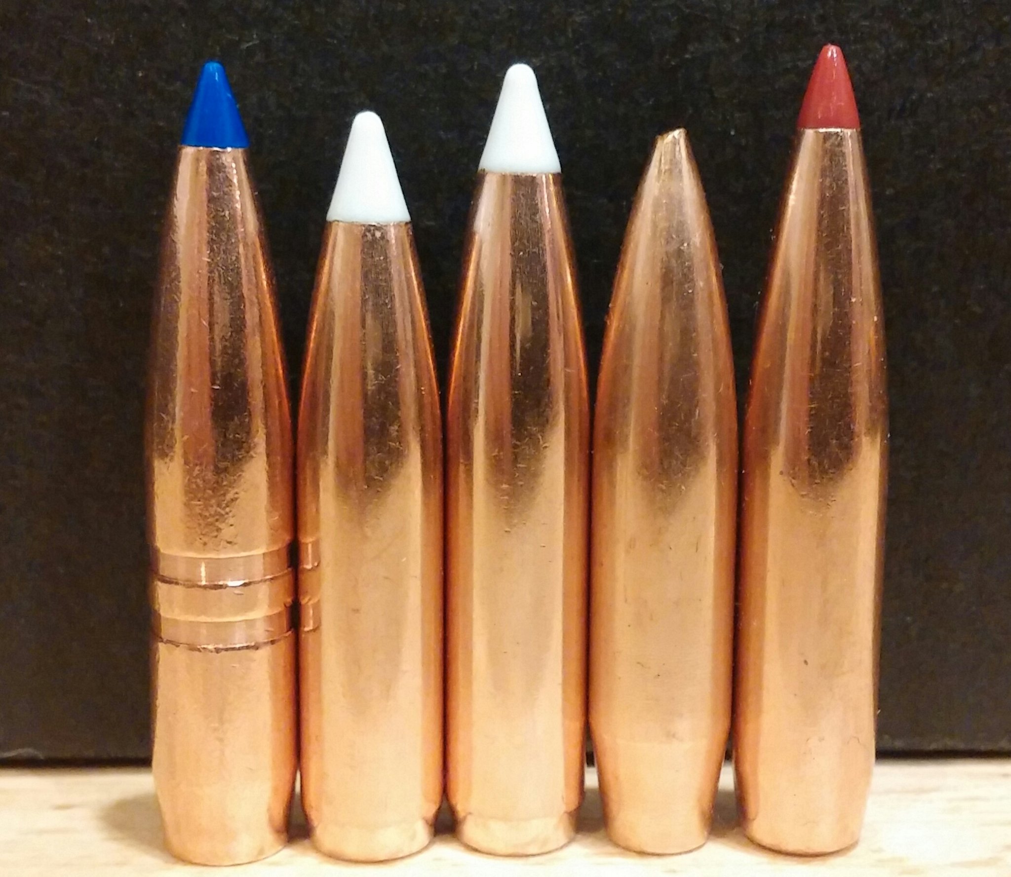

I sure wouldn't write the LRX off until you try it, it has been a very accurate bullet in my rifle. Also, as you can see in the pic below, it's not really much (if any) shorter than the heavier jacketed bullets.
L - R: 127gr LRX, 130gr NAB, 140gr NAB, 140gr NCC, 143gr ELDx.
