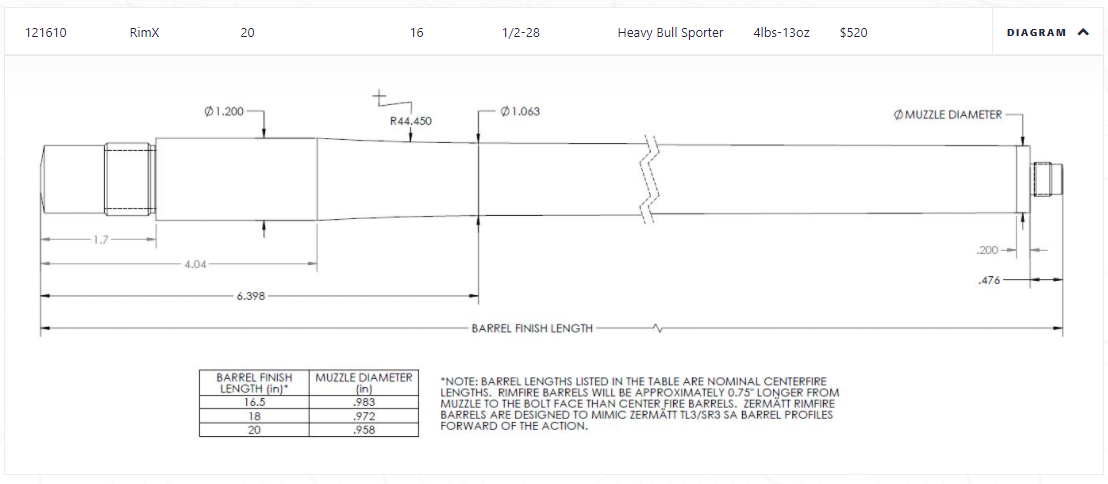

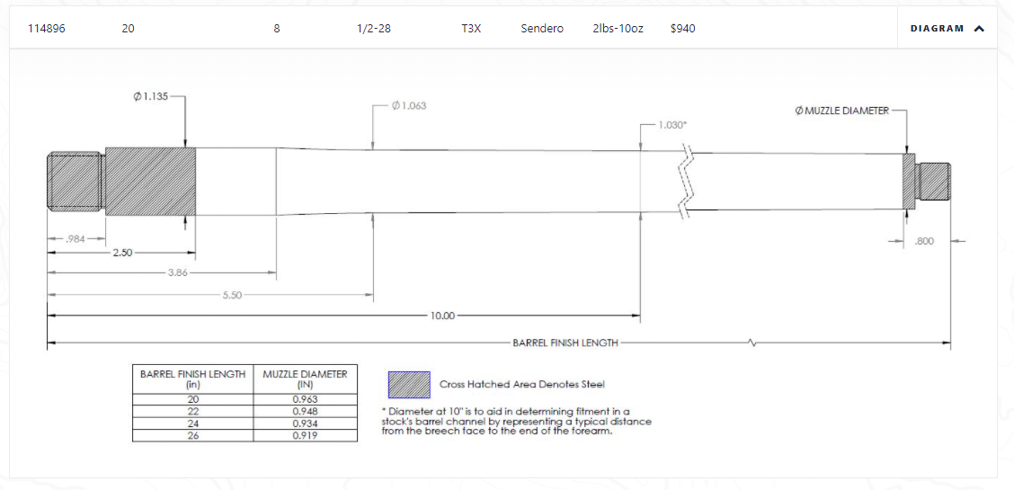

For a given volume the carbon barrel will be lighter. Compare apples to apples dude/quit trolling.
Yes, 1 lb of carbon weighs the same as 1 lb of steel.
No, a cubic foot of carbon does not weigh the same as a cubic foot of steel. Obvious weight savings.

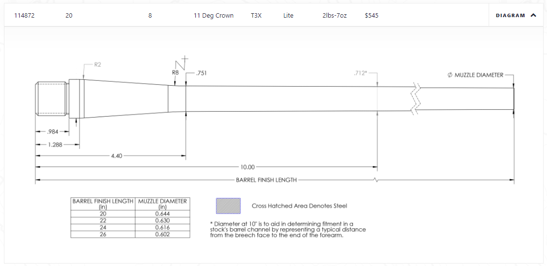

Proof sendero weighs 2lb 10 ox but finishes at .936 muzzle diameter
Proof steel- weights 2lb 7 oz so its technically lighter but its finishing at .644 inches.
Notice that the carbon is a thicker contour. If the steel were .963 at the muzzle instead of .644 it sure as shit wouldnt be the same weight.
SO lets look at one that does end up about the same external dimensions as the carbon and we get 4lb 13oz
That steel weighing 77oz total is 183% heavier than the carbon comparable which weighs 42 oz total.

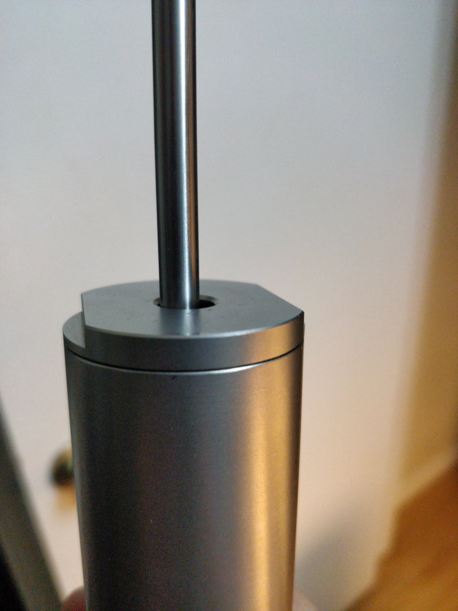

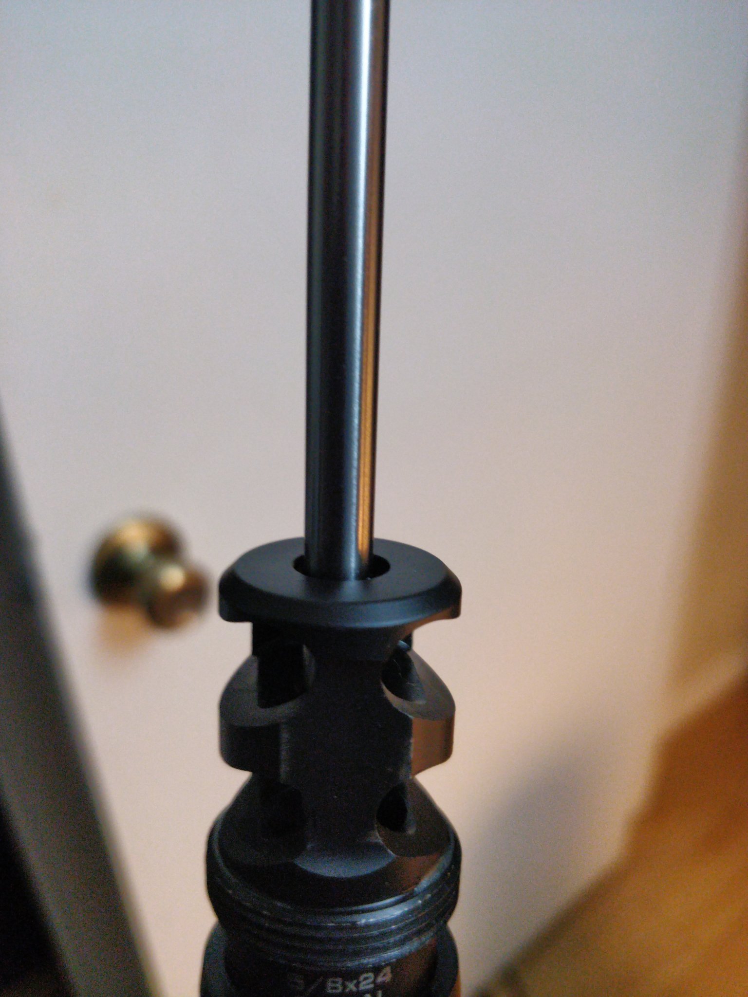

Running into a weird issue, ordered a shouldered barrel in 6.5cm from preferred last year, got it in and shot it a bit and everything was fine. Went to mount a can on it and it turns out the barrel threading is SUPER non-concentric with the bore. Like it's in excess of 0.010 out and if I put a rod through with the can, the rod is almost touching the sides of the bore. It's to the point where if you pull everything off you can see that the bore is off to one side. This is a 30cal can bored to .360 and it fits perfectly on everything else I have.
I took calipers to the threads and found that the bore was 0.187 on the far side and 0.175 on the near side with all muzzle devices removed.
Should I contact preferred about this or should I just find a gunsmith to properly re-thread this thing?
  • Wow
Reactions: wade2big
View attachment 7566051View attachment 7566052
Yeah unfortunately that does not surprise me with this company, I've had 3 different barrels now with 3 different issues.
Hopefully they fix it for you, and quickly

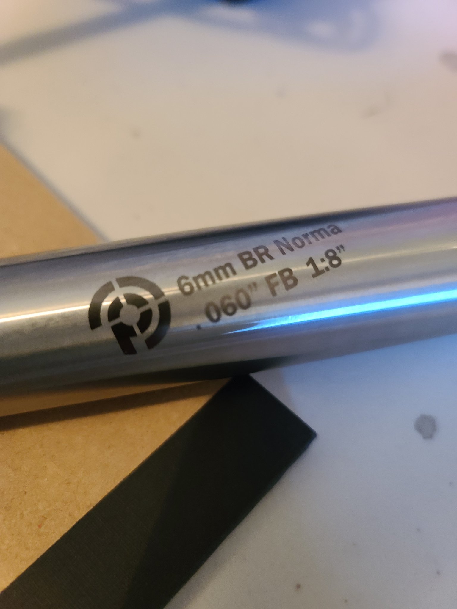

Barrel arrived on day 81, within the 10-12 week window. Machining is clean and is free of visible defects. The barrel shipped with break in instructions which was a pleasant surprise as my previous CBI barrels haven't, not that my process will be any different.
Let's see some groups and load development on that puppy. Always curious how their 6BRs shot.
Also curious to see how it shoots.

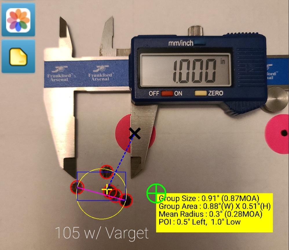

shoots pretty decent. 5 under 1" at 150 with factory lapua 105gr
got a light blue dot load that'll put a 16gr charge behind an 80gr right at or just over 1moa for 10 shots. that's what i was after and the reason for the build. it's very fun round to shoot. holds pretty good vertical at 550 as well. handswith or so on my go to rock.

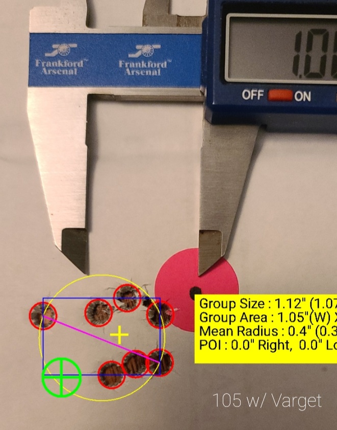

Made it to the range today with my PBB Remage in 6br. All the ammo that was shot were left overs from my last barrel so no load development has been done. Im honestly not sure if the 105s are Nosler Custom Comps or Match Burners but they are all gone now. The barrel shows a lot of promise! Now to the bench for some load workup.
