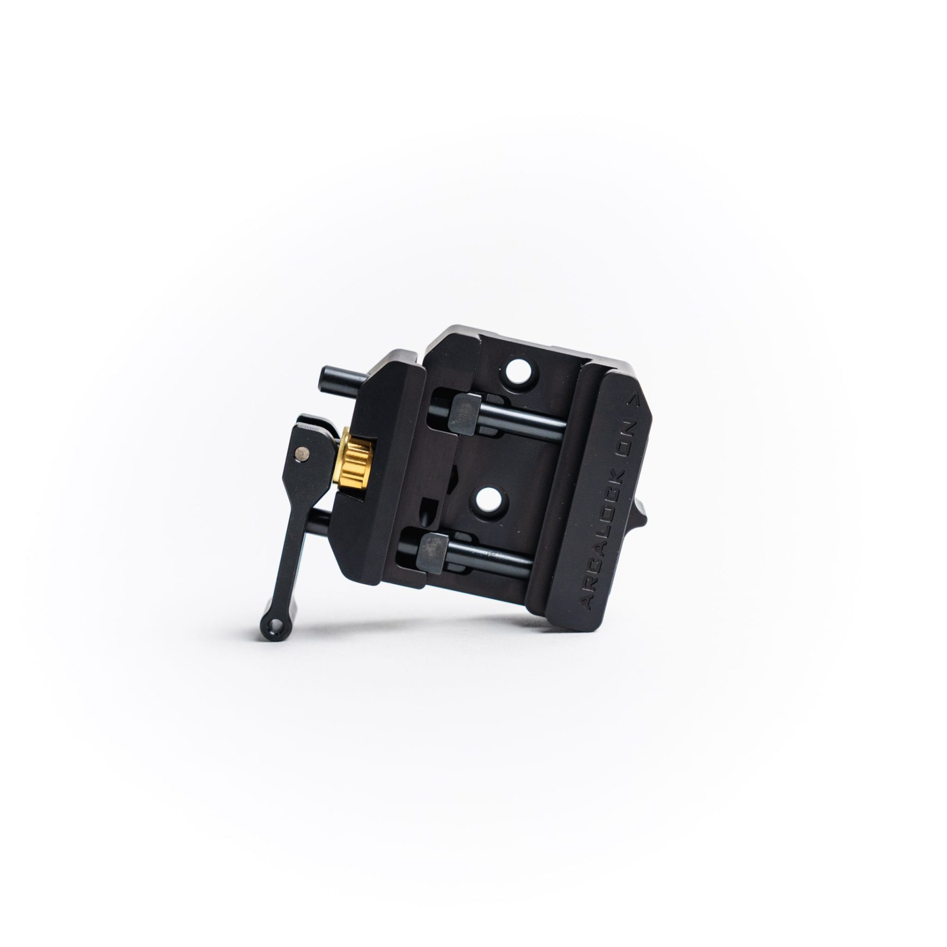

You can do that. I like to use a similar mount below. You bolt it on to your bipod. Now you can move the bipod on your bolt gun or AR no issue.

The Aria 419 ARCALOCK locks like a rail and is in another class. My DT SRS M2 in 338LM has the ARCALOCK and it handles recoil fine with no movement.

Also, the Area 419 one for ARCALOCK also works on standard ARCA with pins removed.

I had issues with Arca rails sliding as well. I run a RRS SC-ARC clamp on my bipod and tripod. It slid on cheaper rails and the 419 Arca lock as well.
I know they’re different systems for RRS and 419 and each are designed to work well with their respective parts. But my RRS clamped down hard on the 419 rail still slid and took the finish off of it.
