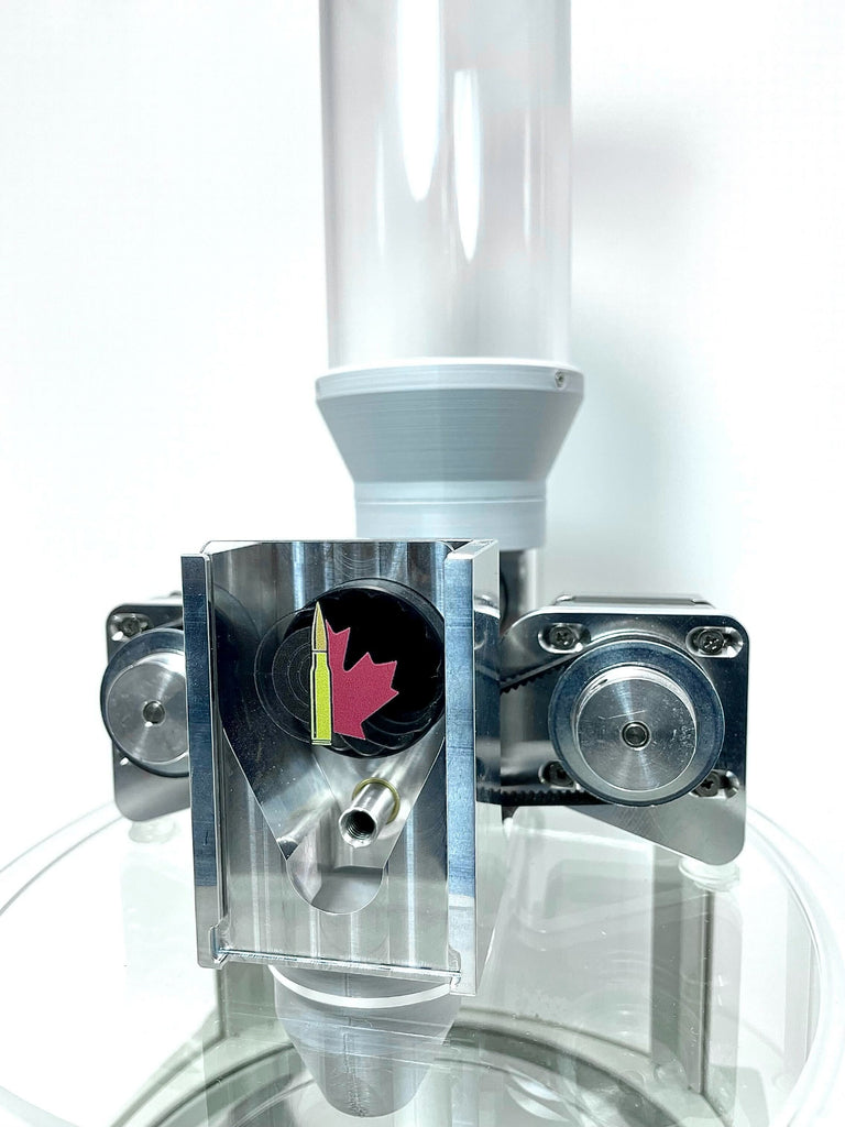

Go right now and put your $50 deposit on a V4 and get in line.

Also, you'll need a quality chronograph in order to actually measure your results. I think the only two real choices are between the Magnetospeed and Lab Radar. The Lab Radar is quite a bit more than the MS but not any more "accurate". Some people prefer the LR while others prefer the MS. Really depends on your use case and budget. I don't think either is a bad or wrong choice. I use the MS due to cost and ease of set up. Mostly cost though. I prefer a chassis mount to the strap but both give accurate speeds. The chassis mount eliminates POI change due to the strap mount directly to the barrel/suppressor.
Thanks for the info. The auto trickler is the one area I’m concerned that spending way more may not produce enough difference (for me) to warrant the price increase. Sounds like I’ll dial back a tad here.
Don't rule out the convenience factor(s) with the Autotrickler/FX120i. There were no other choices at the time and I ended up chasing all the Revs/Mods on a V2 that Adam was making over the course of development and I ended up with a V3 and all the Area 419 mods. I had a V4 on order (after much consternation) a couple of months ago, but I ended up canceling it for various reasons. The two primary reasons were leadtime on the V4 and the fact that I am getting great results with the V3.
I've been delighted with my V3/FX120i. Maybe, just wait a while on the Autotrickler for now and pick up a used V3 with all the trimmings. The used V3's are fetching some pretty good coin right now, but that will change when Adam catches up on production of the V4. IIRC, the V3's are either out of production now, or very close to it. Adam's a great guy with a great product and it's fun to see a guy like him develop a new product like he has and be successful with it.
As far as a press, if I were starting from scratch, I'd just buy a Zero. Cry once.
Reactions: Beezer911
I agree 100 percent. A magneto speed is a very affordable way to verify results of reloading. Just remember if you are far exceeding book velocity you are probably in an over pressure situation.
I’l get a chrono at some point, but I’ve got access to a number of magneto speeds at the club so I’m covered for now. Good call on the velocity - I plan to start conservative and creep up on speed vs go nuts and have to cut back.
Reactions: Average guy
Since I’m here I’ll give my 2 cents on equipment. I run a 6 station Lyman press and a charge master link. My does are a mix between RCBS, Redding, Hornady and Forster. One thing I do in my process is I mandrel all my necks after sizing.
