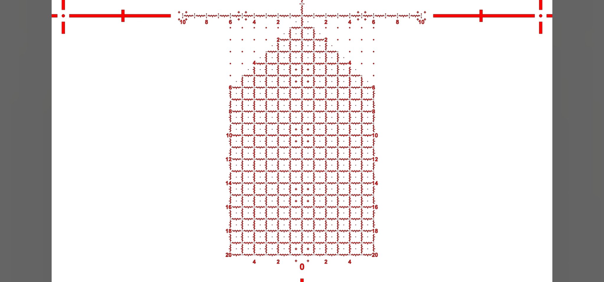

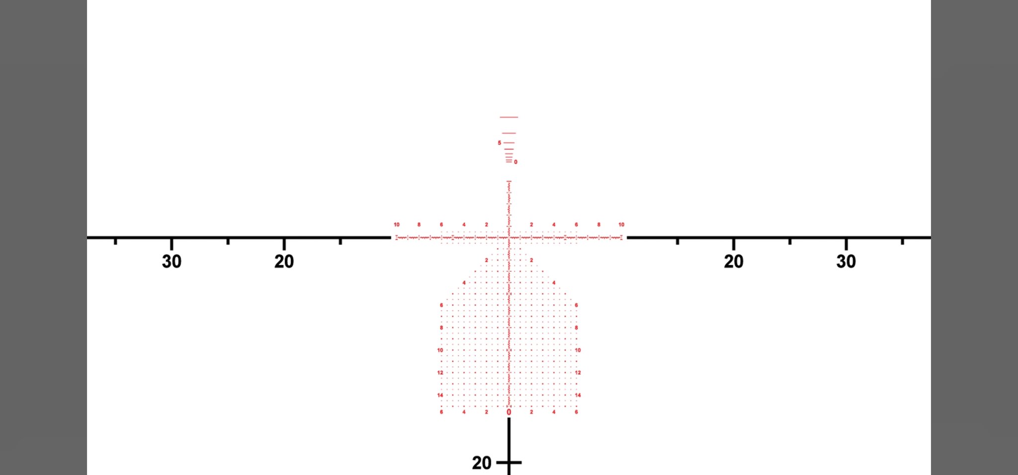

Finally, no more chevron. But holly cow the new recticle......
@koshkin or anyone else at Shot who could run by Primary Arms and weigh in on the reticles on both of the PLX long range scopes. Those of us who have shown interest have spoken our unsupported opinions without having stuck our face up to the lens for a real view. Trying to remain optimistic, and would like some knowledgeable commentary before committing more of my time to the concept.
The simpler DEKA reticle is looking very good.

Am of the opinion that the Deka or Athena may be the more useful for my applications, and I do like the Griffin in GLX 1-6 and PLXC 1-8, though the Neptune ‘appears’ very busy-maybe too much so to be applicable for gas gun usage. Decent field of view, turret quality and solid IQ throughout mag range are my concerns. Very interested to hear more learned opinions from the assembled wisdom here.

The Athena looks like it'll be "okay" for the 4.5x, glad they got rid of the silly tiny chevron. I really wish they brought the thick horizontal bars in to 6mils and brought the vertical bar up to maybe 10 mils.
None of the reticles interest me for the 2.5x which is really a shame as a mil-tree 2.5-20 usable throughout the mag range is something I would be very willing to pay for.

The Neptune looks crazy, but both the Deka and Athena G2 seem quite reasonable.
My bigger issue is the 2.5-20 weighs 32oz.
The deka looks like a crosshair. Which is a fail. Floating dot is superior. And the Athena g2 looks so damn busy everywhere. It’s awful. No one wants a busier mill Xt reticle. And no one wants a grid reticle. They failed on the choices.
The Deka I saw was like a mildot with subtensions but it has a chevron as the center aiming point which I don't really like. A crosshair or floating dot would be better.
Ugh just saw the Athena is available in the 2.5 but not the 4.5. I had that reticle in their 3-18 and 4-16 GlX. can confirm it was useless at 3x... and not great at 4x either... and that was with the little chevron. I hope they change that, maybe just get rid of the Neptune.

  • PA made some interesting choices for reticles out of the gate
    I don't hate what I saw, but as with anything...it'll probably take some time love/hate it. The Neptune isn't perfect, but it looks as good or better than the old H59...and I still have scopes today that have it.
PA has a new turret design that essentially works like a cartridge. I looked at how it works on the inside and it is quite clever. It is easy to have different version to swap out, so that getting bigger numbering for the blind is not going to be an issue.
I was not super happy with the tree reticles, but DAKA G2 looked pretty good. I'll be getting one relatively soon.
