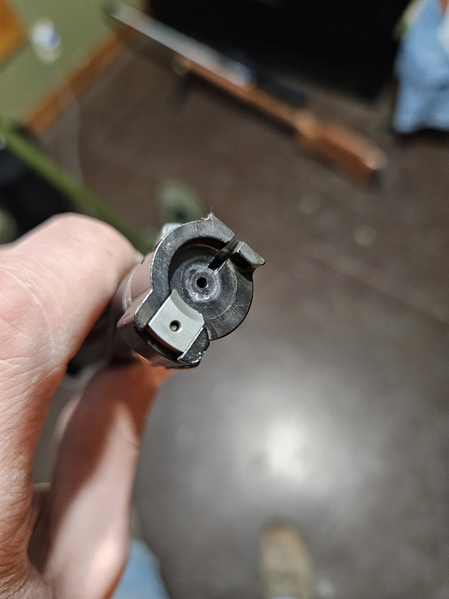

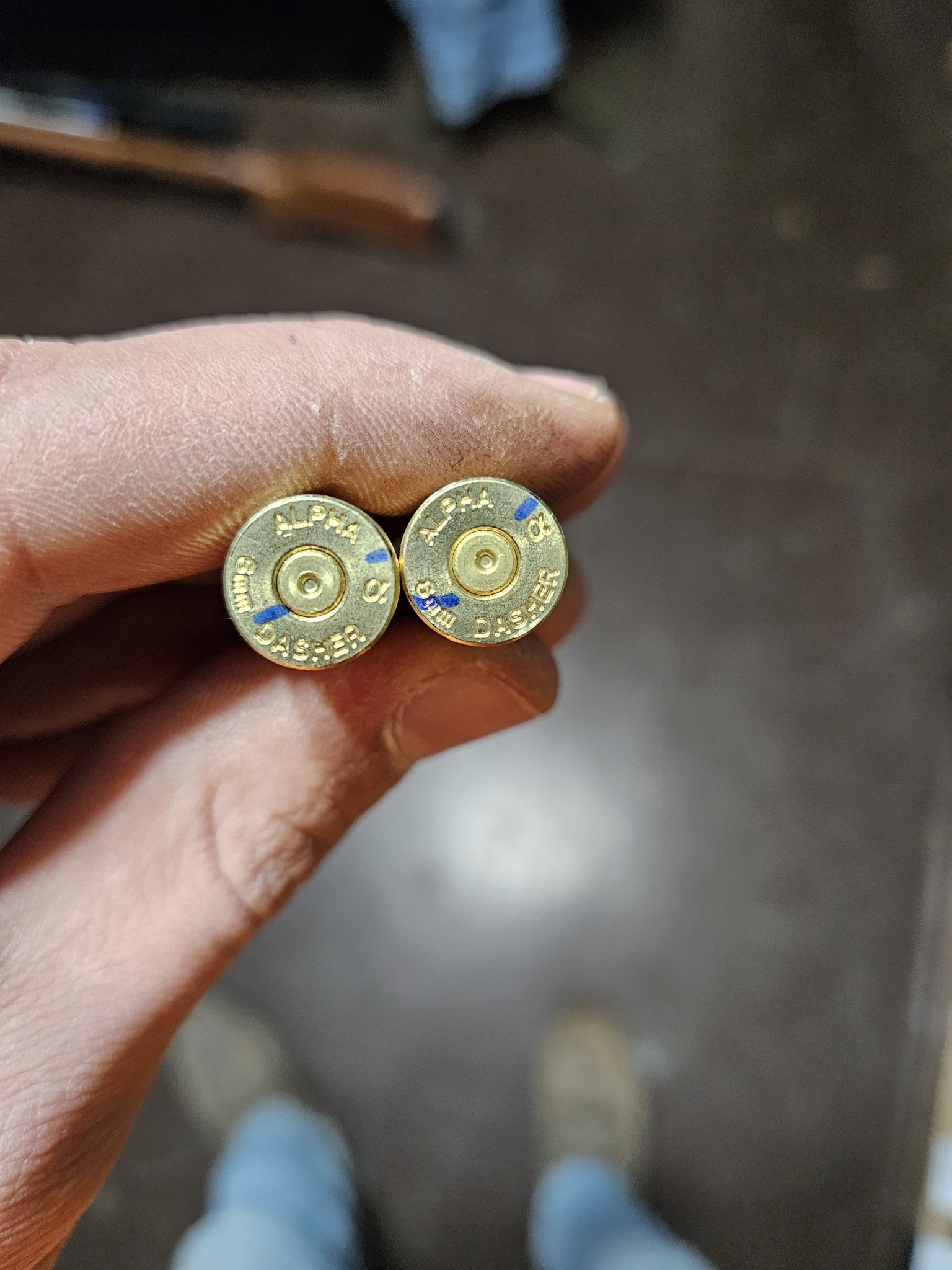

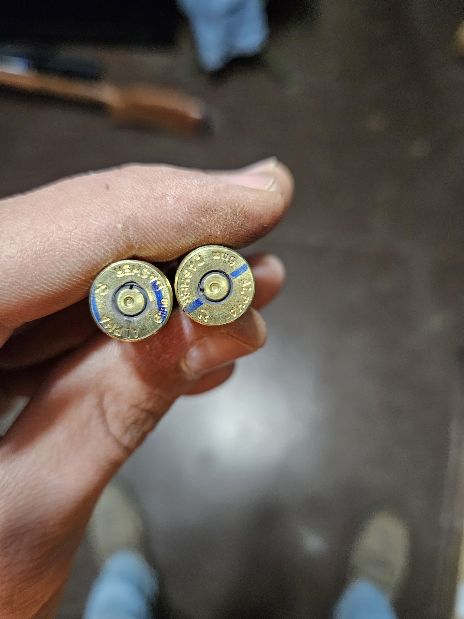

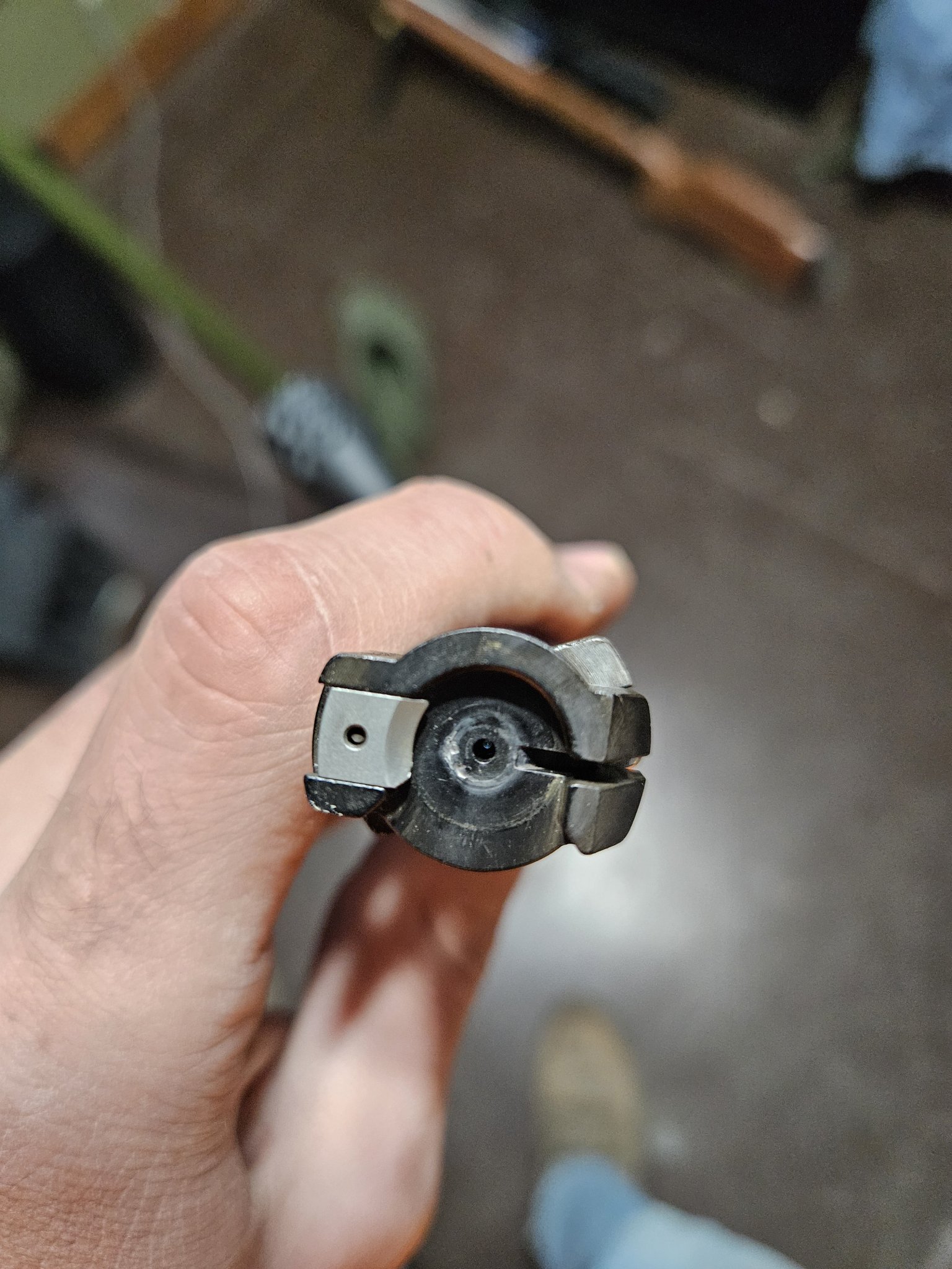

I just got a 6 dasher that I put together. Zermatt origin with proof pre fit 26" barrel. Brand new alpha brass srp. At 31.7 with varget I got a blown primer didn't come out but it had carbon ring around it and a hole. I started with shooters world precision and had it do the same thing at 31.5 with heavy bolt lift so I stopped cause I was just looking for pressure with the powder and just switched to varget. I did 5 rounds at 31.7 and didn't have a problem with the other 4 rounds but the 1 round had the problem. Shot 5 at 32.2 and they didn't have any problem or heavy bolt lift. I'm using winchester #41 cause it's what I have and I didn't think it would be a problem but is that the problem? Do I need to switch primers i do have some cci450. I also noticed my bolt now has 2 little dimples on the face is it trashed now to?

Looking at the pictures and before I read your post I was guessing it was probably Winchester primers. :eek: ;) In the last couple years, I've seen this a lot with Winchester primers. So, yes . . . I'd suggest you switch to something like the CCI450's for your Alpha brass.
With Alpha brass there's an issue with their a little larger than the usual SRP flash holes, as that tends to produce this result when using thin skinned SRP's. . . like CCI400's. I got the same result with my Alpha brass using CCI400's; switched to CCI 450's and had no further issue. Also, did real well using Remington 7.5's.
The bolt face is not fine... it could be refaced in the lathe, and reset headspace.
The firing pin hole looks out of round.
So bush the firing pin hole, at the same time.
Primers are struck off center. So barrel, bolt, or reciver are not on the same centerline. Common in old production rifles.
I use Remington 7 1/2 primers in 6 Dasher Alpha brass exclusively, as primer pockets are tight with 450s.
It's an Origin action.
The cost to do all that machining would exceed the price of two new bolt heads.
I wouldn't get rid of the primers personally, I just wouldn't use them for that cartridge at that level. I never have purchased any #41's as I use 450's, 7 1/2's, or my final 5k of Wolf SRM's for "high pressure" loads.
I didn't notice if it was mentioned, but I would check the firing pin tip while I was at it to check and see if it took some of that extra velocity goodness.
I wouldn't worry too much about the bolt face, but you can always just change out the bolthead if it bothers you. Your extractor either is got some small chips taken out of it or has some brass on it from my perspective.
Not if you have access to a lathe, its free and a simple 10 minute task to face the bolt face. Probably take .003" or 004" and it will affect headspace, so reset headspace, if barrel nut is used...or set the barrel back .003" & check clearance.
I'm gonna go out on a limb here and say the OP doesn't have a lathe.
That looks like the patented Winchester primer shoulder pinhole defect, how old are these primers? Probably 15 years ago they had a bunch of WLRs with this defect, I had some and at least one non-swappable bolt head that got etched. I think they wound up replacing bolts for some folks, would have figured that surely they had fixed this issue in the subsequent decade and a half but.....
A friend with a lathe might work.
Depends on the friends skill of course. I wouldn't trust my own skill to do the job, cause I suck at math and getting the correct tools would cost more than the new bolt head.
A gunsmith would charge more than the cost of a new bolt head just to bush it.
The bolt head is a little over $100.
If he had to reset headspace on a shouldered barrel, then the gunsmith cost goes way up. The OPs friend would also need a reamer.
A nut barrel would be different as long as the modified bolt head doesn't make contact with the breech end of the barrel with the new headspace. (It shouldn't)
I wouldn't have any worries about continued use of the bolt head. I would inspect the firing pin tip for damage though.
However...
My recommendation is for the OP to back way up on his powder charges and start over. If he doesn't trust the 41s, then move on. If he's using the 41s because they handle pressure better, then there's your problem. CCI 400s are perfectly fine and safe with sane loads. If someone insists on shooting in the 70,000psi+ window, then these problems and more will crop up.
