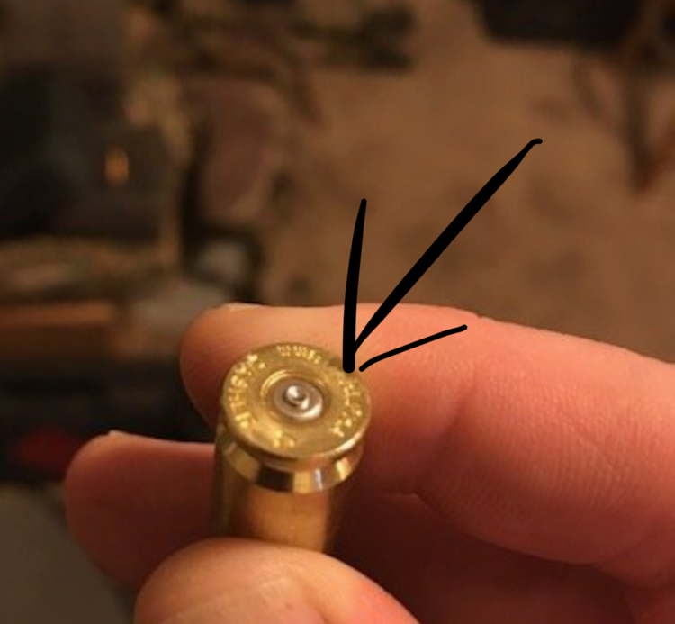

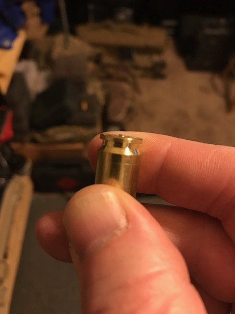

This has been happening as of recently in my Dasher with the CCI450 primers and I am puzzled and wanted to see if others are having similar issues. No pressure no flattening of the primers with a mild load of Varget. What usually comes with it is pierced primers as well. See below on the pictures. The center of the primer is sticking up. Running this on an Impact Action.... This has happen in two different types of brass (Lapua and Alpha). Any insight would help as this is a first for me.

Try different primers with a "thick cup" (CCI BR4 or No. 41) and see if it's just that lot of primers. Otherwise it's indicative of an oversized firing pin and pin hole. Typical solution for that phenomenon is to bush the bolt and reduce the FP hole/pin to about .062".
Band-aid solutions are to run less pressure, thicker cupped primers or to increase FP spring weight.

Thanks I appreciate it .......bushing is not an option being this is already a small firing pin in an Impact 737 Action.
Bullshit “no pressure”.
You have highly cratered primers and ejector prints.
This is already a small firing pin in an Impact 737 Action.
Yeah, then I agree with Spife that you are NOT running low pressure. What's the "mild load" load you're running? How's bolt lift, haha.

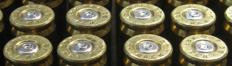

Here's 25.25gr of Varget in a SAAMI .223 Remington chamber with CCI 450s and "factory" firing pin hole. It's not low pressure (2920fps 77gr SMK 2.300 OAL) and you still see the round primer corners. Notice the primer cupping?
No ejector prints on the brass....and the primer is not flattened and cratered....it is protruding. So not bullshit.
Yes ejector print.
And you’re a cunt hair away from pierced too with all that cratering.
All these signs you’re excusing as not signs are in fact signs. If they weren’t then you wouldn’t have these symptoms to ask about.
Yes ejector print.
