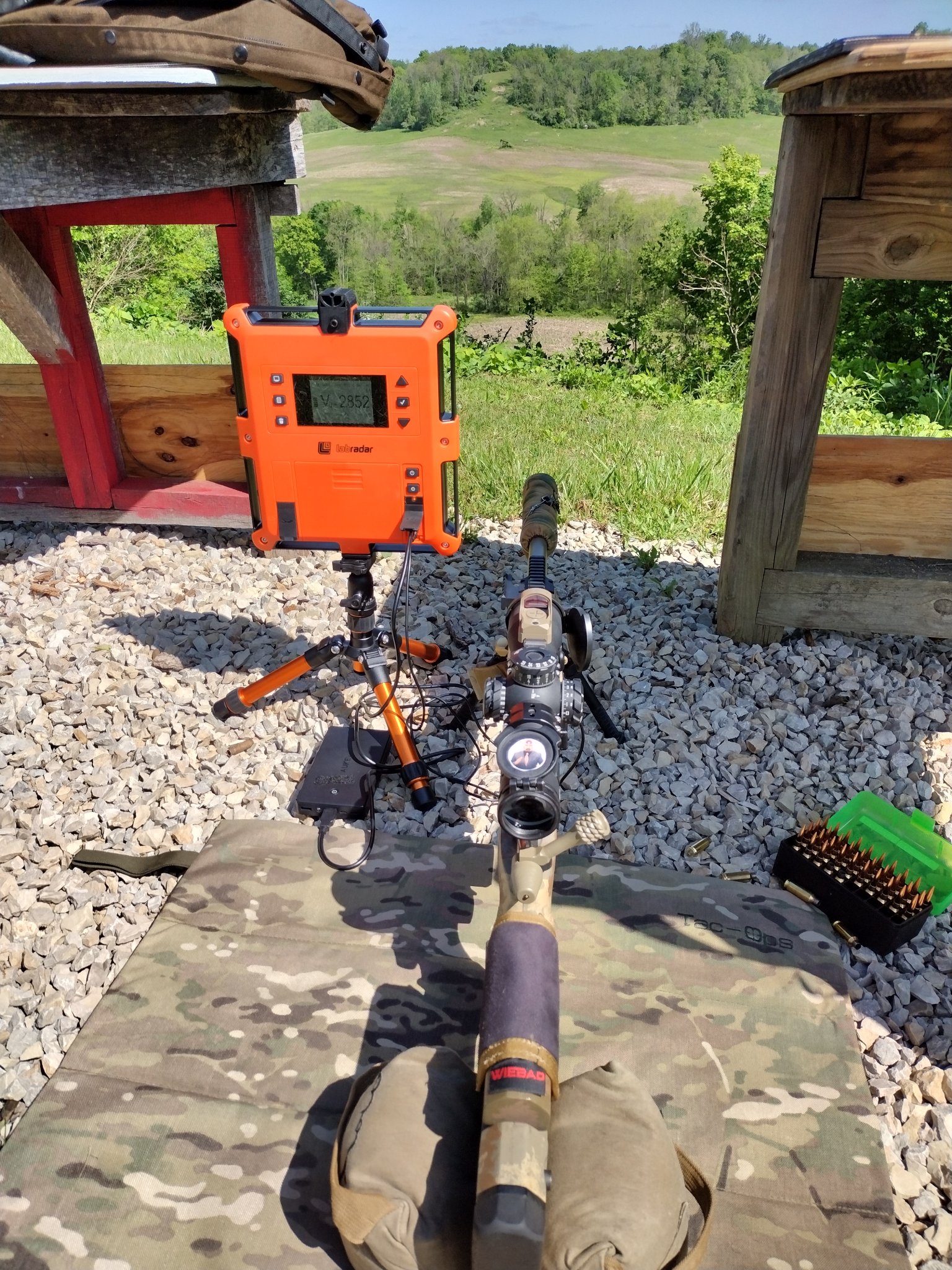

Well I loaded up 39 rounds with 31.4-gr Varget and went to the range yesterday. I had zero issues with hard bolt lift. First round hits out to 950-yds.
MV Ave 2,850-fps
ES - 15 fps
SD - 4.5 fps
Not bad for an 18" barrel!
Damn thing shot lights-out. I give up. 🤷🏼‍♂️🤦🏼‍♂️

31.4-31.6 are gold at 2850 in my book.
