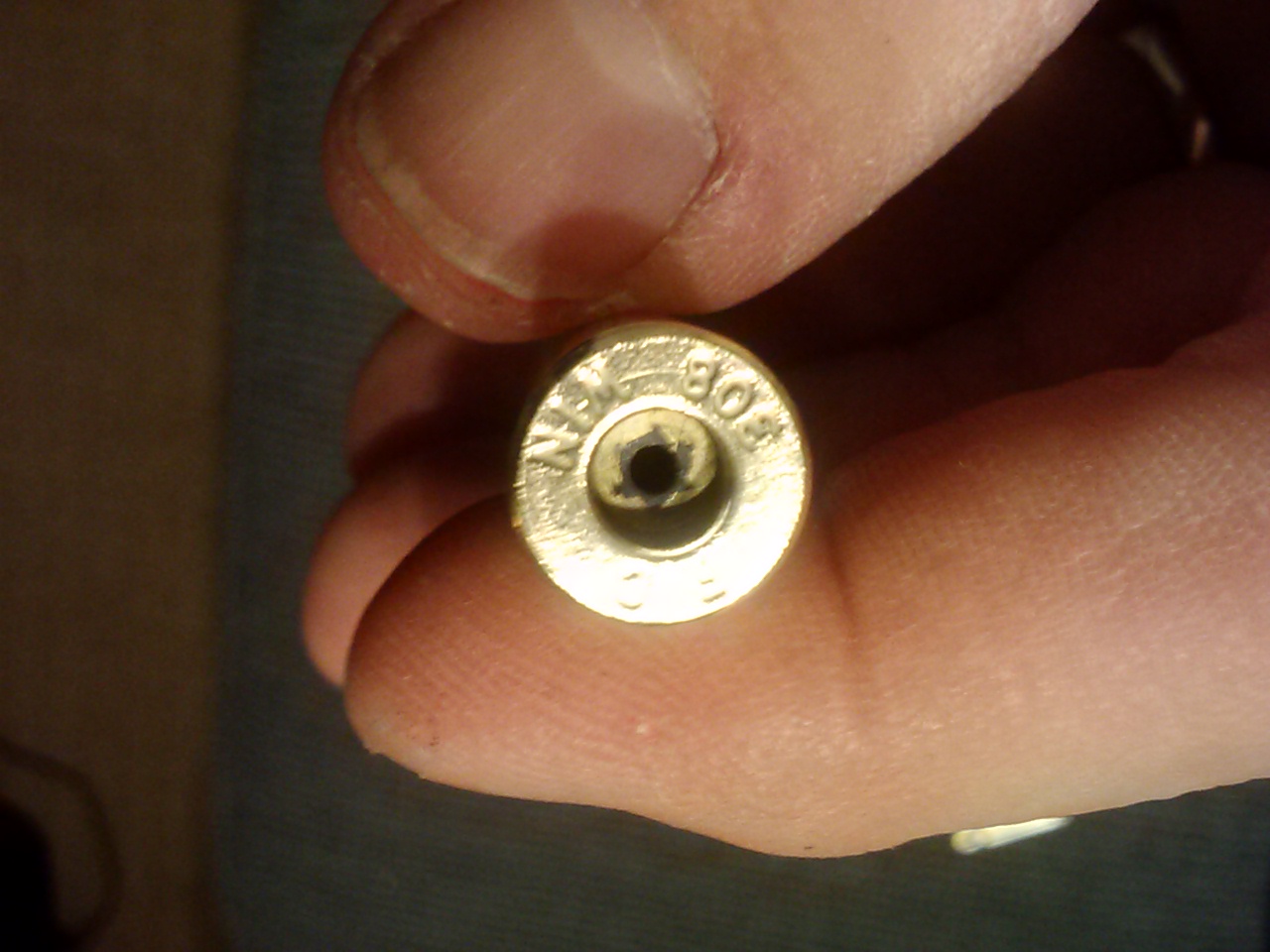

On the matter of discarding brass if the primer pocket is nonuniform. About 2 maybe 3 years ago, I bought 100 243 Lapua cases, and every one of them had a shallow primer pocket. I dunno, maybe around a hundred bucks and according to some advice herein, I should toss the cases when I had the means of uniforming those pockets so that they seated my primers just below flush?
That's one reason to waste your time by "uniforming" your primer pockets.
