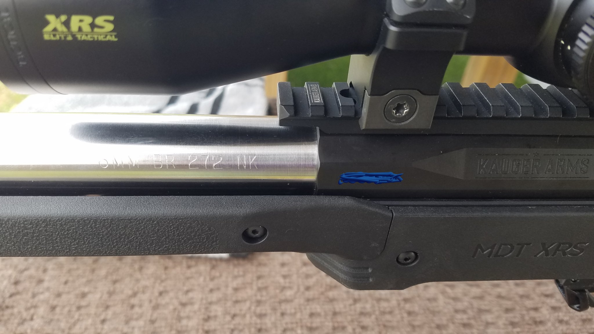

Then the barrel maker has all they need to even provide a barrel that headspaces once torqued on, their logo and the barrel info shows where the maker intends, and one could even have an integral muzzle brake pre-timed.
In theory but not in practice. The rotational difference to hit a thread to that tight of a fit for clocking lineup is well inside what a Class 3 thread would generate. Even with a Class 3 fit between a receiver and a barrel the is way outside of the allowable clocking tolerance of a blended brake.
Sometimes we have people call up and say the headspace on their barrel is wrong because the clocking is off by 5-7 degrees. That takes an explanation about how the clocking of the timing mark has no influence over the headspace and this shocks some people.
Zermatt and Impact are the most consistent headspaces and thread dimensions that we deal with. Taking either of those and using the same barrel across 5 actions will net someone a drift in clocking marks that is acceptable for labeling but wholly unacceptable for timing a brake in place with the reliability that is required for a prefit action.
Reactions: Pristine
Well then it's harder than I thought... understood.
Still, I've put 3 different PROOF barrels on my Impact action and the PROOF logo and caliber info ends up exactly in the same place. So it's timed enough for that and PROOF figured out the timing so, at this point, any "new" action out there really should be able to accommodate the same.
That's true, and that's typical of our prefits for ARC, Zermatt, Impact, etc.
However, if you had a muzzle brake that wasn't quite right the likelihood of the barrel going back with your action to be re-timed is a whole lot higher than if your caliber marking is off by 5 degrees.

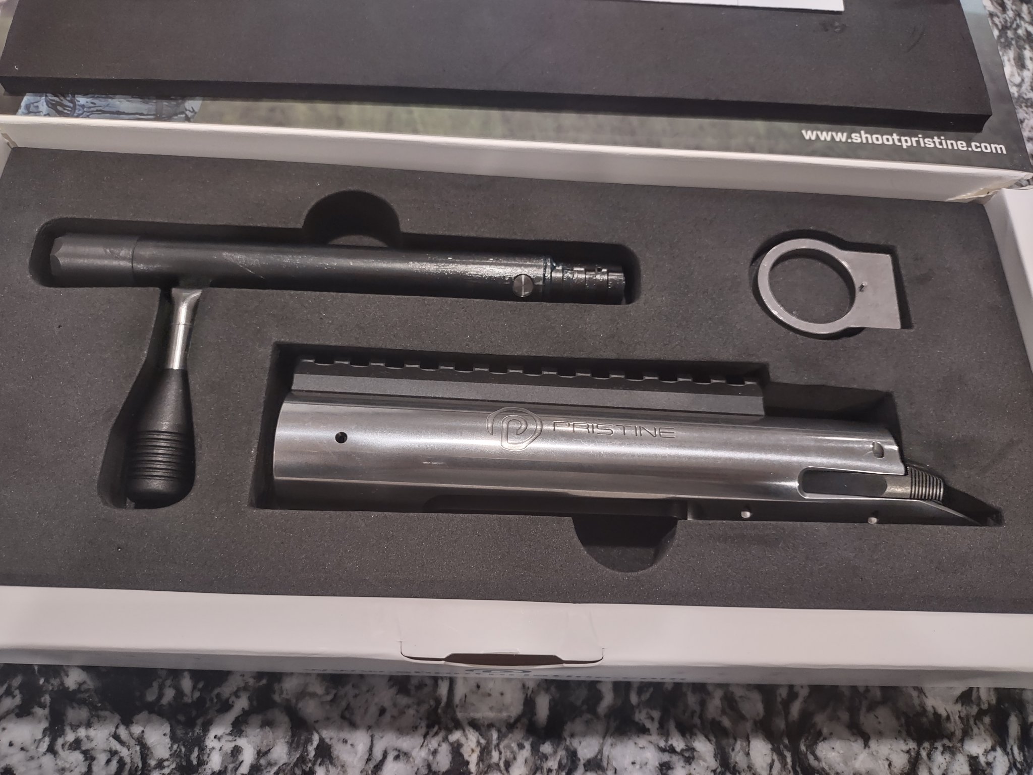

Hey guys. If anyone wants to see one of these in the states we have a demo rifle that will make it's rounds at some PRS Midwest matches. The rifle will also be setup at the Missouri Vortex Sniper Challenge in a few weeks for anyone to look it over on the Thursday vendor day.

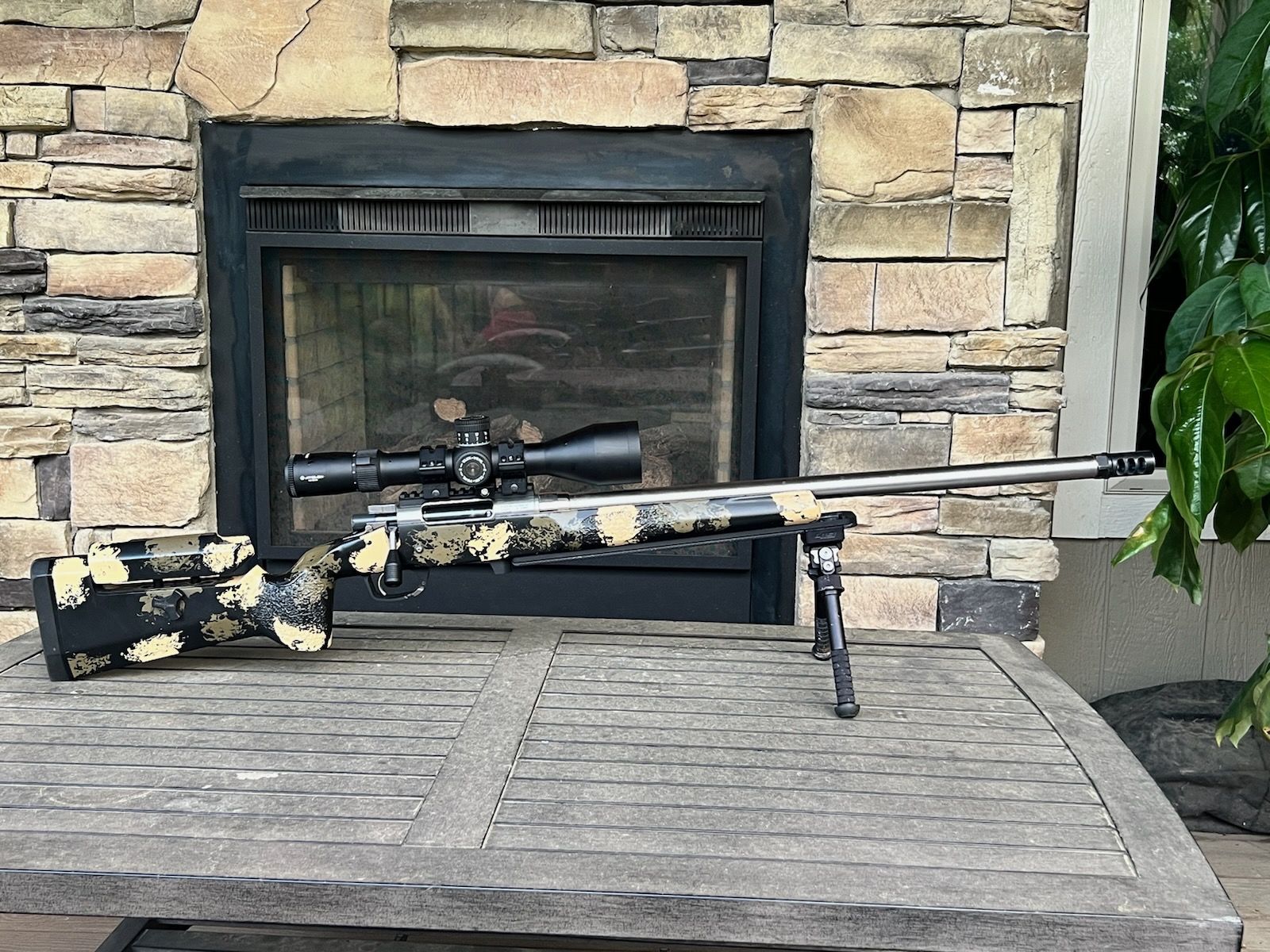

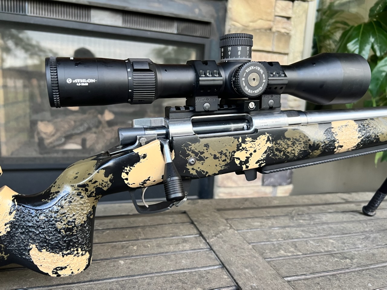

Update on the Pristine action!
One word....smooth. Just dumb smooth bolt lift, can't even explain how light it is. I'm also happy to say that any issues found they are working to improve and that I have an early version so some things are already take care of.
Pros:
Machined well, good extraction, smooth bolt close and lift, oversized tang, semi tooless bolt disassembly, easy to clean, rail is solid and has a nice finish, solid bolt stop that is easy to use. Stainless trigger pins that are polished and easy to install. Using a proof 6.5 it's an easy 1/2 moa rifle.
Cons:
Bolt shroud is machined plastic on mine (metal version coming), slight wiggle on the lug pin ( fits fine but I'm a sucker for perfect fit pins), bolt body could be fluted to make it glide just a bit better (nothing wrong just not as smooth back and forth as my defiance). Ejector springs are a little weak (zero failures but I prefer it to land further away than they do), Bolt knob is "ok" (could be a touch longer and teardrop)
Reactions: JackBerry
