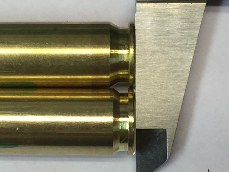

The extractor grooves between them are quite different. Grab your calipers and take some comparative measurements of the two case types, see where the change is. Also, inspect the extractor marks, if any, that appear on the rims or grooves of the extracted cases. The pic below shows a hornady case on top, and a lapua on the bottom. The diameter of the extractor groove is also different between the two. The lapua is fatter.
