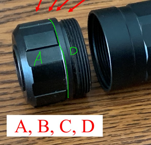

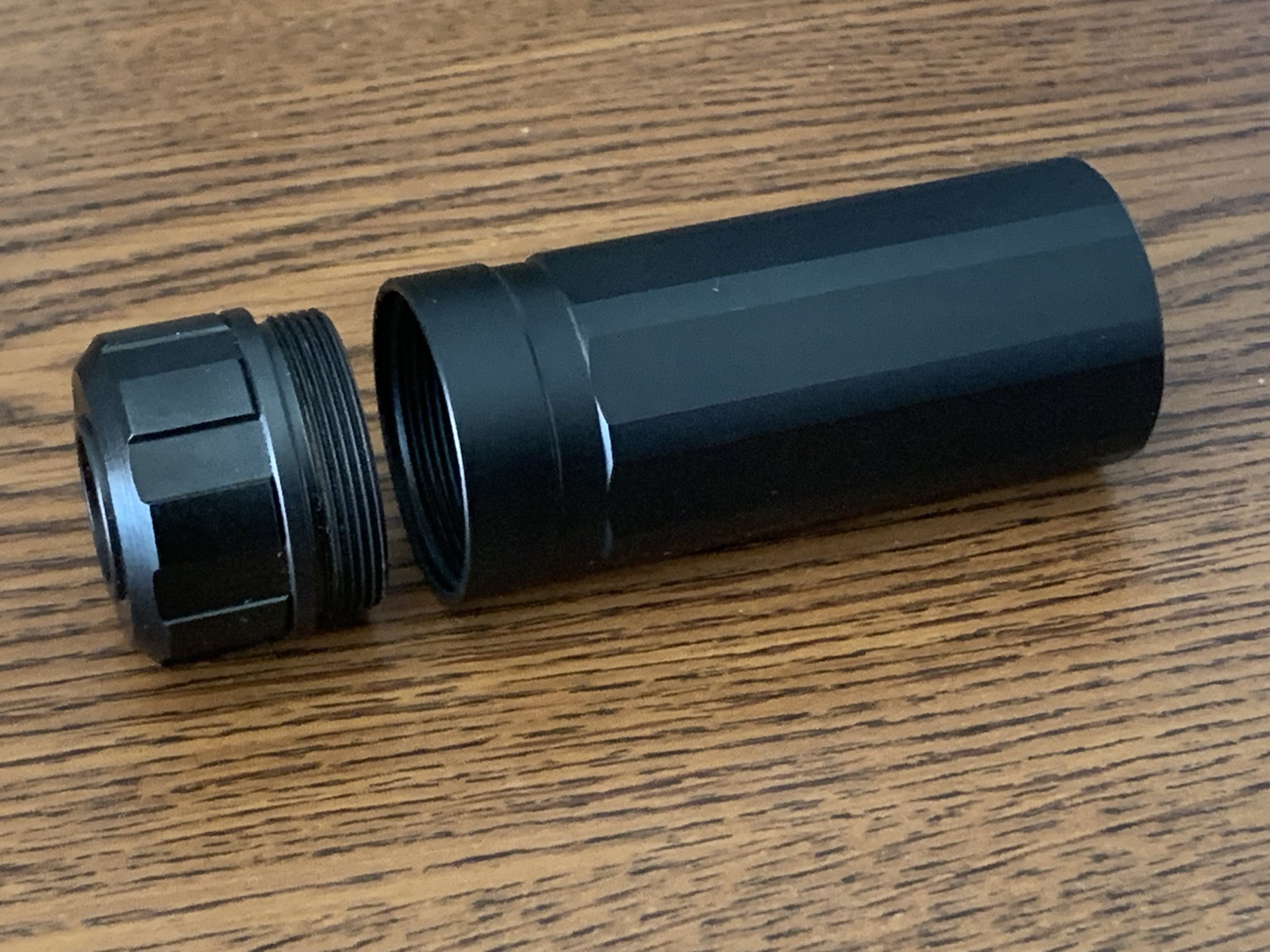

    I do not have a good feeling about this suppressor that I picked up yesterday. Compare the two photos below. The top one is from the https://www.thefirearmblog.com/blog/2017/04/25/aac-halcyon/
    It is how the rear end cap (AAC calls it a lock ring) and other components in the rear assembly are supposed to look after disassembled. The bottom photo is from my suppressor. Note how the entire rear end (I will call it the lock ring and thread adapter assembly) came out of the main body tube.
    I had problems with the lock ring not coming off. The lock ring is the left most part in the photo immediately below. After initially trying it in a padded vise and using a strap wrench, I soaked it in kroil over night.
    Then the entire process with the padded vice and strap wrench was repeated without success. So I put it in a freezer then heated the lock ring up with a blow torch. Didn't work.
    Between repeated attempts I called AAC and nobody would answer the phone. I left two voice mail messages and didn't get a reply. A few minutes before typing this post, I sent a 2nd email to them.
    After one last attempt with the padded vice and strap wrench I got some movement in the rear end cap assembly. The entire assembly unscrewed from the main body tube as you can see in the 2nd photo.
    Some might say not to worry about it and just shoot it.
    I don't want to accept that. Inside the thread adapter, is supposed to be an O-ring. You can see it in the illustrations in the manual linked below. For the amount of money that I paid for this, I should not have any problems like this.
    I'll follow up with what AAC has to say if I ever get a reply. Has anyone else had any problems with this suppressor?

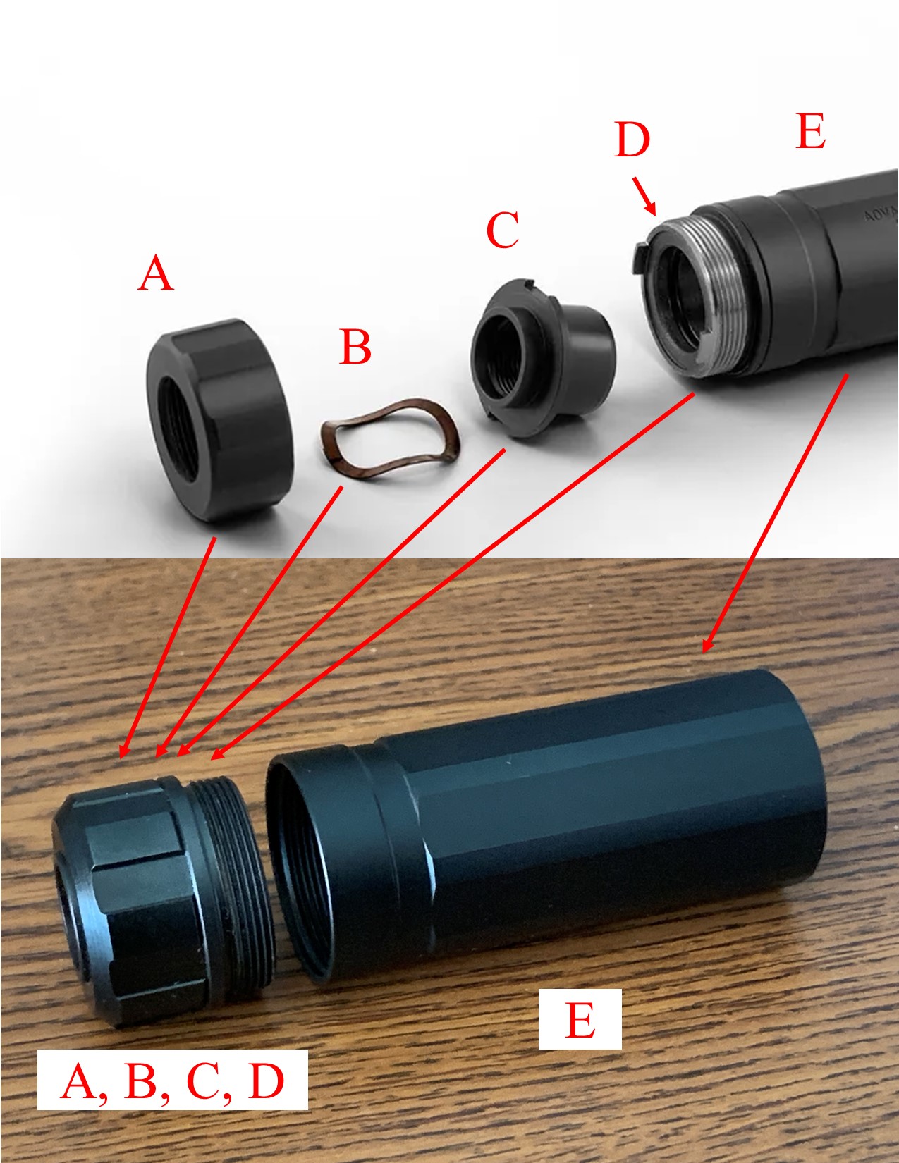

    It looks like one picture is the end cap end and the other is the locking ring end. Are you working on the ends with the barrel threads?
    Yes. What you are looking at, in the second photo, is the assembly that screws onto the barrel.
    In other words, everything that you see disassembled in the first photo is what is stuck together in the 2nd photo. I am not confusing which end of the suppressor to work with.
    Take a look at the right most part in the first photo (part D). That is what they call the thread adapter bore. It is threaded on the other end (unseen) into the main rear tube (part E). And it is that thread adapter bore which is stuck inside the left lock ring (left most part in the first photo) with all the intervening parts inside.
    A picture is worth a thousand words. Hopefully the picture below explains everything. Parts A,B,C and D came out together when removed from part E. I can't get them separated.
    Your part E looks like a front module, not the rear tube the lock ring should go into.
    If someone tried to assemble it incorrectly, who knows what is wedged in where.
    Can you post a picture with all parts? Show the engraving on the tube, that is the rear tube
    I can assure you that the tube that you are looking at is the rear tube. The rear tube is the longer of both tubes. The rear tube also has flats on it. The front tube is round. I don't want to show the serial number online.

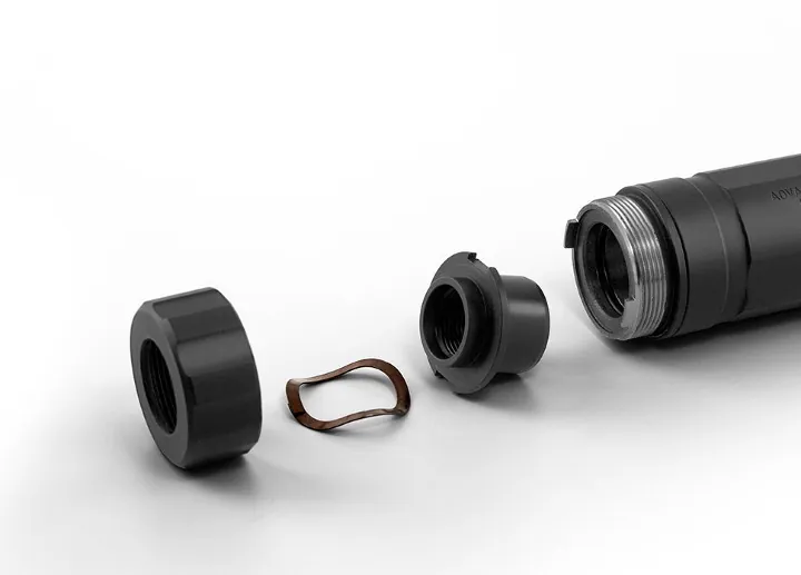

    Here's an AAC video of the suppressor. Looks great in concept. At 3:13, they move close up to the disassembly on the table. Parts A, B and C are at the extreme right in the foreground with parts D and E standing next to them. Note that part D is inside of part E.
    At 4:20 he picks up the rear tube (part E) and talks about the thread adapter bore (part D) inside it. Then he will insert the thread adapter (part C) and install the wave washer (part B). Finally he will screw on the locking ring (part A) on the thread adapter bore (part D) which is still sticking out of the rear tube.
    I hope this is a little better than the picture.
    At 2:45 in this next video he starts talking about disassembly and cleaning. You might want to slow it down but at 3:01 you will see part E on the table on the left side of the screen. Stop the video there and you will see the thread adapter bore (part D) inside of part E.
    He picks it up with his left hand then inserts the thread adapter (part C) with his right hand. You won't see him put the wave washer (part B) on the thread adapter (part C). Nor will you see him screw on the locking ring (par A) on the thread adapter bore (part D).
    Both of these videos should be proof enough that this suppressor has problems. I'm suspecting that perhaps the locking ring might have been cross-threaded during assembly at the factory. Or perhaps this was assembled without the wave washer. That could be enough to get this thing to lock up.

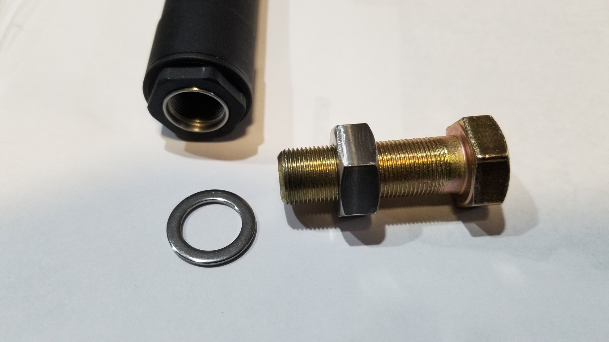

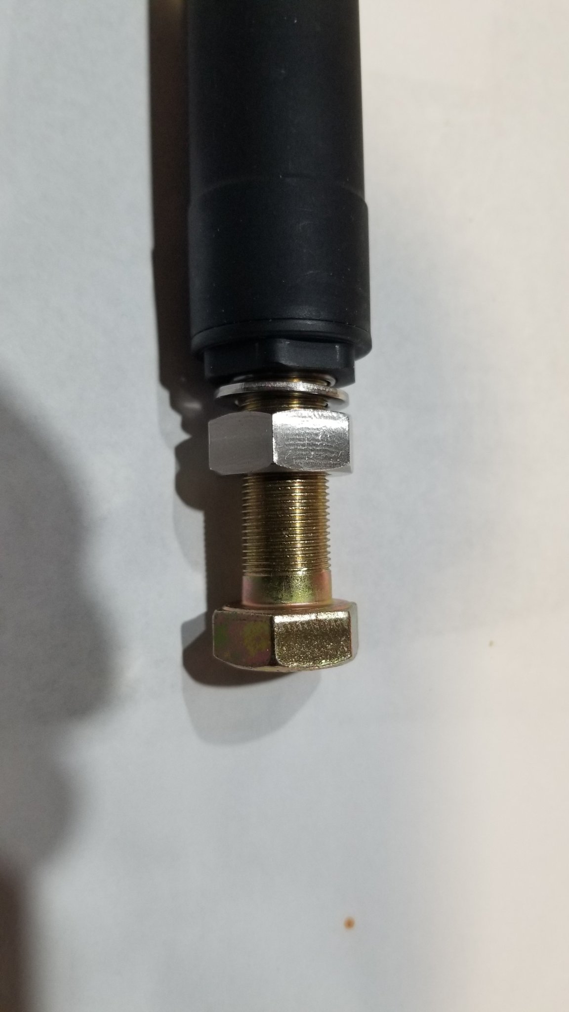

    Have you tried threading it onto your barrel and then grabbing the end cap and unthread it. The threaded insert should be seated against the barrel and twisting the endcap to unthread it is the same direction as threading the insert onto the barrel. It should break loose and don't forget to use anti-seize on the barrel threads to make getting the insert off.
    Or, you go to your local nut and bolt store and pick up a bolt, assume 1/2"-28, and jam nut and washer if you want. Thread the jam nut on the bolt, slide the washer on and thread your thread adapter onto the bolt. Tighten the jam nut against the washer. This will lock the threads of the bolt to the adapter threads. Put a wrench on the bolt head and then unthread your end cap. Once it is loose you simply back off the jam nut.
    A little visual aid.
    The washer I used was the thick shim from a muzzle alignment shim set.
