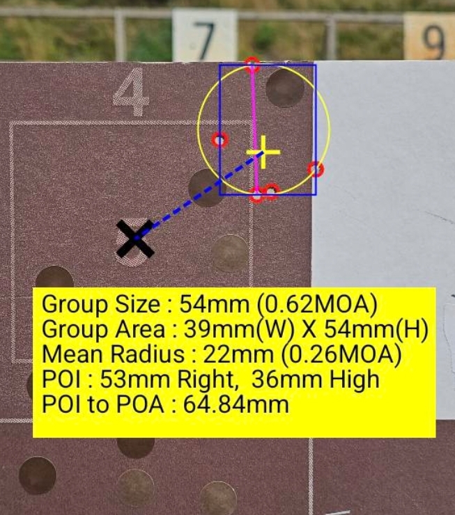

I am quite sure the N140 load works for them. 0.8moa 300m group (wind was 6mph from 4:30) would have not been possible with my N540 loads.
Too bad my order was just delayed, VV is treating the home ground quite harshly. It might take ages but I am on the look for N140 coming to sale in second hand.
I am on the edge of ordering few more as it is a good bullet and my current barrel is probably anyways nearing its life, 12K already in. Going to take everything out it offers.

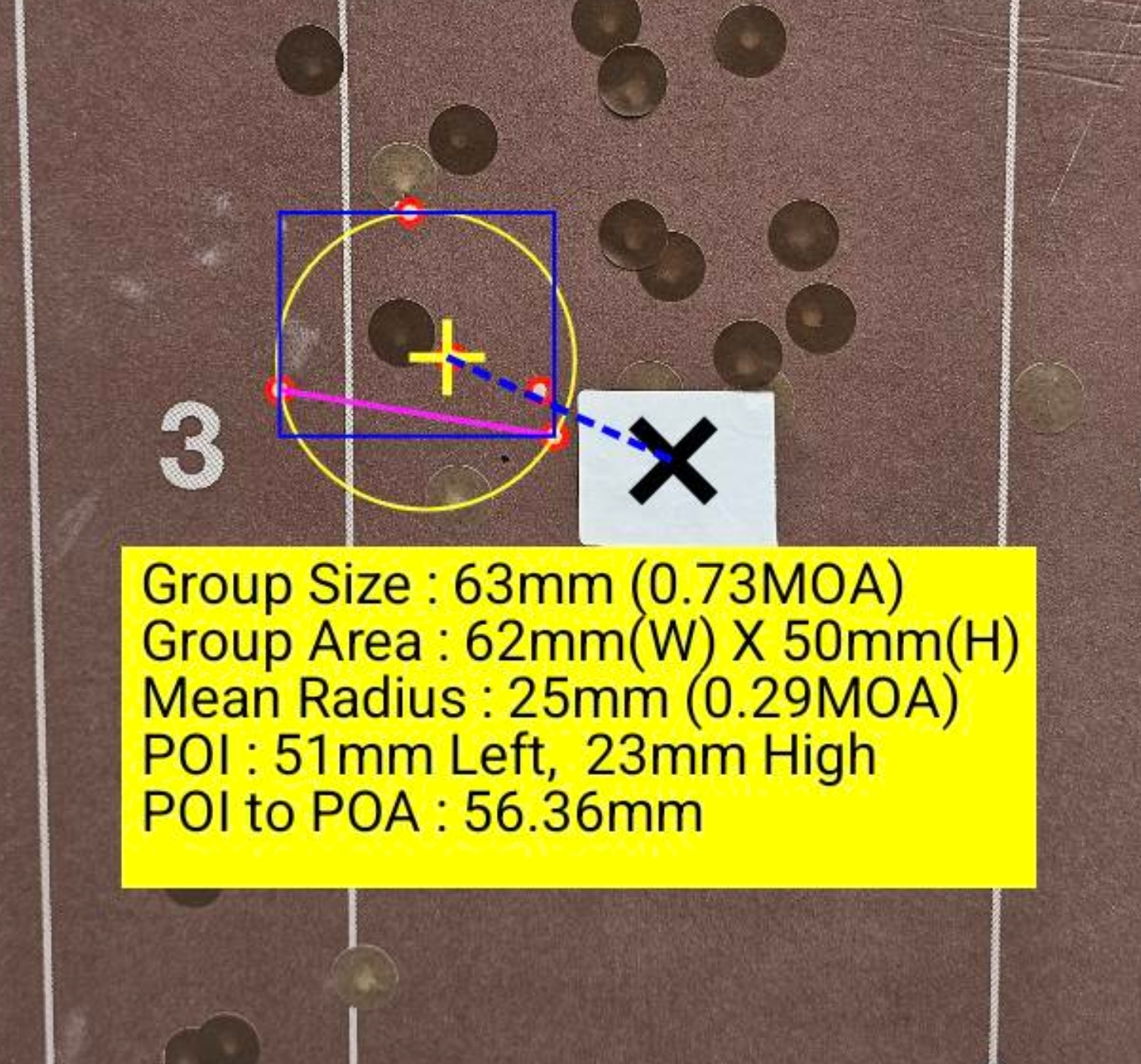

I just shot the loads I had loaded initially that were loaded with 24.7gr N540 / Sako / 450 at 300m and they printed well. 2x 1moa 5 shot groups. I even shot them quite fast.
I think I have a problem with 100m shooting, I guess I need to dial zoom down. The bulk I shoot pretty relaxed but all my handloads are not doing as well as they should. At 300m I pretty much just blasted away and still arrived to those 1moa groups. Maybe 10-15 seconds per group.

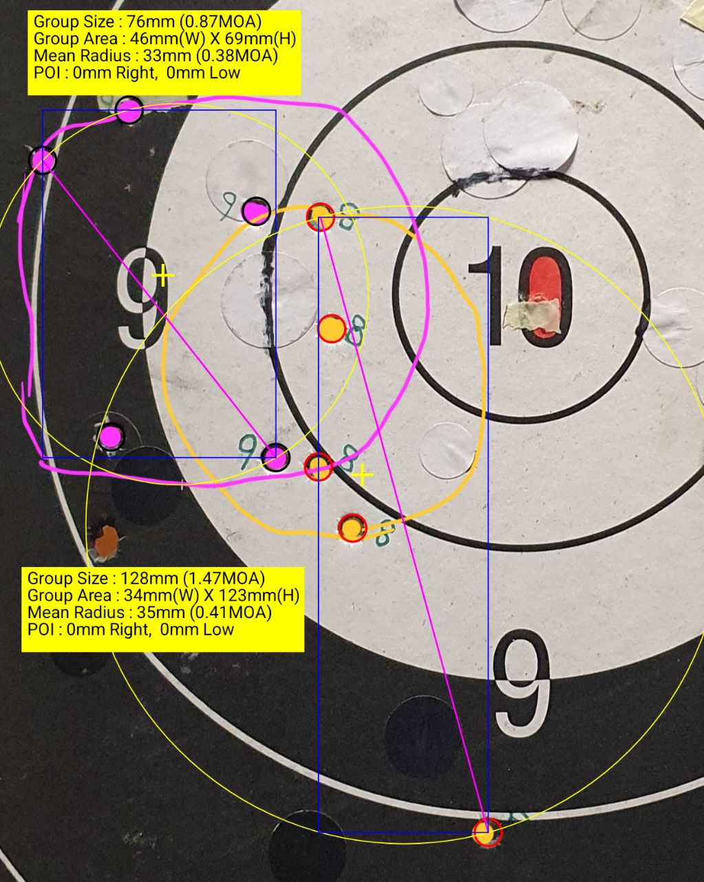

More 300m groups:
.9moa 1.59g / 24.5gr load, 5 shots.
1.5moa 1.58g / 24.4gr load, 4 shots .7moa. I shot # 4, was resetting position as I noticed 1 was still left and maybe shot it too quickly.
The wind was gusty from 4 o'clock, up to 10mph. Group was .5mil off from last time and almost 1 click up. I am using 1.5U and 0 windage for load testing to keep easy comparability and logging between groups.
The 1.58 and 1.59 loads were based on test of 24.1gr to 25.3gr below, I primarily wanted something close to my 300m scenar zero, with reasonable pressures. Almost all loads showed small bolt markings but it was barely visible even on the highest charge. I guess PMC heads are a bit softer than Sako and Geco, although they have more volume. Also this test was ran in too much hurry, I spent maybe 15 to 18 minutes at the range all in all.
I already loaded plenty of 1.585g / 24.45gr loads and will see how they perform. I do feel I should maybe try the 23.9 to 24.1 side, closer to Molon's recommendations, but let's see where this leads to.

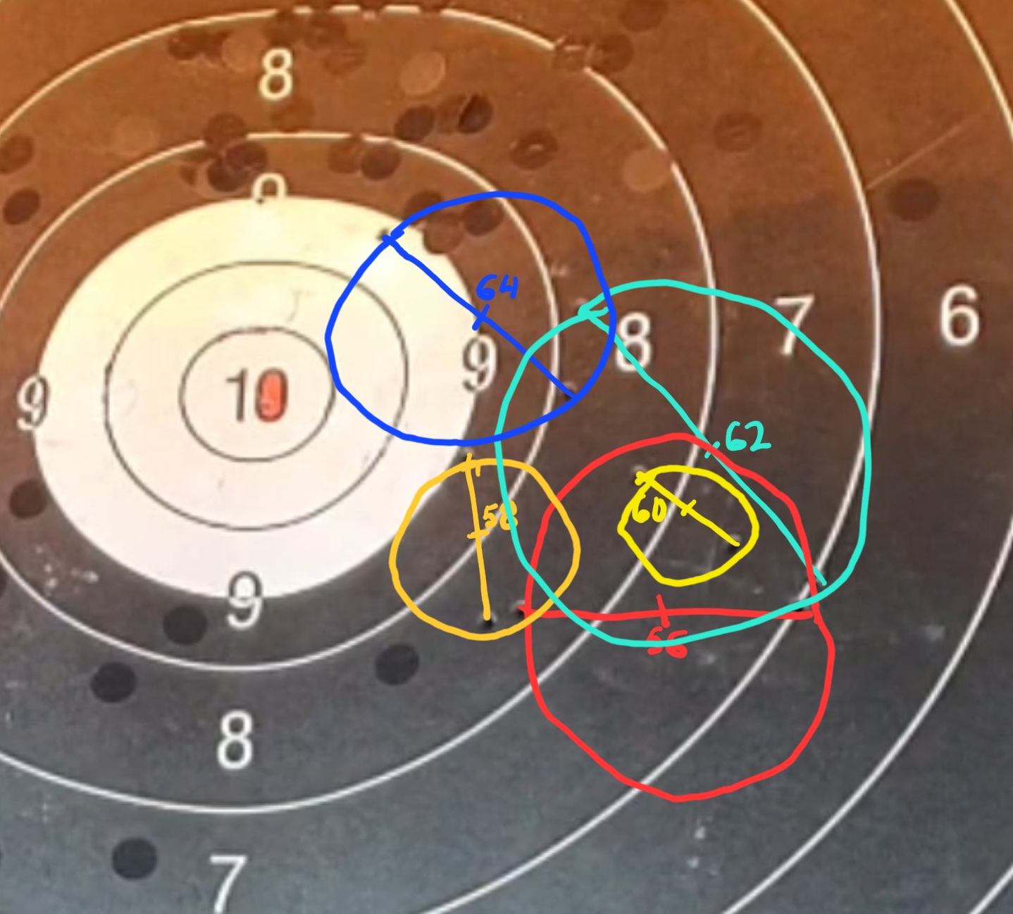

Yesterday I hit the range again but the wind keeps on. I tried the basic load 24.45gr and first group got 0.8moa. The second got 1.3moa but I was too dumb and forgot to wipe the snow off, (retarded task because it will take some patches off, which are impossible to replace on damp target) and it ruined my POA. So it could have been better.

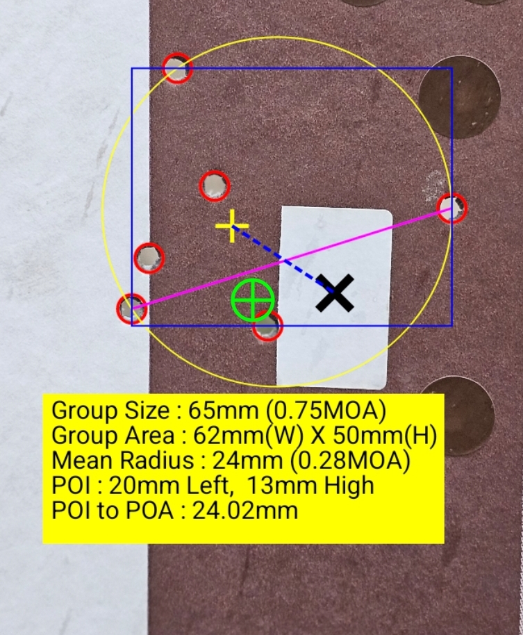

I have already shot 2k of Hornady BTHP from my Lothar barrel and sub moa 5 round groups are the norm at my 300m range. This is with

My current load is:
PMC brass, uncleaned, nylon brushed neck
Ginex SRP primer
Hornady 75gr BTHP at 2.28", I noticed my accuracy improved a lot the longer I loaded them and this was the longest I got to fit in pmag with the grooves made in them.
N540 24.4gr
16" Lothar barrel, 2740fps, 14fps mean SD from multiple sessions
I have now shot these twice out to 1200yds and few times at 770yds and the Kestrel with G7 value of 0.180 has held up very well. I added some pictures to my last post too, but basically this round has incredible performance for value!
I tried this load with 2.28" and 2.25" COAL in a LMT and it ran around 1.5" with the shorter COAL running better, so I guess that this longer COAL preference is specific to just my gun.
