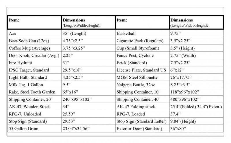

Yes, once you have a handle on using your scope for ranging, you can make a list in your data book of objects with standardized measurements that you may encounter (license plates in the U.S. for example are all 12"x6"). You can also make a ranging cheat sheet by plugging in what you would mil out the various objects (the license plate for example) at different ranges. Then you can just quickly look at your sheet instead of going through with the full equation. Street signs are also almost always standardized as well. Knowing a little bit of code for houses also reveal that many of our residential doors (non-custom) also have standardized measurements. I would obviously caution you about being visible in an urban setting pointing a "scary rifle" at different objects...
Objects like fence posts and other lumber are typically labeled as being standardized, but all have a certain degree of deviation from the dimensions on the labels. In the military, we measured out items on different military vehicles (different vehicle rims for example) since it doesn't get much more standardized and uniformity than the military.
