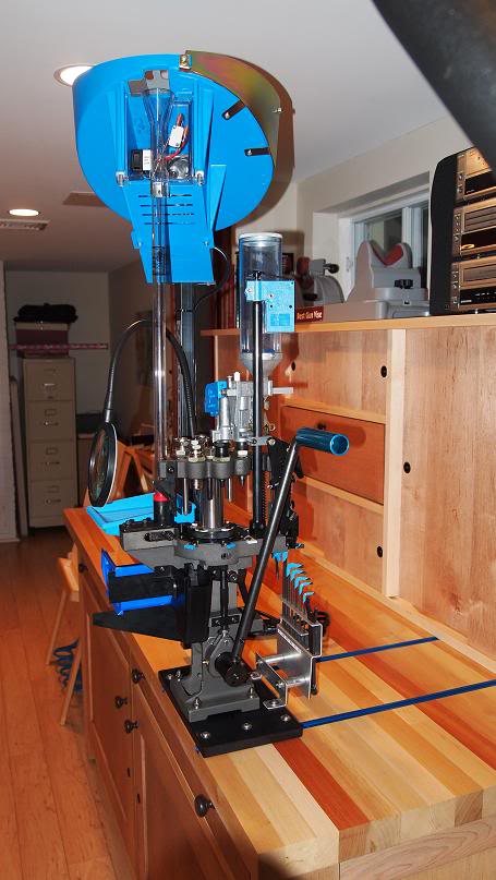

Dillon is my vote. I loaded countless rounds on a 550. A few years ago got a 1050, love that thing.
Then I added this... I just sit back and add primers and cases and bullets to feeder.
Processing 223 brass is so amazing, swaging on press as well as having swage sensors so you don’t get ringers.

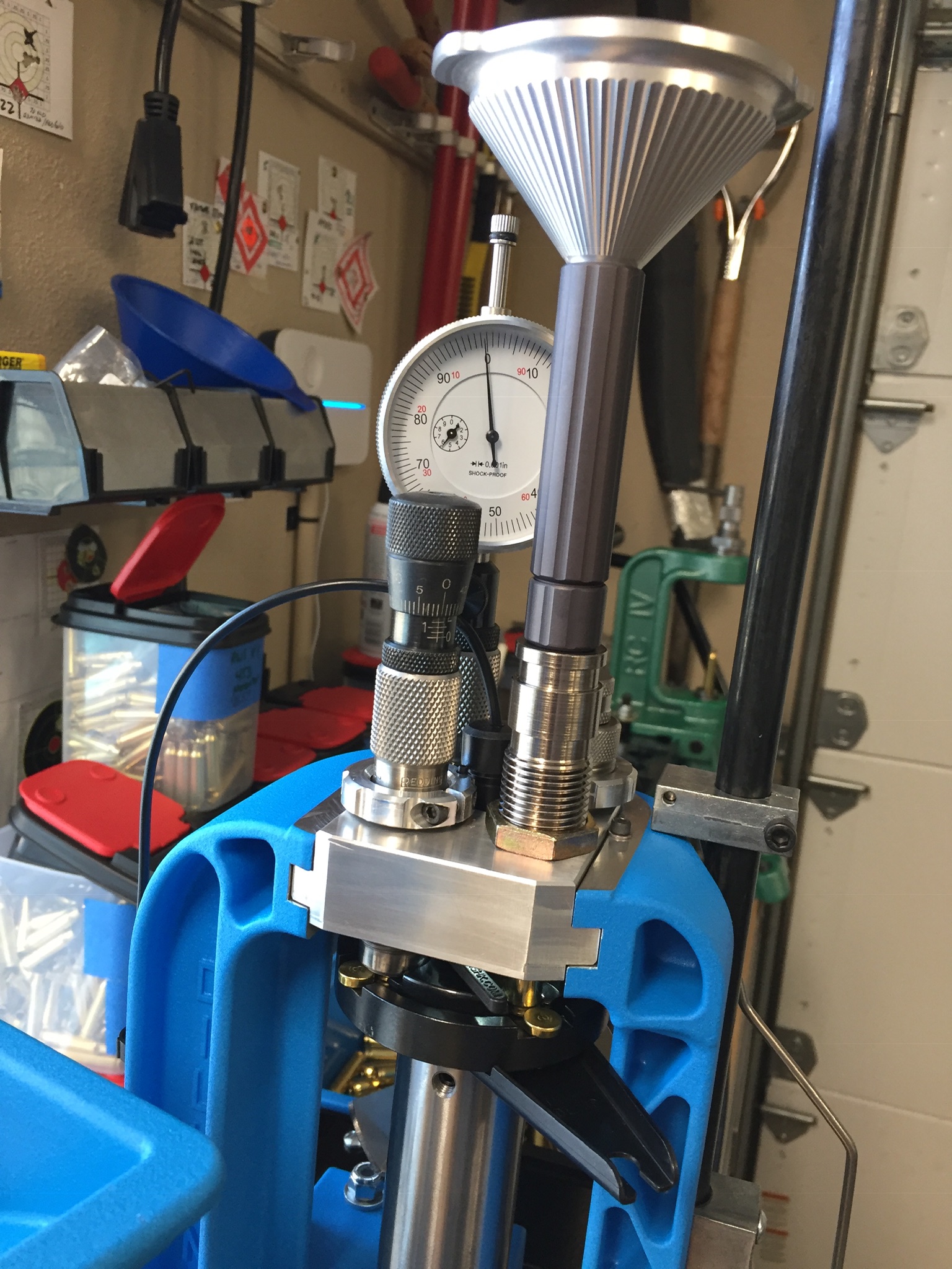

Just moved up to a 550 from a Rockchucker. I run it as a single stage, but it lets me measure every round before it comes off and back up and reseat if long.
Expand, pour, seat and measure.
I like it.
How are you measuring OAL? I see that mic on there... If it's from tip to end you'll get varying results anyway. You wanna measure from the ogive to the end (the Hornady setup is nice for this, I had a cheap set of Frankford Arsenal calipers I permanently setup that way). If you've got something on there so it measures from a consistent spot, disregard.
Unless the seating die moves, the OAL should be consistent. I usually check the die by hand every so often and measure every 50th or 100th round... With BMG I don't have a comparator so I'm stuck measuring it from tip to end and it can be off by almost a 1/10".
It’s the Redding instant indicator, it measures off the ogive. Setup like it is, I keep my seating tolerance within .001.

I'm going to give my Dillon 550 a whirl with 6.5CM, 41.9gr H4350 and 140gr ELDM.
I'll probably do 20 or so rounds first and see how they shoot, if it's on par with my RCSupreme and Chargemaster, I'll be all set.
The way I normally load 6.8 SPC and .223 on my 550 is in two stages with two toolheads (Prep and Load).
Toolhead 1 (Prep head):
Station 1: FL resize/decap
Station 2: Empty
Station 3: Dillon Trim Die/RT1200 trimmer (will be empty for 6.5CM)
Station 4: Empty
Tumble to remove lube
Toolhead 2 (Load head):
Station 1: Universal decap die (clear flash hole)
Station 2: Powder drop (UniqueTek micrometer)
Station 3: Bullet seat
Station 4: Empty (or Crimp for 6.8SPC)
Once my brass is prepped I can blow through a lot of rounds in one sitting. I'm only loading 100 to 150 at a time for 6.5CM so it's not a ton to do with a RCSup and Chargemaster, but I know the Dillon 550 will be faster, but hopefully the results will be as good.
