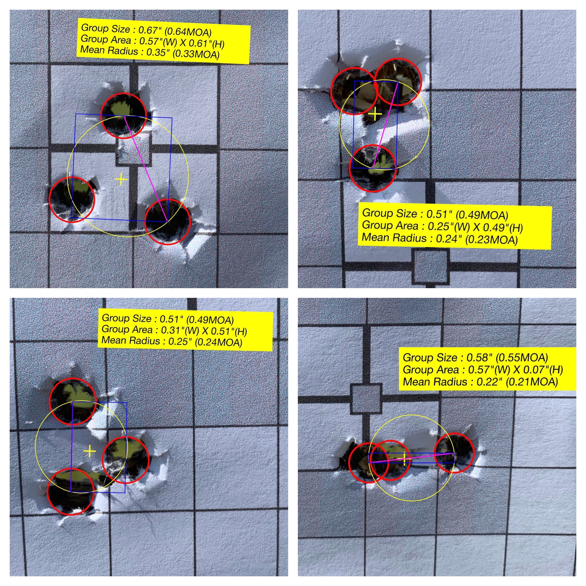

Well my experiment with my Dillon 550b and H4350 was a massive fail. My powders drops are .5+- off from my target load of 41.9gr. I guess I'll stick to the ol' rock chucker.
Some powders meter great, others give issues. I switched powders with my 243 because the powder i was trying to use was not metering well. Switched to ball powder, no more issues.
Yep. AA2200, H322, H4198, CFE-Blk all meter well for me. Varget and now H4350 have been two that do not. Oh well.
Well I tested some loads. Two of these are with my Dillon 550b and two are with rock chucker/chargemaster.
I don’t know which is which (I’m an idiot) but I’m 90% sure the largest one is from the chargemaster.
The position of the shots relative to bullseye isn’t important, I was resighting in my rifle with the can on since I tried a match without it last weekend.
