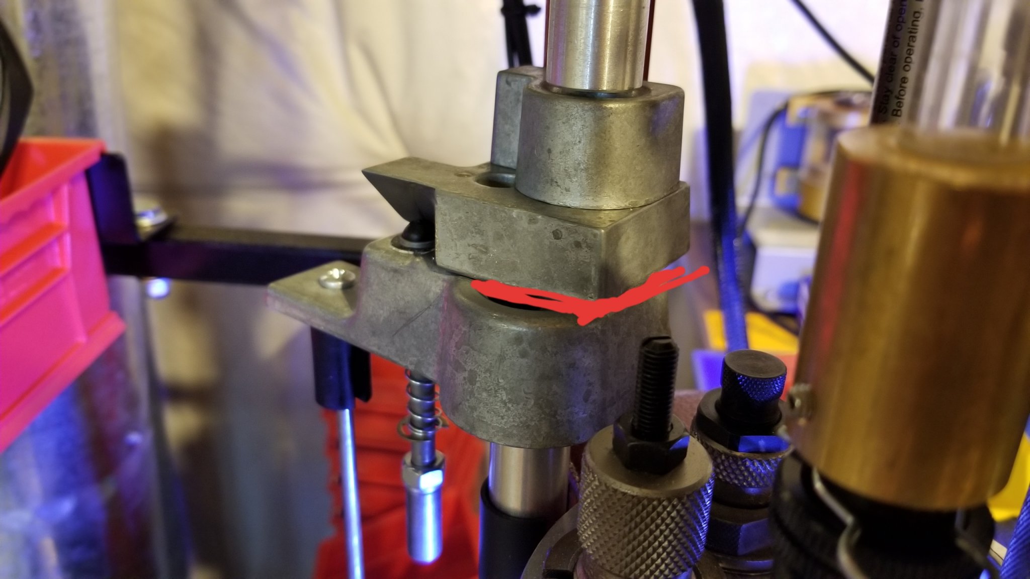

I put a Hornady together last year. I honestly had a couple times that I wanted to just set it on fire.
Then I figured stuff out. How to adjust the timing. Most importantly, how to keep the case feeder running... all it needs is some lube in the right spot.
If you buy a case feeder, the area in red is where you need some lube from time to time.
Once I lubed that, my issues went to basically zero. Now I can dump a hundred primers in the feeder tune, hundred cases in the case feeder, and a hundred bullets in the Mr. Bulletfeeder and crank out those hundred rounds in about ten minutes or less.

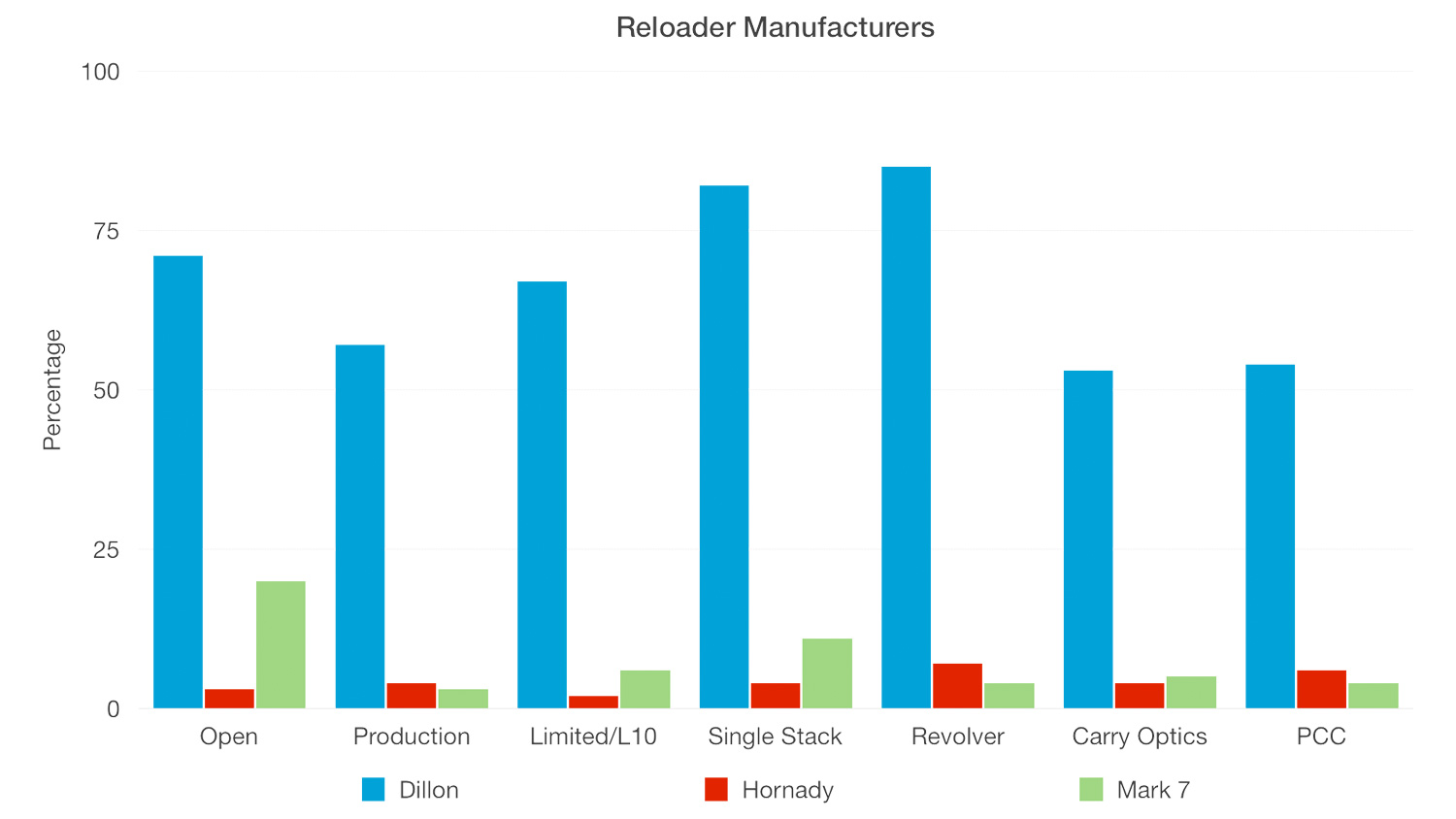

Yes, I thought that was interesting also. Those Mark 7s are an impressive machine. Think about this. The Dillion category includes everything from a 450 to a 1050 (although most are 650s and 1050s.) The Mark 7 is just one almost $10,000 machine. Virtually a commercial reloading set-up, much like a fully tricked out 1050 with auto drive. Those Open guys are a serious bunch.

Once I got the case feed lube thing figured out I've had essentially zero issues. Don't get me wrong, I read about issues other folks were having, looked at it, and thought how do I avoid that coming loose.
The only things even capable of coming loose are the case feeder slider and maybe the shell plate.
I put a split washer on the shell plate and nylok nuts on the case feeder adjustments, they've never come loose.
The big hassle is the pivot assembly but I already posted how to solve that.
