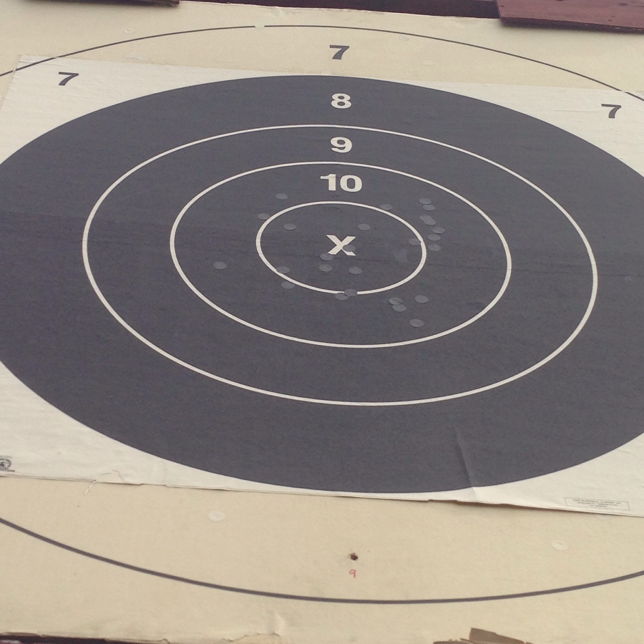

Shot a match today from prone with sling. Best string I could manage was about 1.5 MOA. 20 shots for record at 1000 yards with a .308 Palma rifle, shooting with sling and iron sights. Score of 200-8x.

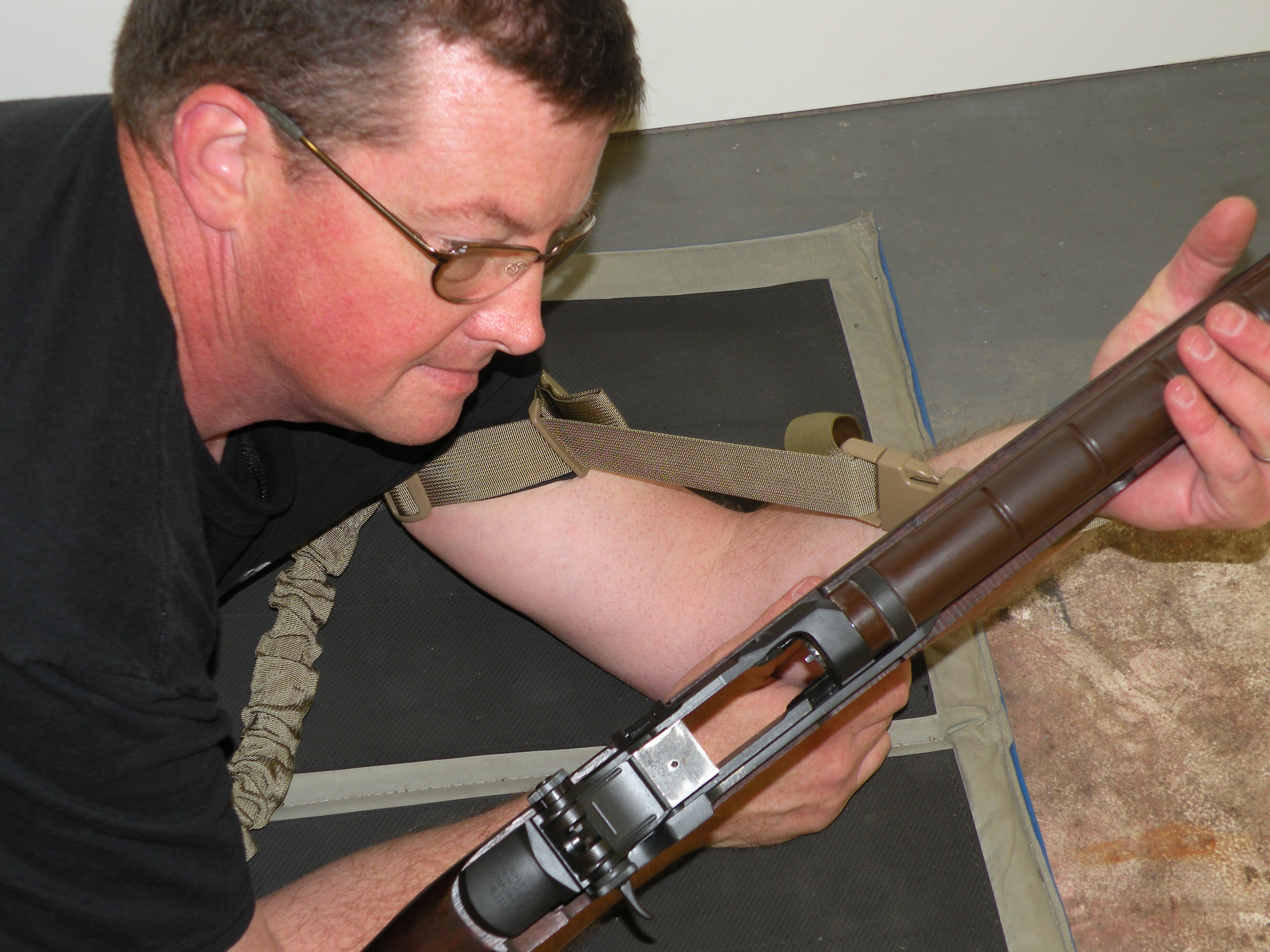

Well folks, if I can start posting some pictures, there's two things you notice: First, I'm not a Hollywood actor, and I don't look like one either. Second, it might be better to let the pictures do the talking instead of 1,000 words. Let's see where this goes... Oh, and if my sidekick wants to get involved, he's more than welcome.
This first picture is used NOT as a practical analysis, but rather to show that you start with the above position (roughly), then you simply add the rifle to it. In this below picture, you'll notice that the rifle is placed far too forward in the FORWARD hand, and as such, the butt does not touch the shoulder...
You'll also notice too that we've not added the sling yet. It's important to understand the fundamentals of the rifle and the shooter, before adding the sling. The below picture shows the rifle slid back into the shoulder, while the forward forearm maintains roughly the same angle. This is important. The body's position remains the same, the forearm remains in the same location. It's just the rifle that has moved.
The location of the hand on the forearm of the rifle determines the pressure of the butt into the shoulder. THE SLING'S JOB IS NOT TO PULL THE RIFLE INTO THE SHOULDER, REGARDLESS OF THE FORWARD HAND POSITION. Please read that again.
Now, this is your first practical exercise: Get into the prone position, and get that forward forearm at somewhere between 25 and 35 degrees from the floor. Place the rifle into this position, and slide it back until you get solid contact into the shoulder. MAKE NOTE OF THE FORWARD HAND'S POSITION ON THE FOREARM OF THE RIFLE. (Piece of tape or some kind of mark works well). You have not yet introduced the sling. Do NOT do this exercise with the sling.

The next series of pictures show the progression of donning the sling, of "wrapping the sling", and of attaining roughly a good prone position. Thousands of words could be used to describe the progression of steps, but I hope these pictures do a better job than words. Again, please forgive the mug.
