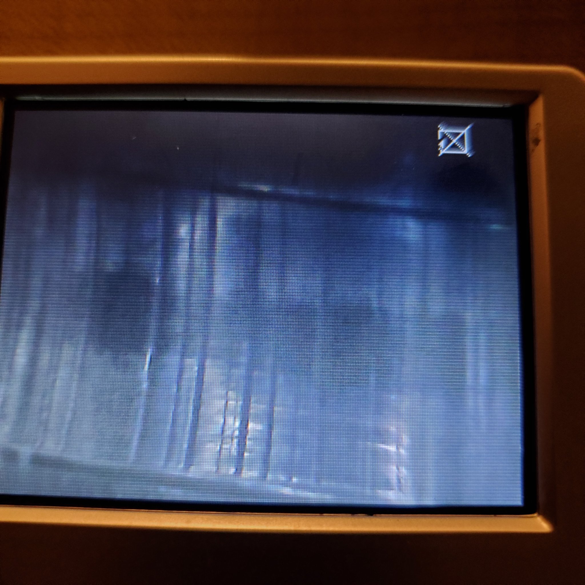

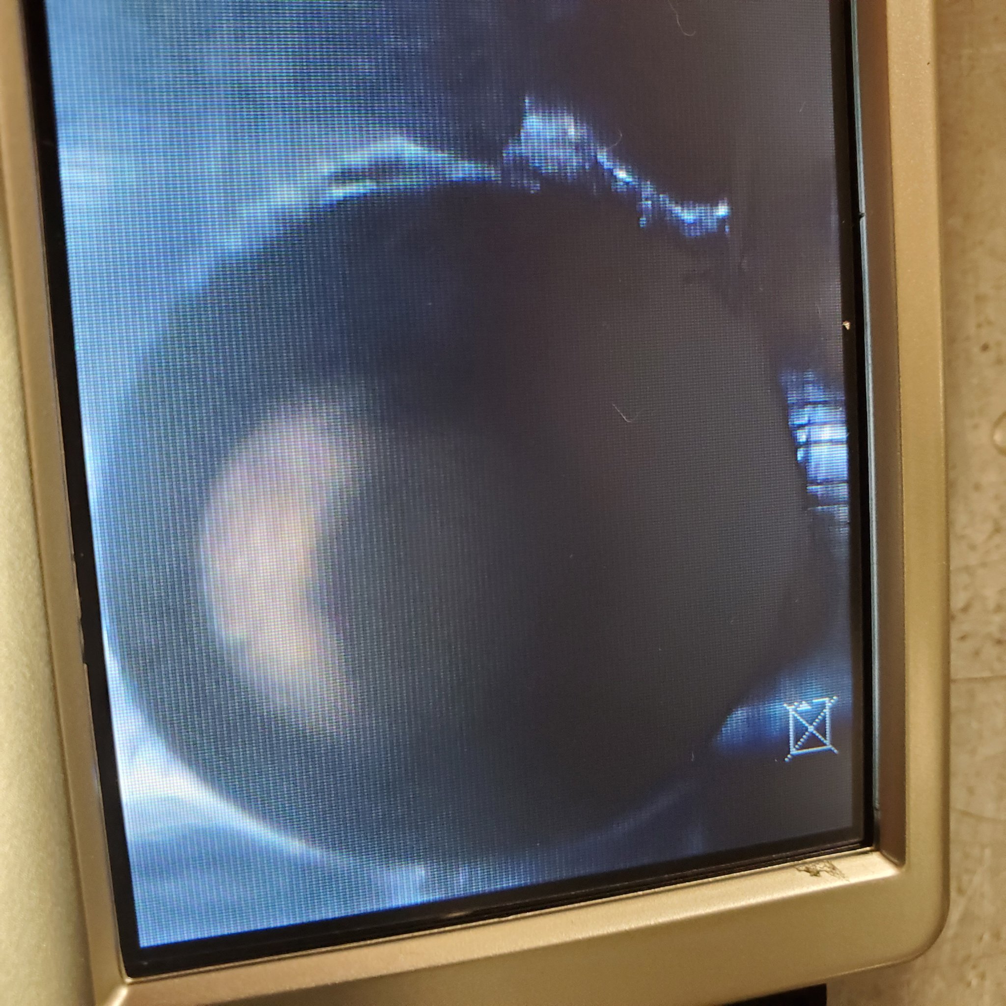

Mostly I just fix the problems myself and never send back a barrel unless it scopes out bad.

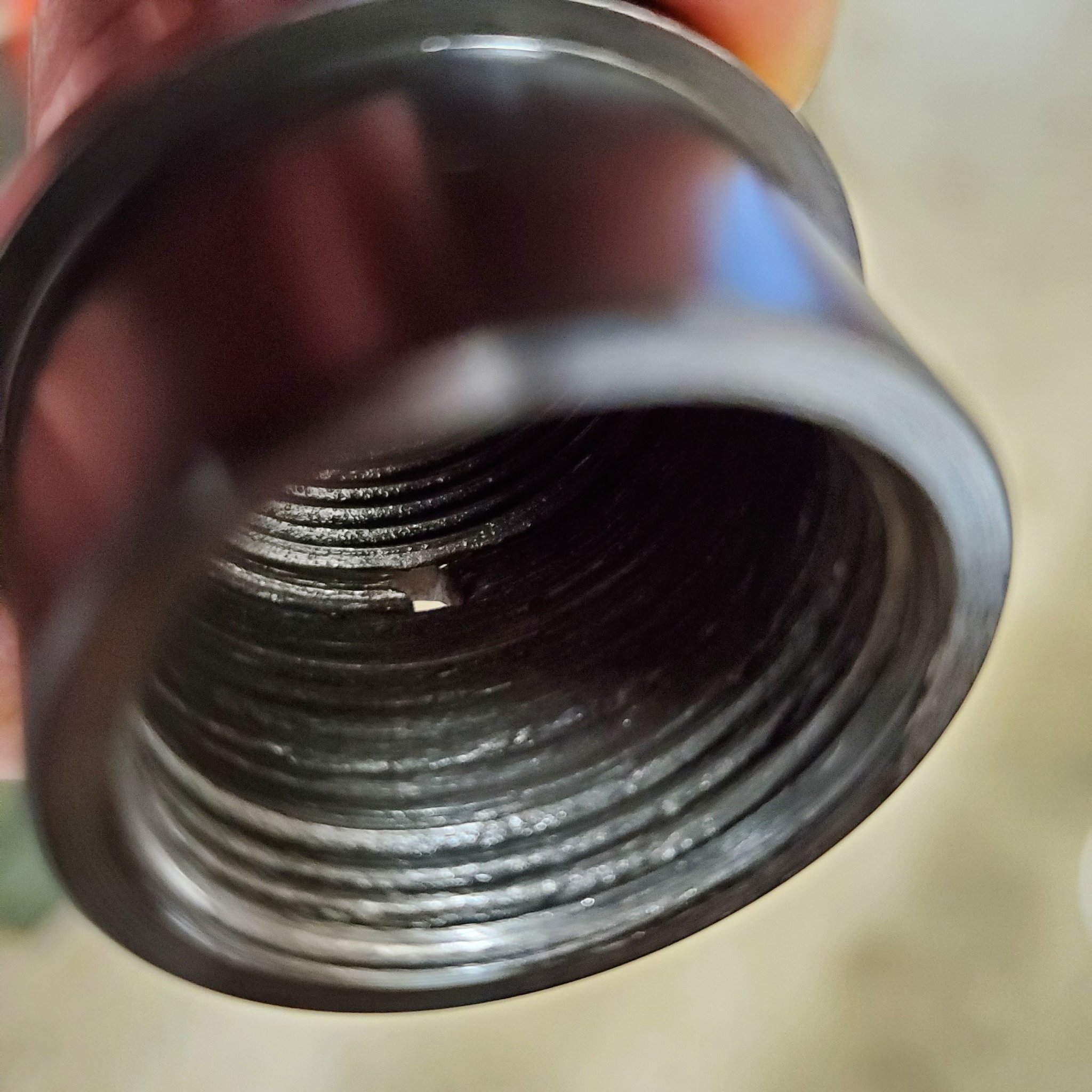

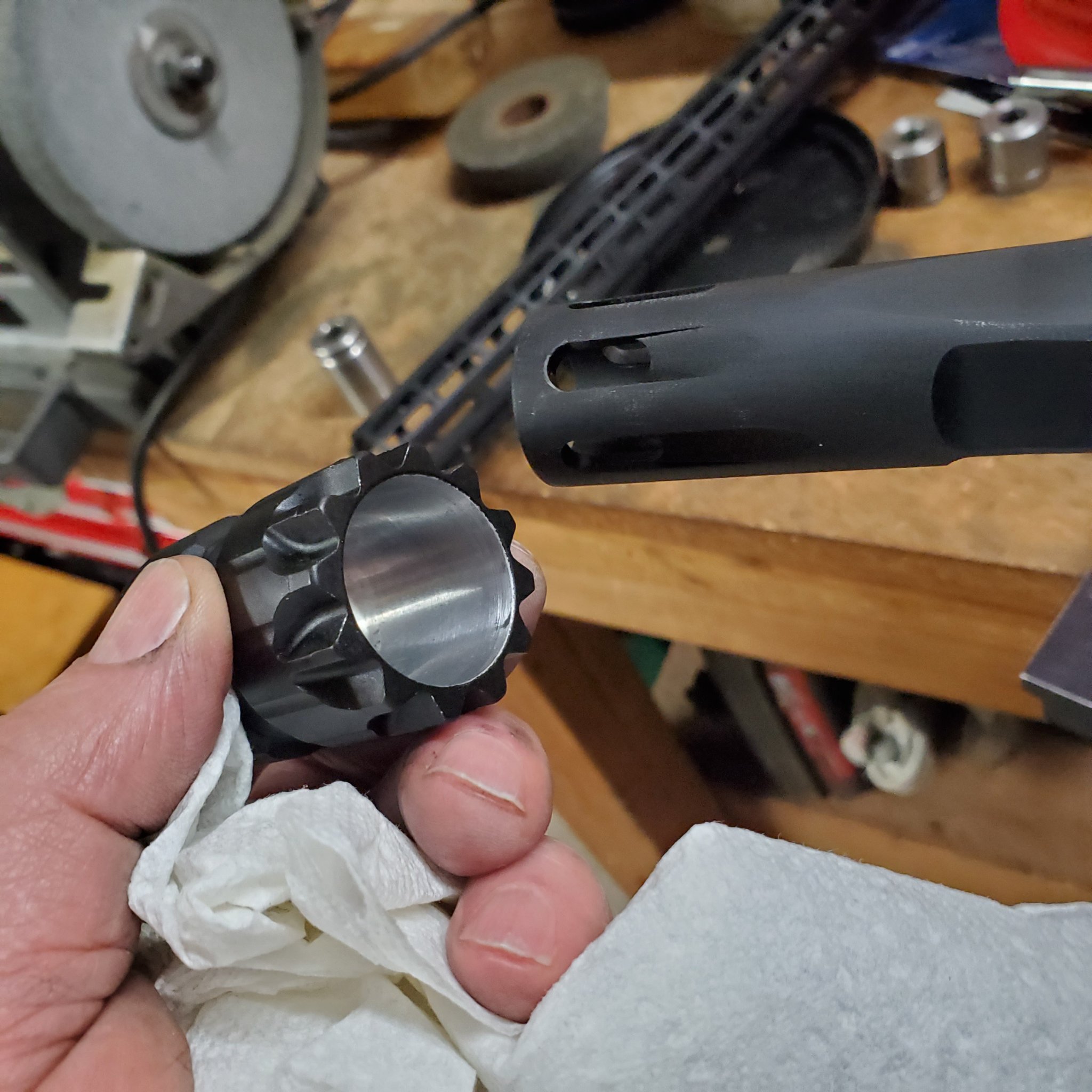

Here a 9mm AR barrel had to be rechambered as it was chambered at the factory with a worn chamber. I bought the chamber reamer from Brownells.
The barrel nut ID too small to fit over the barrel, had to be bored out!

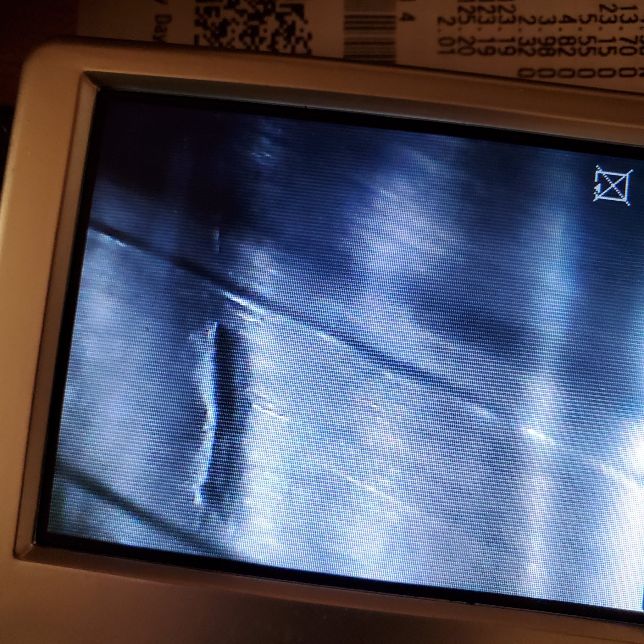

And typical problems with even moderately priced barrels, and why it's important to have a bore scope.
Parts don't fit. Galled and torn threads, are all coming from today's manufacturers, especially when the got behind, in production.

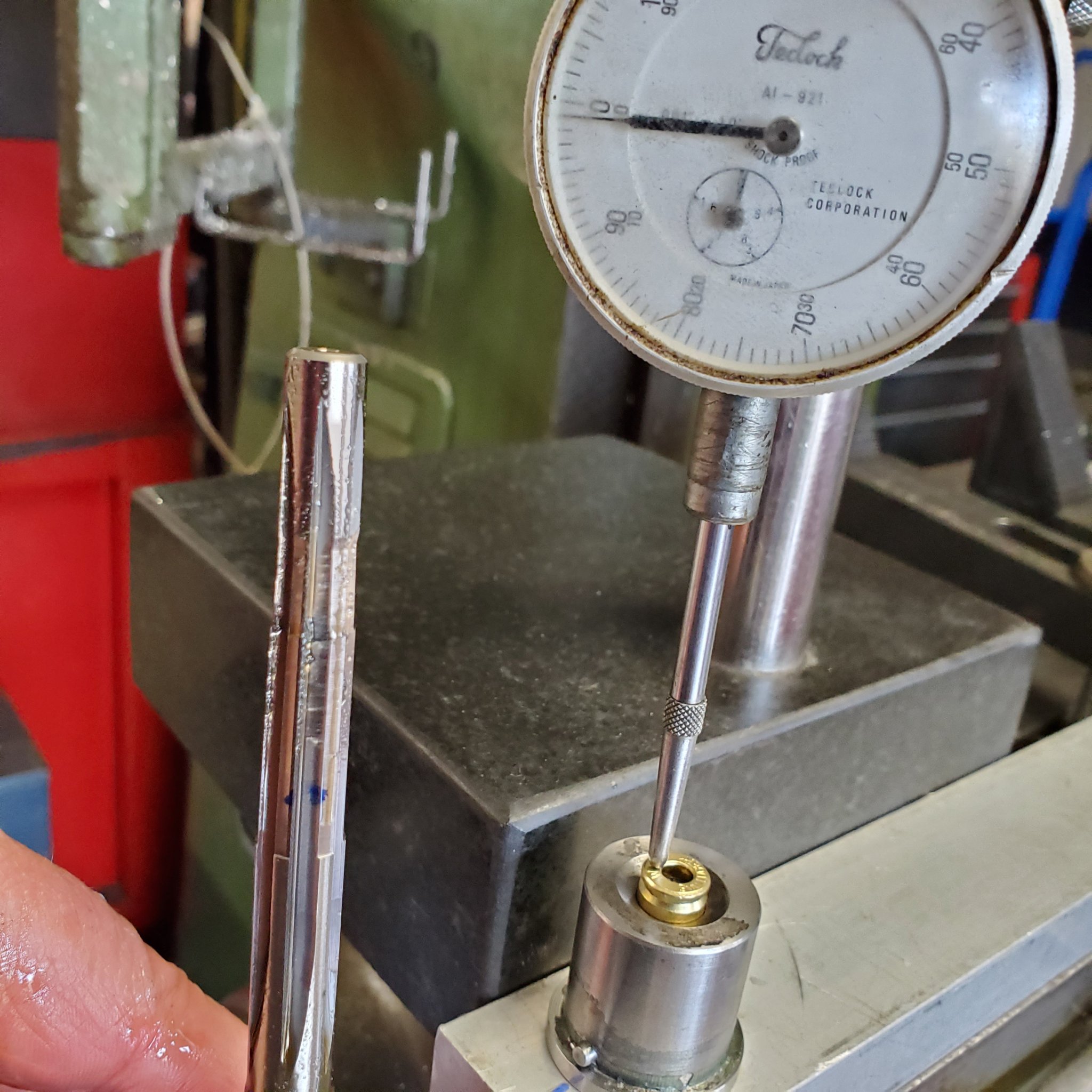

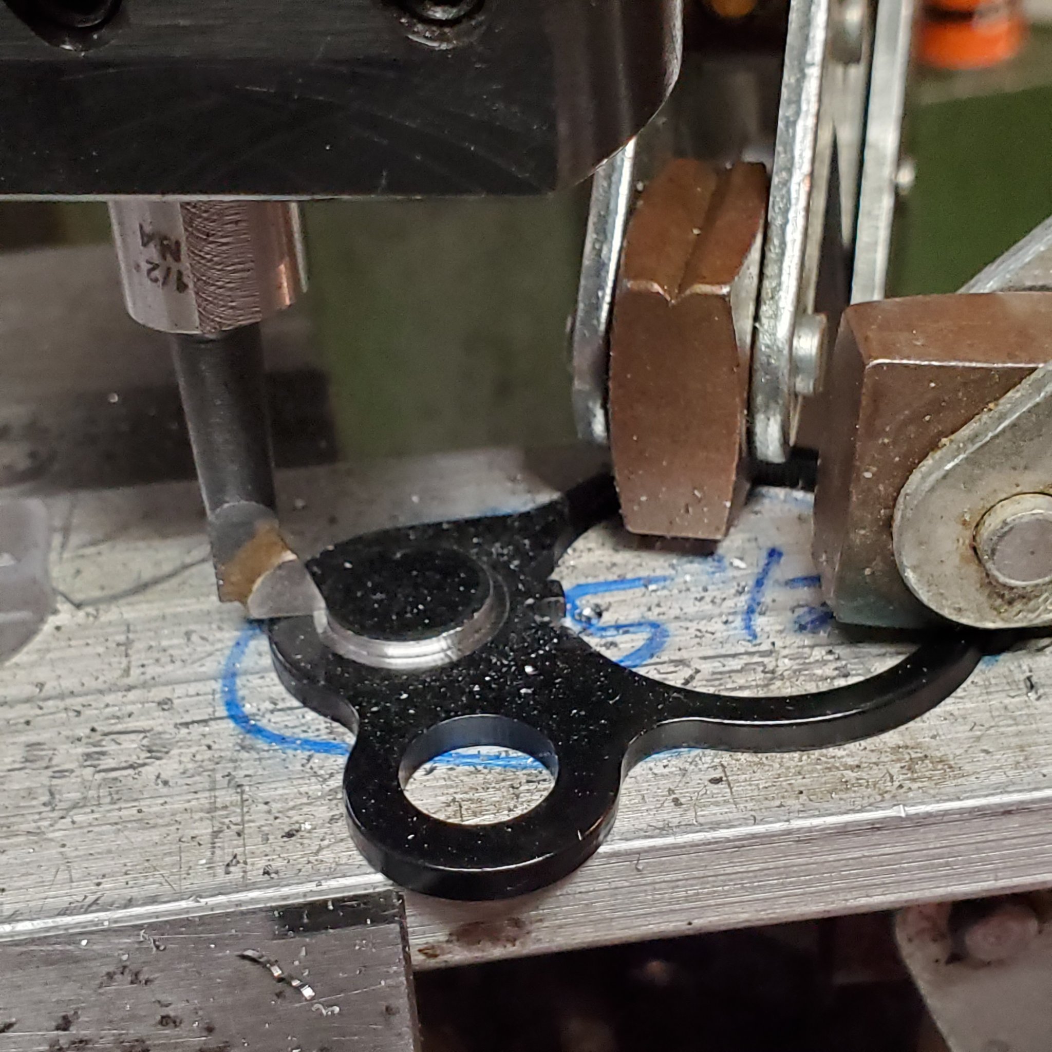

Proof Research has been a shit show for awhile now, thier prices a so close to what you'd pay for a Custom Ordered Barrel, why roll the dice with them? When their barrels are done right, they're tac drivers but definitely not worth the risk of setting you back if you have to play the circle jerk game with thie CS. To be completely honest I was shocked when Rudy told us the LPR was going to run PR Barrels...

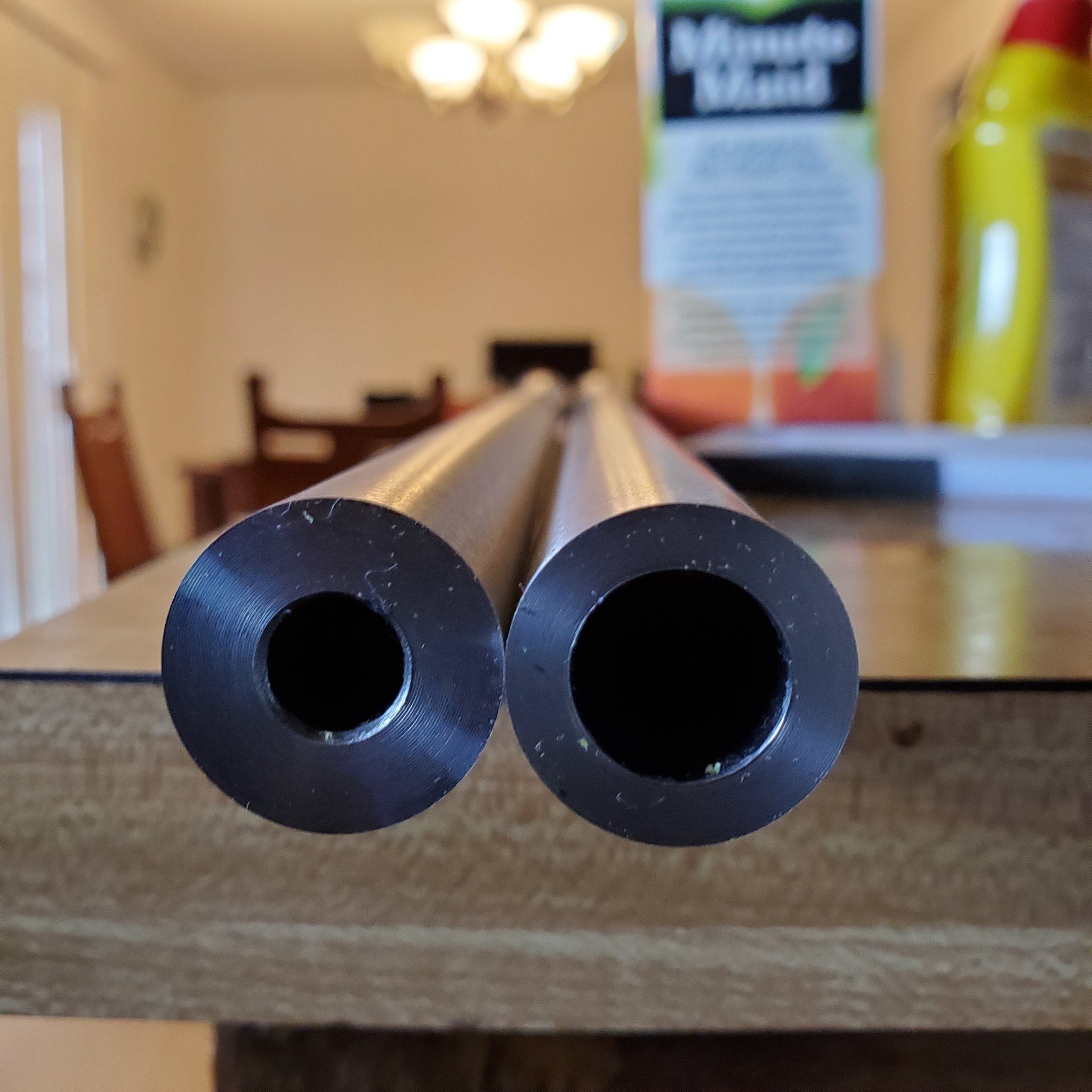

I order custom barrel blanks and complete them, for both AR and bolt guns.
But the ARs are usually something totally unavailable in the market of mostly twist rates, that I desire for a build. Odd ball or obsolete calibers.
These pictured are an examples a .338 6.5 twist .510 10 twist for odd projects, only I'm interested in. They were purchased at the same time, but took a bit longer than stated, to arrive.
I can do my own AR barrels, but like the option of using Proof Research, when it's standard caliber/ twist fare.
Sad to here their quality is slipping, and they seem indifferent about the situation.
It takes a bit more time with AR barrels, profiling the barrel, barrel extensions, gas block journals, determining the gas system, drilling the gas port, etc.
