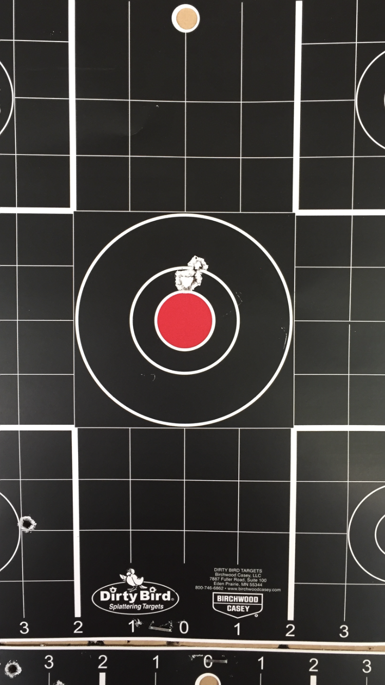

First time taking my Proof with .223 Wylde chamber out when I got it. Shooting 77gr FGMM, 5 shot group.
Does it still shoot like that? How many rounds down the tube now?
No BS, this was the first outing with the barrel, first 5rd group I shot with it after 3 or 4 rounds for what was little to no break in. It still shoots the same if not better, depending on how much attention was paid while reloading. Groups now are produced with a Nosler 77gr, 42.8gr of XBR 8208, CCI 41's and br4's stretched out as long as the mag with accept them.
Have about 2k on it so far.
Can you really fit 42.8 grains of XBR 8208 in a .223 case?

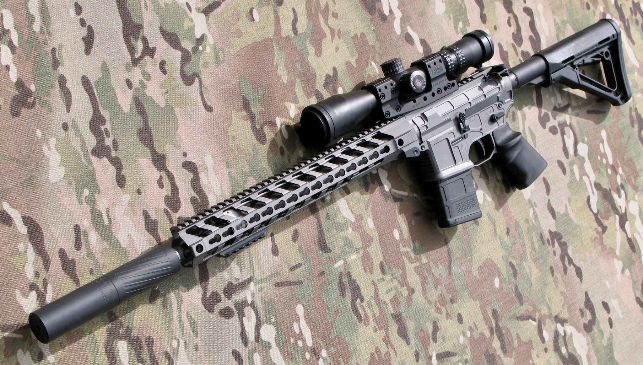

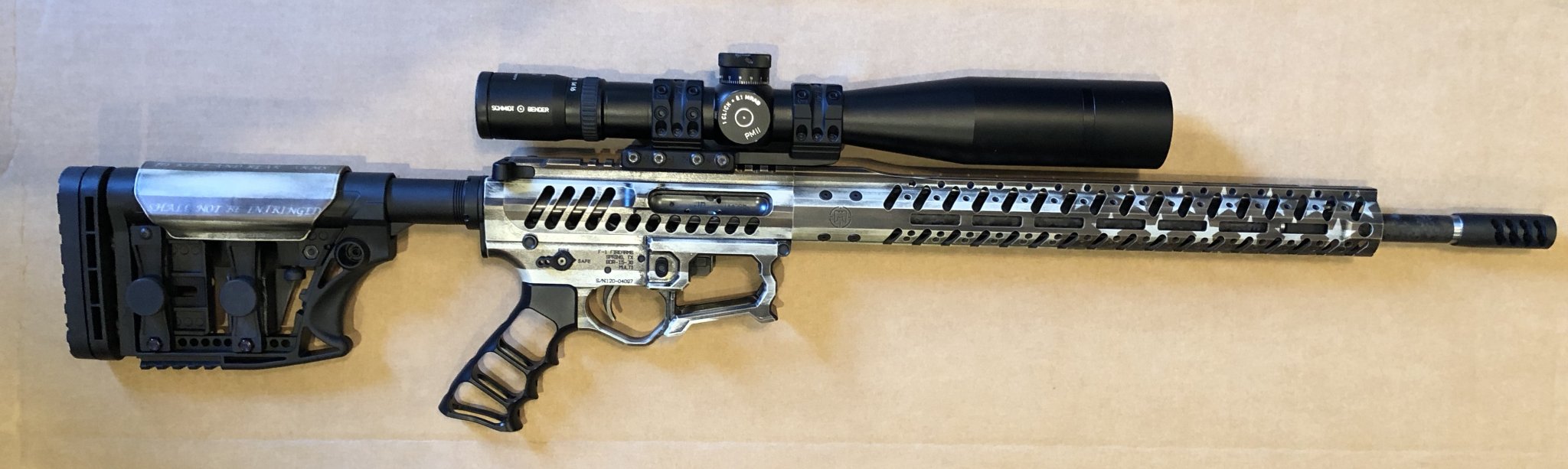

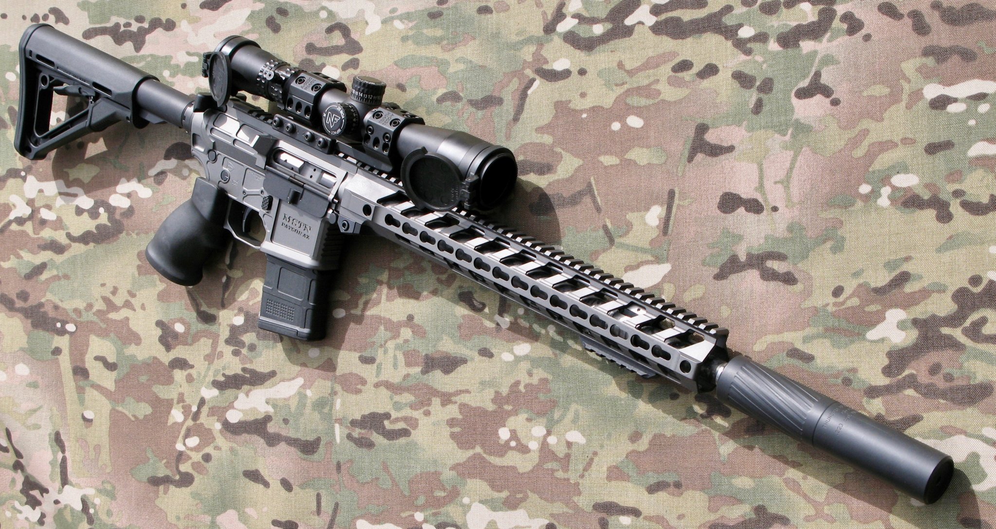

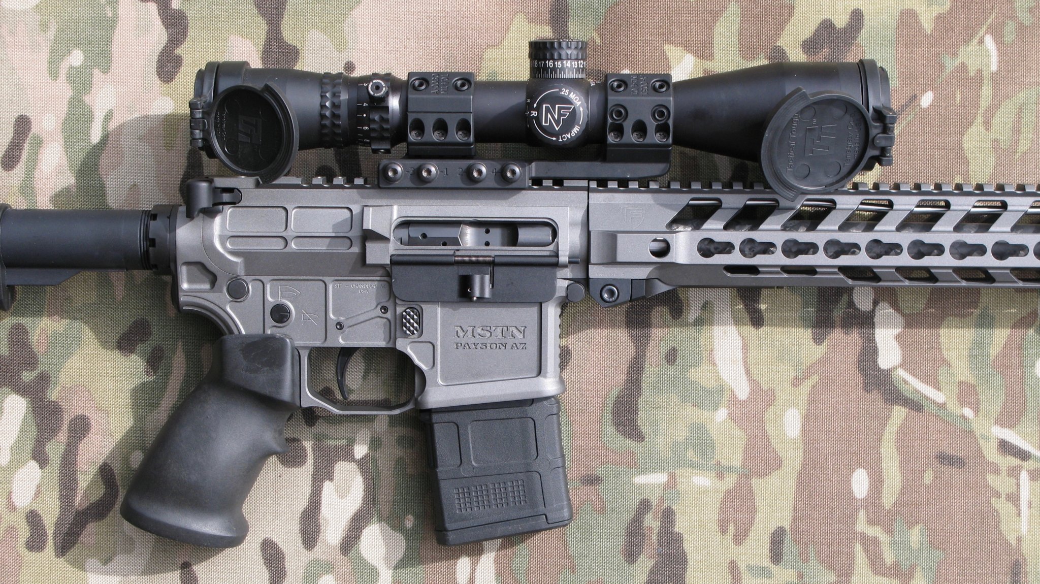

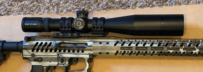

I’ve got a 16” and an 18” of my own. I’ve built up about a dozen for customers in lengths 14.5” to 18”. All have proven to be excellent shooters in the .4 - .6 MOA range with factory ASYM 77 SMK with the first groups on paper.
As mentioned previously, these are beautifully made barrels, with incredibly turned out chambers and throats. I can only assume these are honed, since there are zero tool marks.
