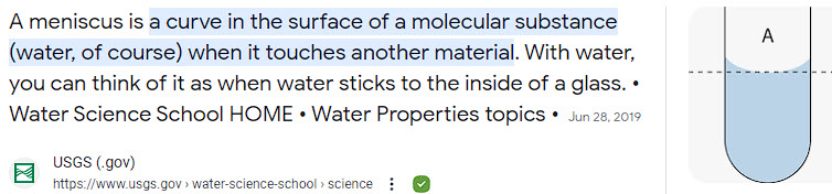

Zero your scale with an empty fired and primed case. Fill the case with water, dislodge any air bubbles, flat meniscus. Weigh the water.
