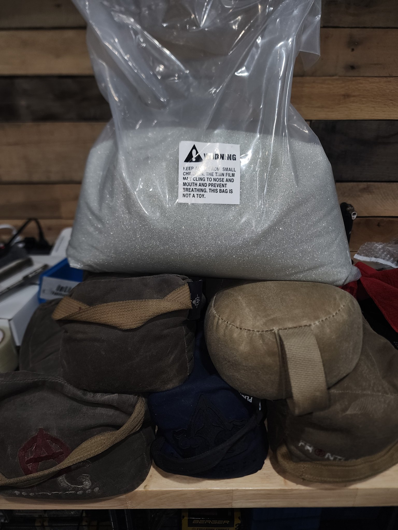

Figured I would start a thread so people can talk about Bags and Fill options. I got to play with some spexlite at a match recently and am thinking about ordering some of this stuff. I have 25lbs of bags in my kit, and would like to take some of the weight out of my pack. All the bags have had some fill removed so they are more shootable. I used to run glass bags but they have gotten so heavy and end up tearing up the bags. I usualy only get about a year out of a gamechanger before the seams blow out and I just replace them. I am thinking a lighter fill will be less wear and tear on the bags and as long as its still shootable, could be a move in the right direction.

The heaviest spexlite beads 5235 would be about 5.5-6Lbs in a Plus one, so about half what the heavy sand is. https://www.boxtobenchprecision.com/store/spex-lite-5235
There is also the Olympic mix which is 5325 and 5125. https://www.boxtobenchprecision.com/store/spexlite-x-ginny-thrasher-olympian-shooting-bag-fill

Have you experimented with any of the spexlite fills and blends? They are supposed to resit water similar to sand, without the additional weight.
I may just order a 5 gal bucket of it and test it.
