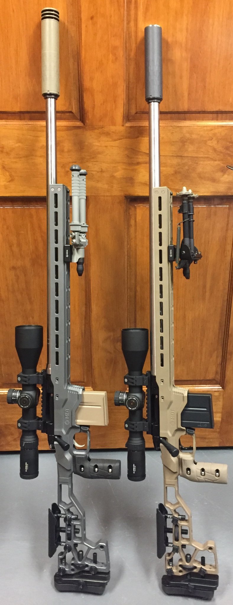

Yeah I think I'm sold on the origin. Now to pick a chassis! I am leaning towards mdt ess
About 180 cad
Get the acc. Plain and simple.
The built in arca rail is worth a 100 buck add on rail alone. Plus everything else.
Unless you’re doing night vision with the ess enclosed foreend the acc is what you want.
I think the acc would be leaps and bounds better then the ess if you’re going to do PRS. But, I LOVE my MPA matrix. And Altus usually has them in stock and sometimes they throw in weight kits on certain deals. I got mine with an internal weight kit and custom color for like $1300ish? This is my Origin build
Maybe it was $1400….I don’t remember but I love it and all the different ways you can customize the grip/thumb rest to your liking

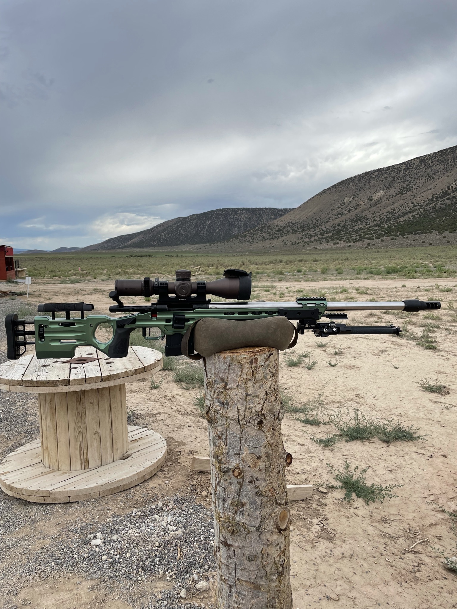

Why is the Kelbly Atlas Tac never mentioned in these conversations? I understand it doesn’t have the ability to swap bolt heads, but the tiny bit I’ve messed with an Atlas or an Origin I was more impressed with the Atlas.. I wish someone would light up the Prometheus thread, those Kelbly boys seem like they are straight up! To the OP: I would just get an Impact, it will be cheaper in the long run..
100% the atlas is fantastic! I have a bunch of actions they the kelbly atlas doesn’t drop anything to any of them
