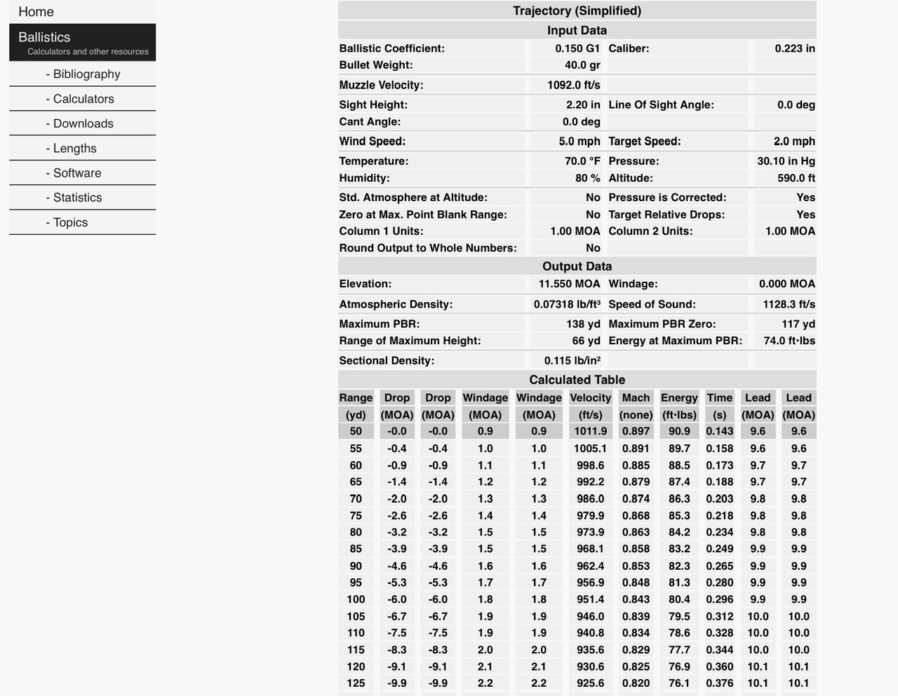

If you do not know how to get data for going from 50 to 100 then you have a larger problem than the scope. Have you heard of ballistic programs? You put in your rifle, bullet, and environment and it gives you the number you need to dial to get from 50-100. Just looked at my data and it’s about 6 moa. But for example say it’s 6.5 moa. If using your scope I would dial to the big number 6 on the turret and then if it has a 1/2 mark between the numbers I would dial there and if not then 4 clicks past the 6 moa mark.
And the scope being in 1/8 moa just means it’s a finer adjustment. You aren’t counting clicks all the way are you? Scope makers put a big number on the turret for a reason. If you need 10 moa are you going to count 80 clicks? I hope not. Dial to the 10 on the dial and you are there.

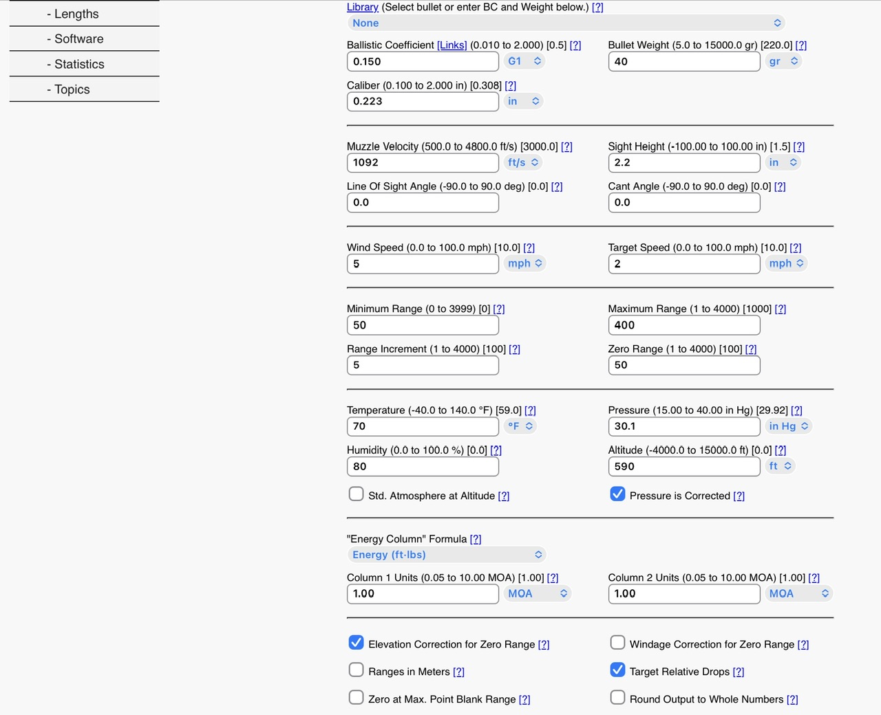

And here is the pic of the main page filled out for my rifle and conditions. And the second pic is the data that was given when I hit the calculate button at the bottom. Do not worry about Line of Sight or Cant angle or target speed. Give it a try.

The first three inputs in that pic can remain the same. You really need to get the velocity, sight height and then add your environmental info in the last 4 inputs which can be found in most any local weather data. If you don’t have a chronograph then just use the generic data for the ammo you use and it will get you close on paper at 100.
Just use that above and don’t mess with apps yet until you understand the above. It’s simple snd free online. When you hit calculate you can print that page and take it to the range with you.

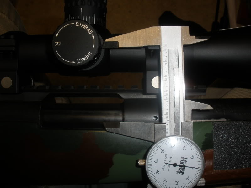

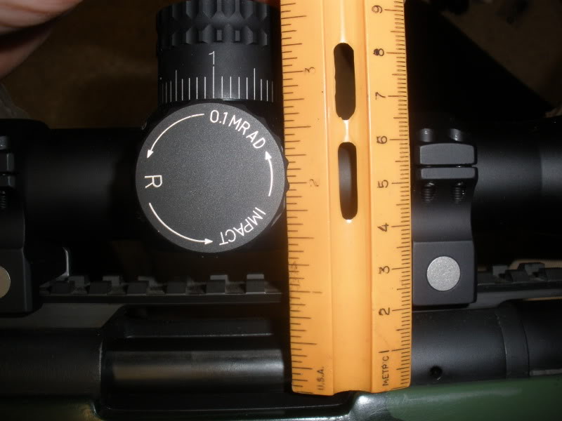

This is how to measure sight height. It’s that simple. Center of bolt to center of windage knob.
View attachment 8689109View attachment 8689110
Omg this is very useful info never thought to use the vent hole as the center. Thanks. I just got a garmin and will be using religiously.
