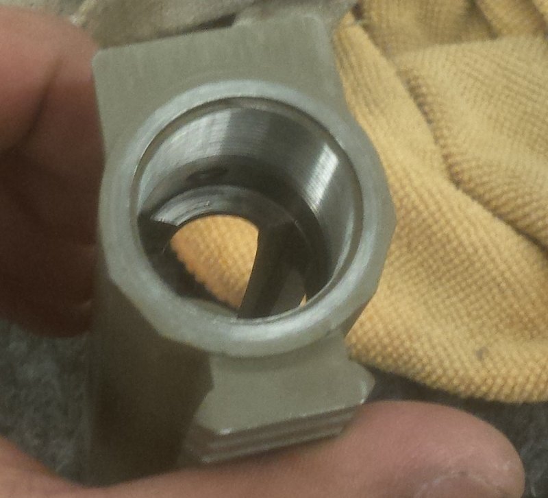

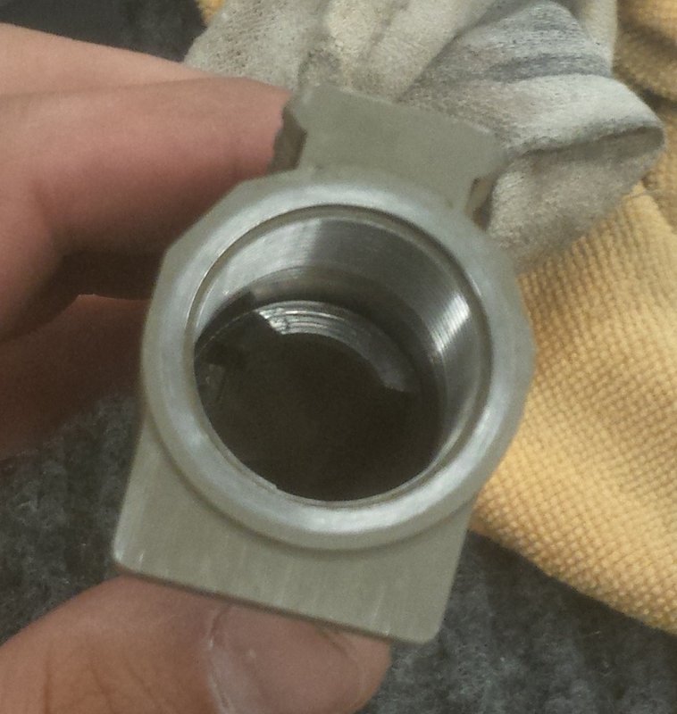

Defiances are slick enough, and now that they offer bolt bodies with smaller diameters than the receiver bore they do perform much better in dust. That said, they're relatively soft stainless steel and they do gall. This particular action is one that I took the time to take pictures of, but I've seen this with more than one defiance. Nitriding or DLC will help with surface hardness/wear (Not even going to get into the safety of nitriding thin 416 stainless parts, again), and I can't speak to the lube history of this rifle, but I do know it was in for rebarrel after about 1200 rounds from new when I took these pictures.
Not saying they're all guaranteed to eat themselves, or that the damage will get worse than this or that this is a show stopper, even, but it is unnerving to me, and the reason why I typically look towards Bighorn for stainless actions (40-45 HRC vs. 30-35 of Defiances w/416 stainless) or Mausingfields (50ish HRC, chrome moly, very wear/gall resistant, tough material). I wouldn't consider Defiance, personally, unless I had some sort of surface treatment in mind (DLC most likely). IMHO, YMMV, to each his own, etc...
Thankyou very much for the info guys. I think I will go with the Surgeon just so happens the gunsmith has a Surgeon and a Manners T4a Elite in stock. I did want to go with a McMillan A5 Carbon ambush but its not a deal breaker.
Barney thanks for the offer but Im in Canada and the smith has one on the shelf ready if I want it unless you still think you can help out let me know. Very much appreciate the offer and you sharing your personal experience
What was the response from Defiance after you told them of your experience
Not my action-- I doubt they were ever contacted. It was for a customer and they weren't concerned about it. The bolt still cycled smooth enough and it's not a safety concern, headspace wasn't affected, just galled a couple rings in lug abutment. The bolts are chromemoly and it wasn't affected. That's why I say it's not necessarily a show stopper, but there definitely is room for it to get ugly. My concern would be longevity. Just my guess, but I think eventually you'd get to a point where bolt lift was gnarly hard and you'd have to clean up some surfaces. You can only do that so many times before you run out of (safe) material.
